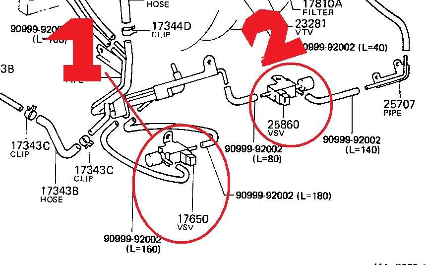

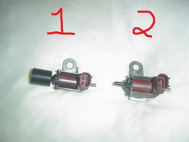

Hi i can't figure out what vsv goes where on my 7mgte since ones missing something from what the tsrm shows and i just can't figure it out... Here just Tell me what Number vsv goes to what number on the vsv tsrm diagram.
The vsv's in the pic you took are the same, one is just missing the filter . Look at the mounting tabs on TRSM compared to where the harness plugs into to tell the difference( both are 17650). Any who the both do the same thing you can mix and match.
