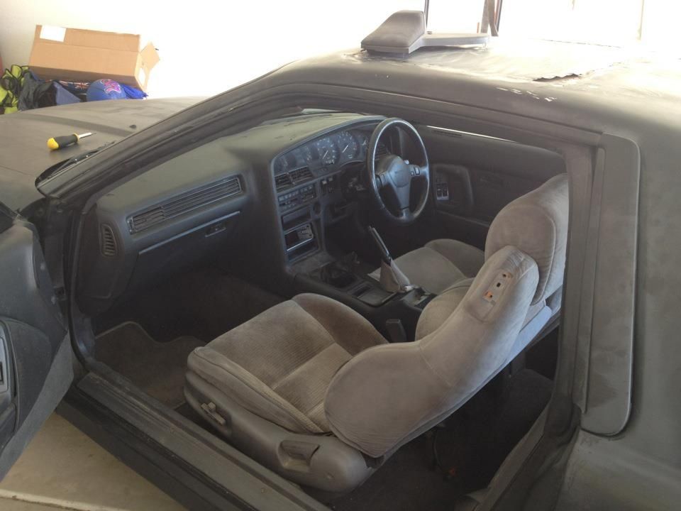

So jealous that you RHD guys can have the JDM digital dash it looks great especially for 80s technology usually the digital dashes back then aren't designed very well
Doat
Feb 6, 2012
2,599
Houston, TX
I wish they made it for LHD too but having a RHD mk3 in the states would be very nice and rare I don't know if there are any RHD MK3s in the states

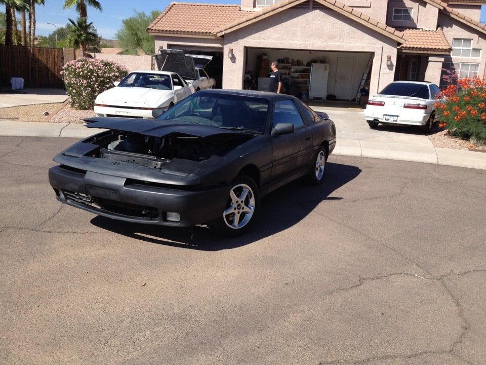

Local guy here owns a rhd mk3
