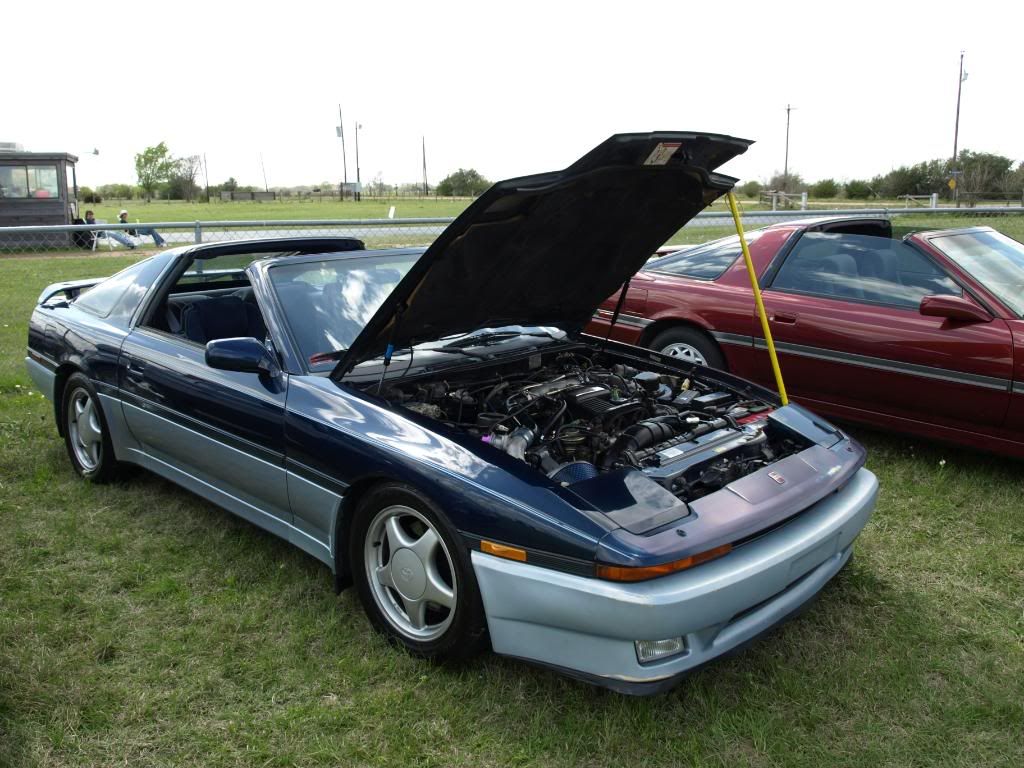

I'm happy with my B&G springs on Tokico Illumina II. Could use some new sway bars and a handful of bushings but it does handle well.
These were taken a couple weeks after the install.
