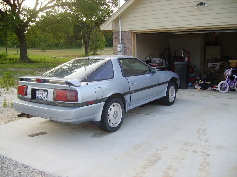

looks really nice.. any rust on that blue car?? wHYYY sell the 89??! lol
No rust, just the front bumper is a little f'ed up.
I sold the 89 to have money to fix the 87 and also I have unsympathetic wife. One of them had to go and I fell for the gay blue one. I have to resurrect it.

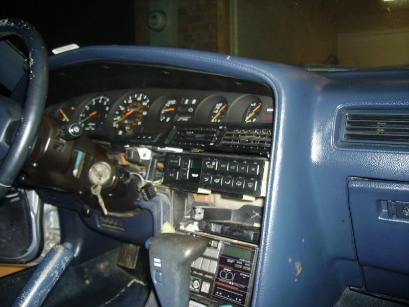

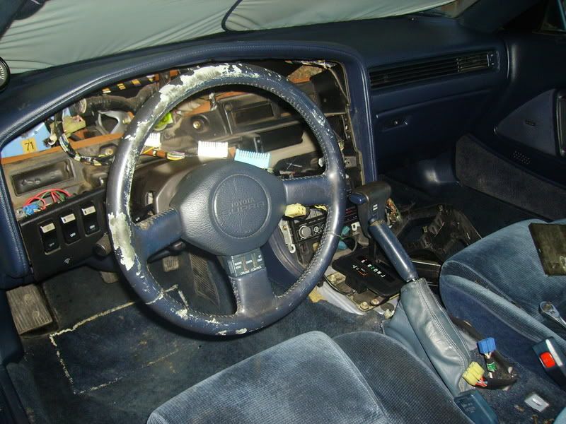

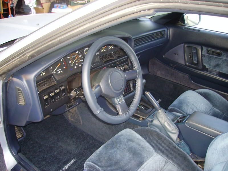

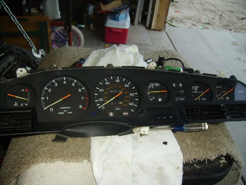

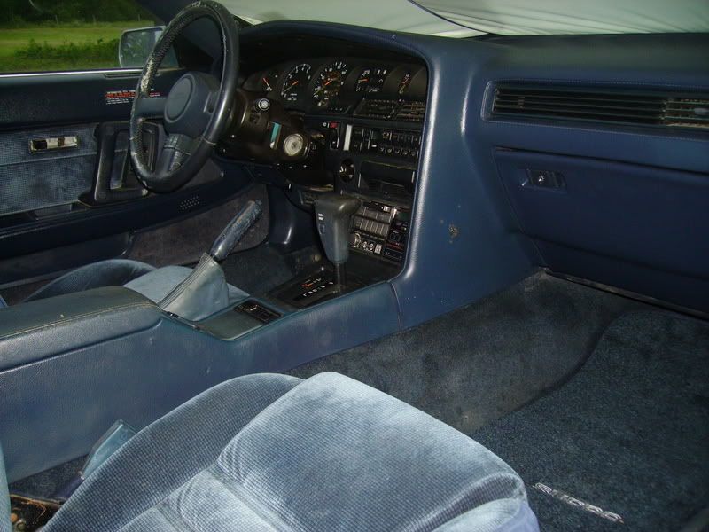

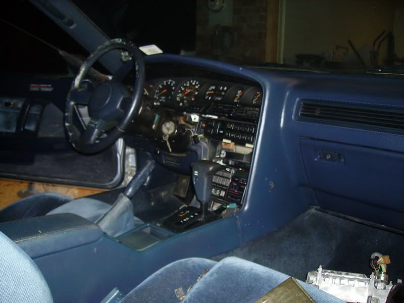

Well some parts I ordered came in yesterday so I did some work today. First I replaced the the little rubber hatch bumpers so maybe one day when I get to drive it, the hatch will not rattle. I also put new bushings on the the gearshift so it longer wobbles back and forth. Then I took out the instrument panel and replaced the lens with one that's not cracked. I also replaced the vents since the originals were no longer fully functional. Replaced the black bezel thing above the instrument cluster since original was cracked in half. I put the new console I got for it in also. I left off the TEMS switch since I probably won't be going with that option. I found out today that the console lids (armrest) for 86.5-88 are different than 89+. I was wanting to attach that cupholder to my 87 lid and it doesn't work, so I will get my 89 lid recovered so I can have the cup holders. Now for some pictures.
Instrument cluster with new lens and vents
Torn apart. Steering wheel looks like shit. I will order some new leather for it soon and sew it on myself.
With new console. Note no TEMS
Partially put back together. I ran out of daylight. Can you spot the other upgrade I did today?

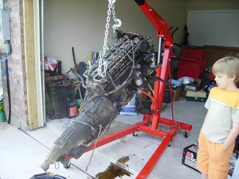

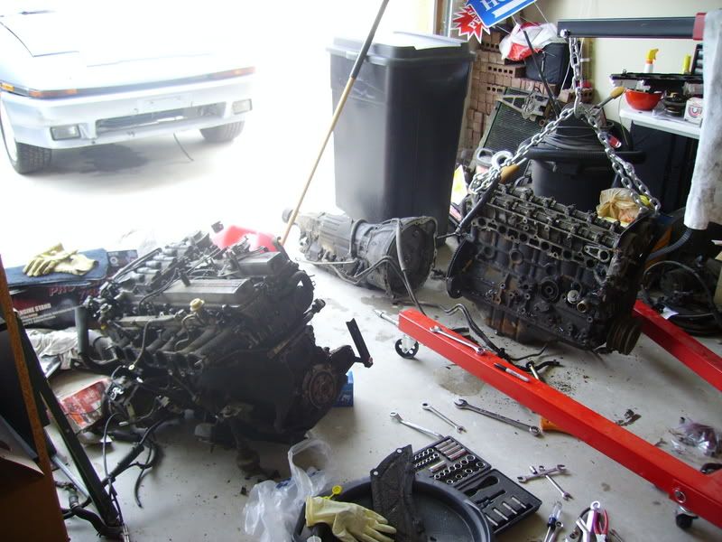

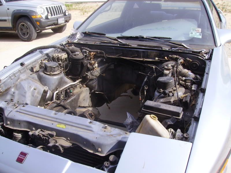

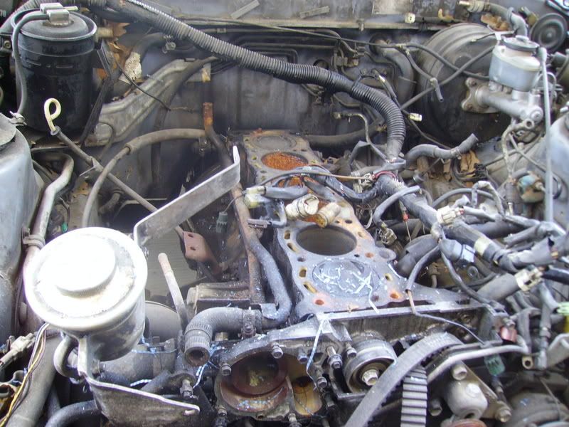

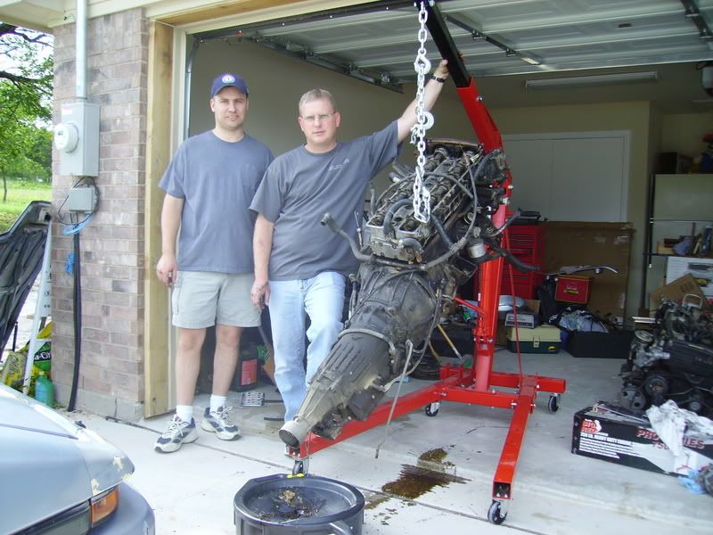

Ok, well I got the engine out today. I didn't remove all the transmission fluid so it looked like a mass murder had taken place under the car. I've got a question though. When taking the auto transmission off, how do you unbolt the torque converter? I'm used to GM vehicles where there's a part of the bellhousing on the underside that you can remove to expose the torque converter. I don't see anything like that on this setup.
The real kicker was that while pushing the car back and forth to loosen the engine up, one of the plugs on the wiring harness got smashed to smithereens under the front tire. Damn the luck. I'm hoping I can fix it with another plug. Here are some pics.
My engine and tranny hanging there. That's my son watching in awe.
Empty engine bay at long last. Now I can start cleaning that up.
My friend and co worker, who knows nothing about cars, proudly standing next to our bleeding "kill". I'm the dork on the right.

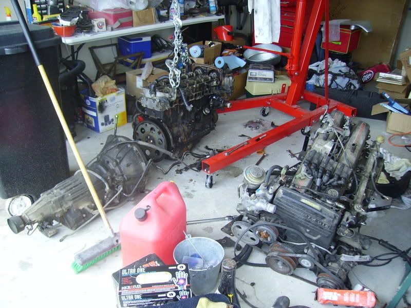

The garage is standing room only for the most part. I do have trails through it. One must leave bread crumbs navigating through it. I did get it all in there though. I lowered the motor all the way down then pulled the lift in over the edge. I then had my friend Dustin start jacking it up again while I lifted the transmission and he pulled back and it was in.
I just finished draining the water/oil/sludge from the pan. It looked like the motor was taking a slow crap for a while. I can't wait to see what it looks like on the inside.:nono:

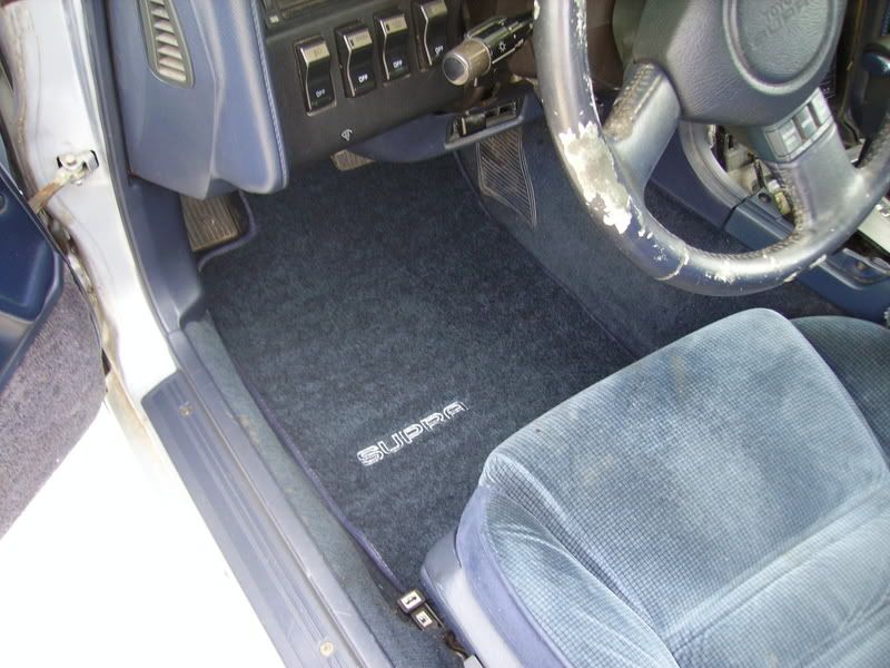

Actually, I have put new floor mats in. I'm waiting on the new leather for the steering wheel, should be here tomorrow. I ordered too big last time and had to send back. It has no motor or transmission but it's gonna look good just sitting there!

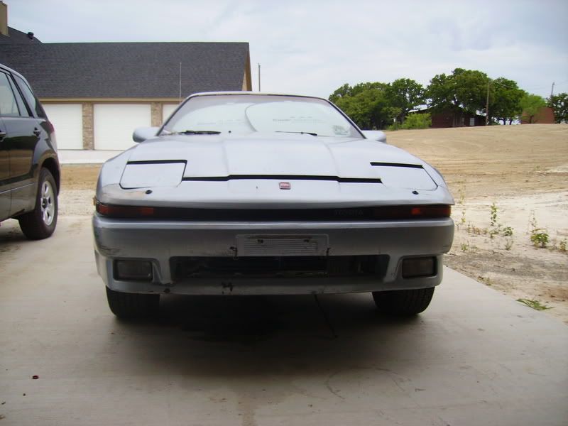

I finally motivated myself to put the dash and console back together. My 89+ ac control looks good. I decided to put the TEMS switch back in until I decide what kind of suspension to put on it.
I took a front view pic of it to show how jacked up my nose piece or header panel, what every you call it is. The bumper was originally bent up pretty back but I straightened that out. I just need to get a lower grill.

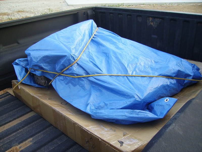

Got the engine loaded up and ready to take to Christian at DFW Supras.
