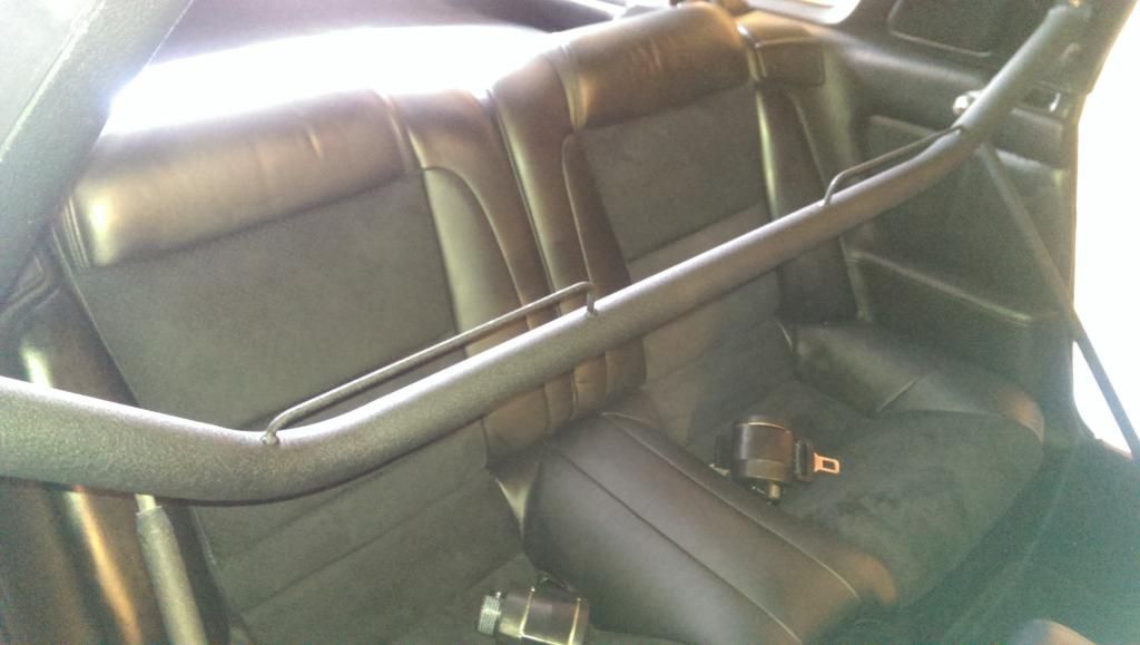

Finally got around installing my TMS Harness bar after having it sitting around the garage for what seems like forever. Do they even make these things anymore???
Had a real bitch of a time installing it too. For the life I me I couldn't get it to squeeze between the B pillars without using a shit-ton of force. Actually tweaked something in the left of my neck pretty bad from over-exertion . lol

DeMoN2318;2014428 said:
^^ Where does this mount?!?!
Bar mounts where the front seat belts anchor to the b pillars. The support rods run to where the front seat belt buckle mounts along the the sides of the floors. The rods were fairly easy to install actually, but that bar was a sonavabitch! If I ever had to do u again I'd use a heavy ass mallet, a thick towel, and a helper. :)

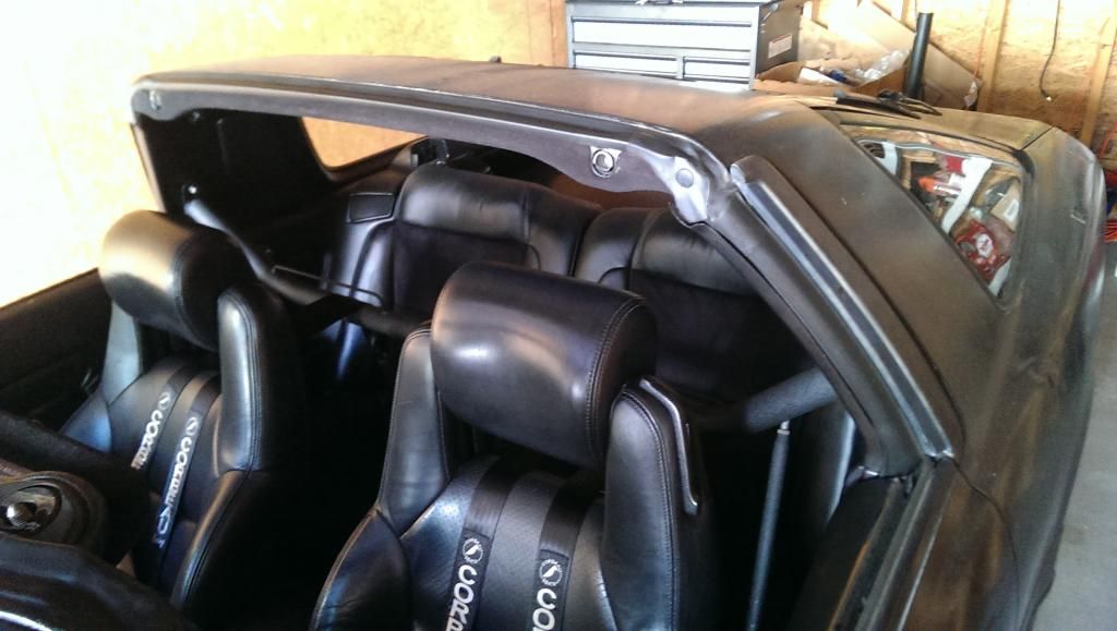

Installing my coilovers tonight I got one side done after like 4 hours lol the passenger side front is the biggest bitch so far you have to move the washer fluid reservoir tank a little bit to get the long control arm bolt out and in. The rear is only a bitch because you have to remove most of the interior panel but I pried the area around the strut back and it worked fine. This is how it looks and it's still on jack stands lol
I just dealt with this today lol, try pushing the long bolt up a couple inches, it will slide over the reservoir so that it will come out far enough to pull the arm
Doat
Feb 6, 2012
2,599
Houston, TX
This would have been helpful a few hours ago lol I just unbolted one bolt that holds the reservoir then pulled it toward me and wiggled the bolt around until it came out.
