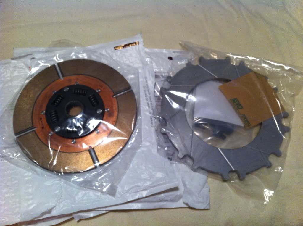

Finally got some clutch parts in direct from land of the rising sun!!!!!

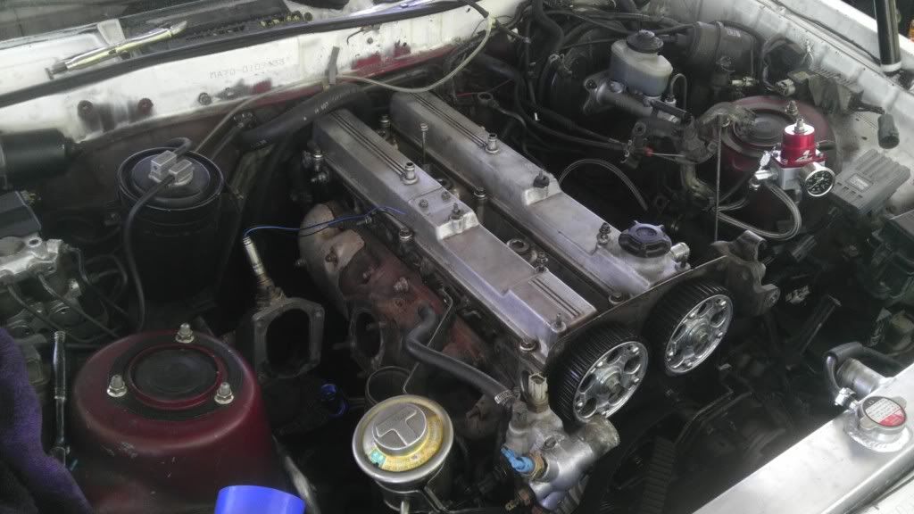

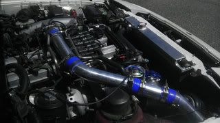

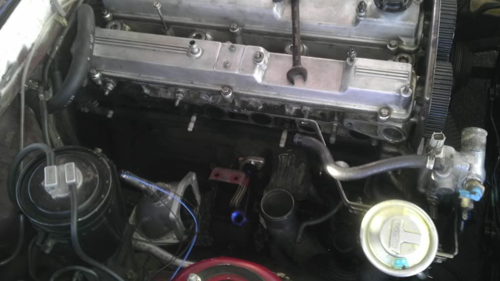

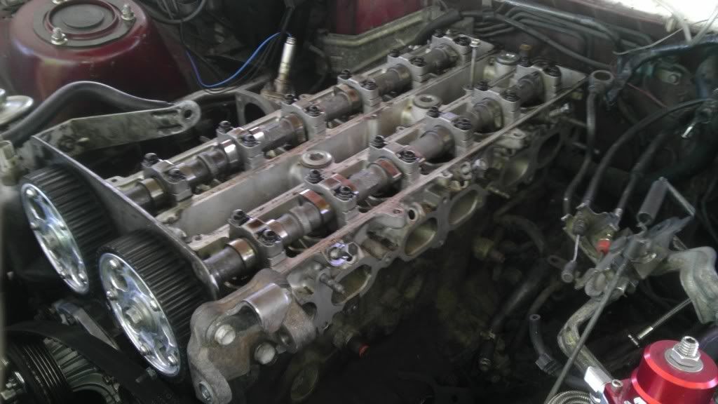

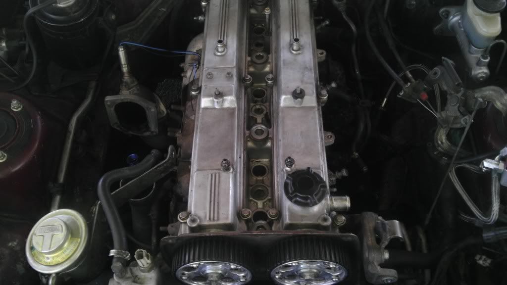

Went from this today
To this
Tomorrow the head comes off and we will see what kind of damage has been done :)
Plan is new harness and head gasket and just general cleaning and up keep.
Also i want to paint the exhaust manifold and valve covers black.

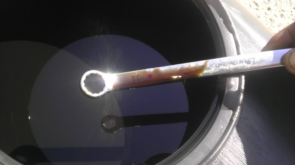

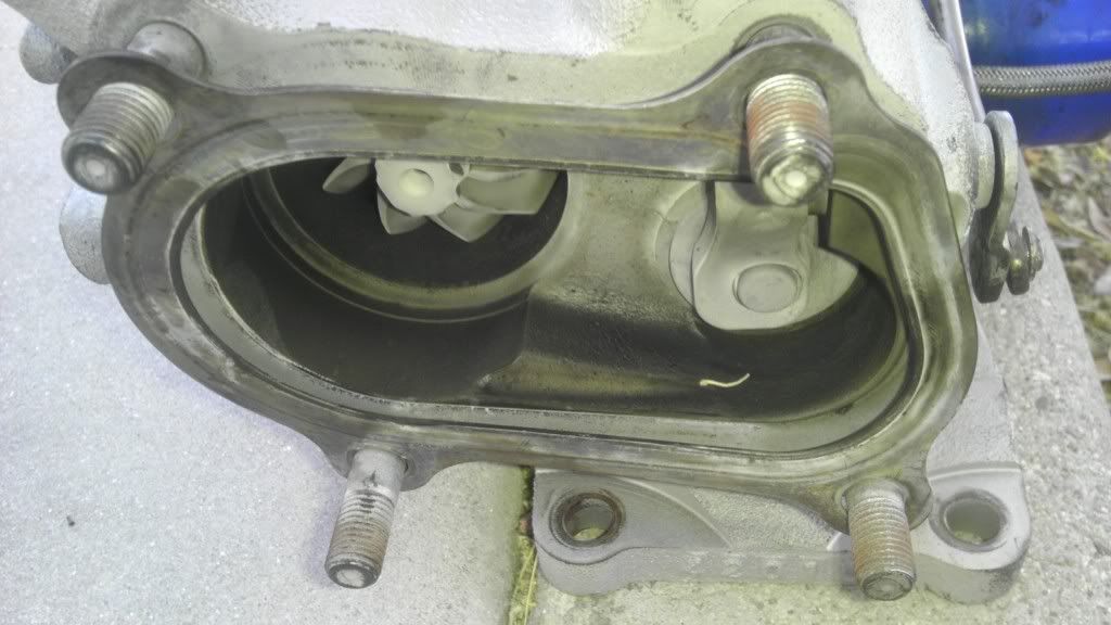

Almost got the head off but then realized i do not have the correct tools to remove the ARP Studs from the block so i have to wait until monday.
Oil seems pretty dirty but no signs of a blown head gasket yet.

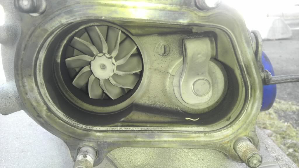

Does anyone else think i was running a little lean by this photo... My AFR's and the puff of black smoke when i got on it say other wise though let me know your thoughts.
6,622
Turbo Habanero;1838913 said:
I think I'm gonna weld it shut and run a external waste gate on the stock exhaust manifold.
I believe that's what Devin did, with good results too. External waste gates are a good investment. Keep in mind though, that this is one of 3 engine things you do NOT want to cheap out on. The other two being the turbo and fuel system.

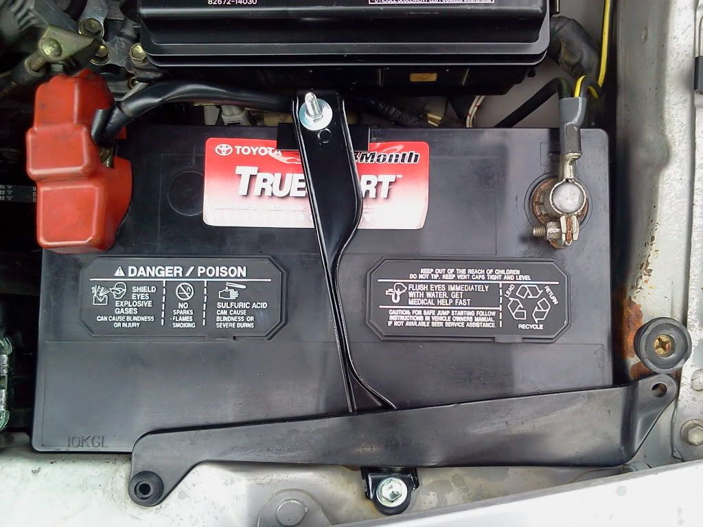

I also replaced my rusty battery tie down with new Toyota one.
