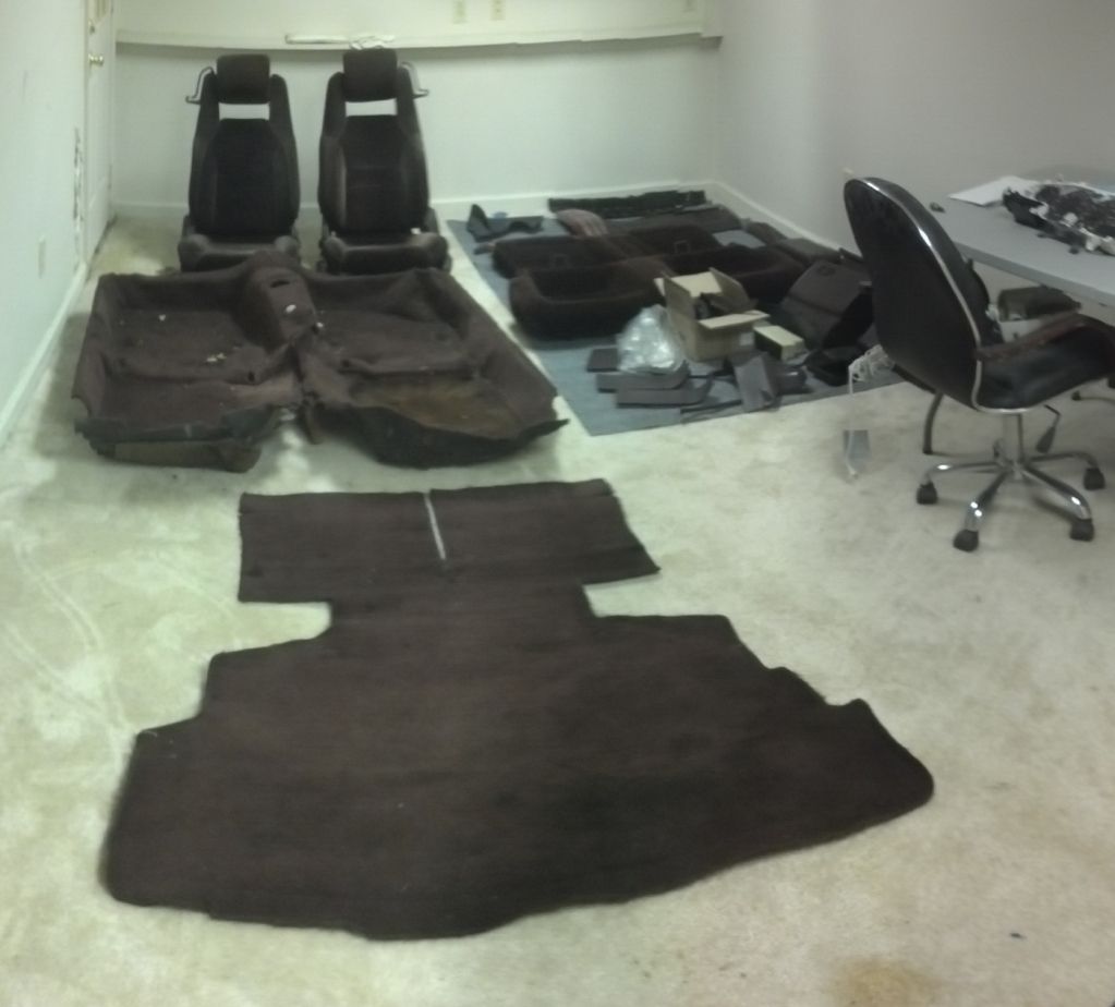

supraguy@aol
Well-Known Member
Dec 30, 2005
4,283
77
Atlanta
Sent my interior to the basement.
