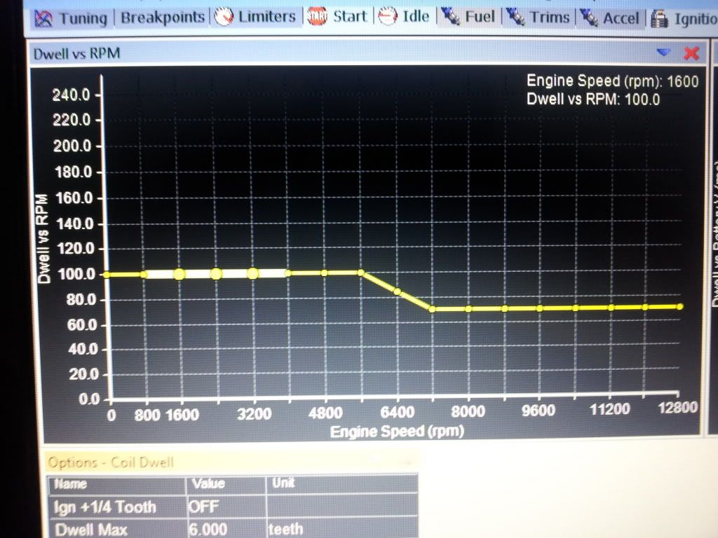

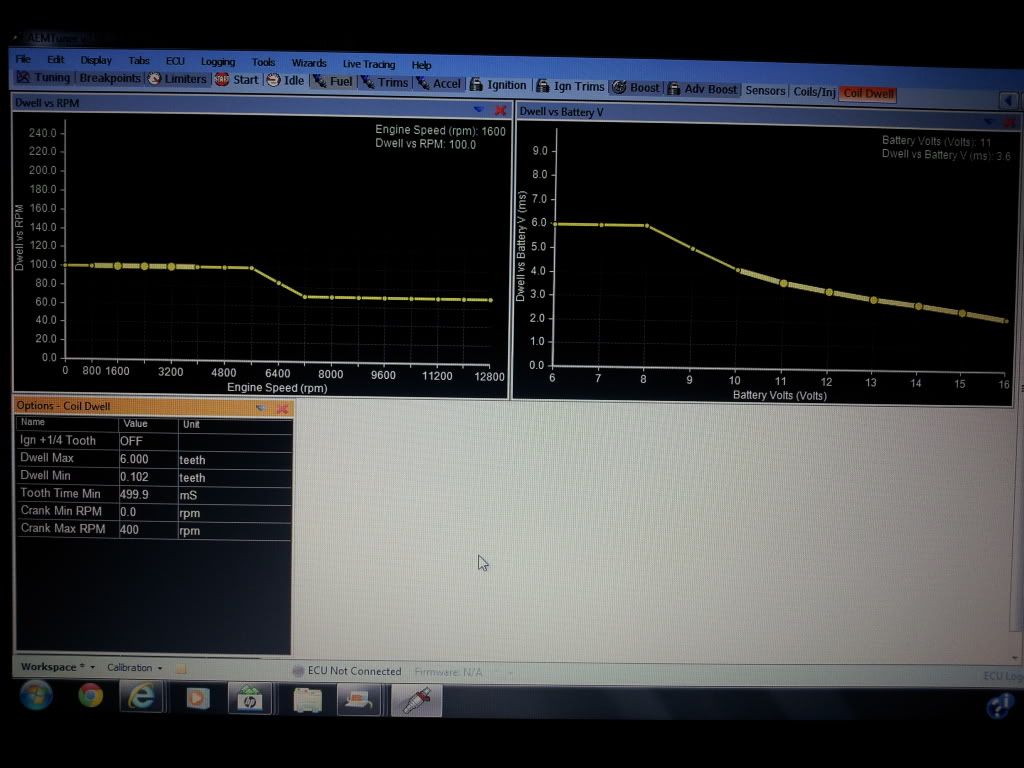

So I have the same issue with the DM 1jz Ecu at the moment and would like to get it fixed and reving freely before I go spend money on dyno time.
anyone else have this problem with the AEMv2 ecu not being able to rev past 5500rpm ?
I see some talk about the Dwell settings mine is also similar to what you mentioned.
was this in fact the problem or was it the harness?

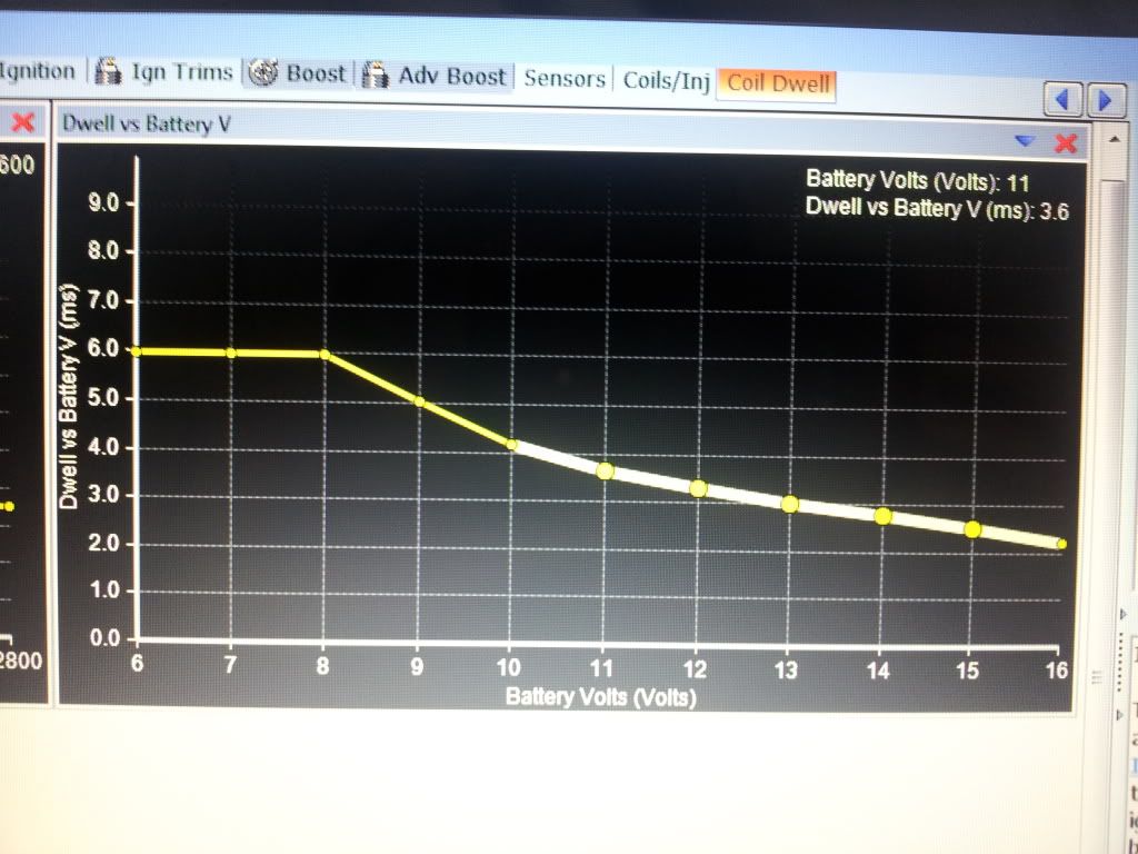

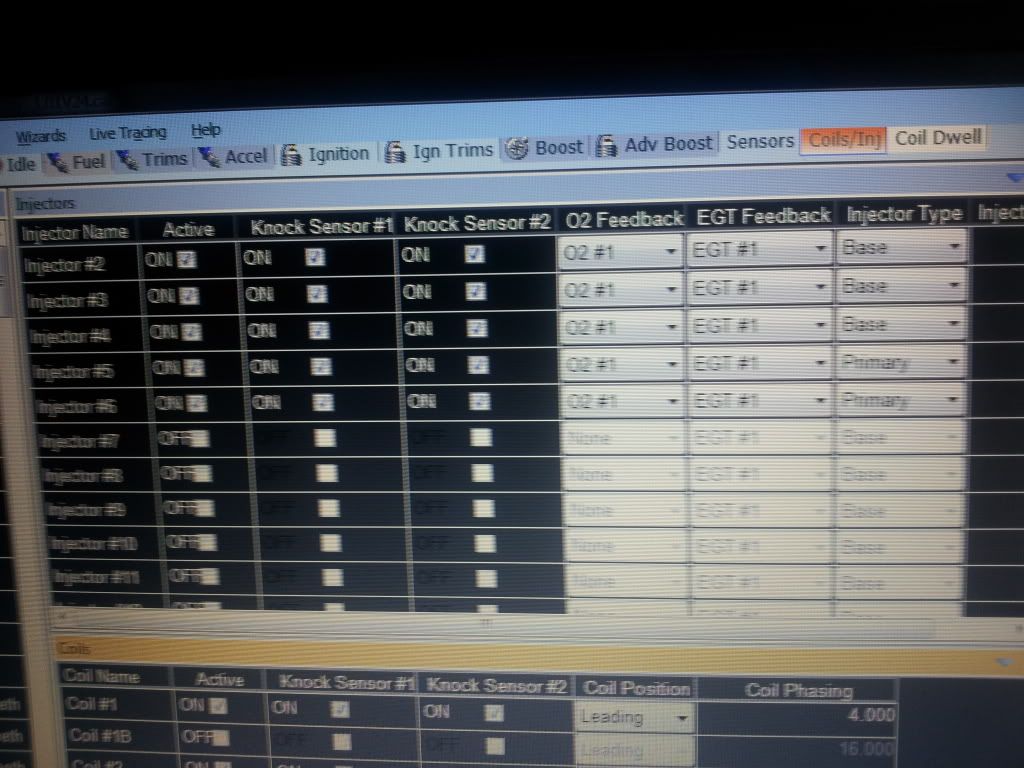

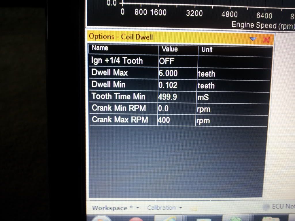

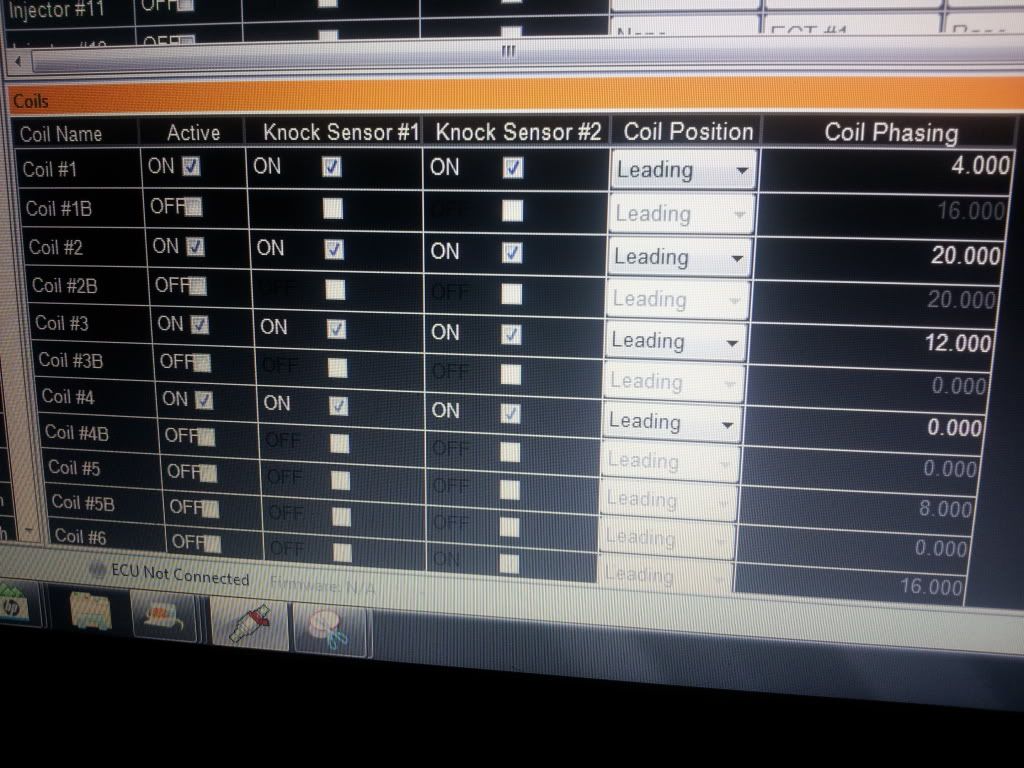

My issue ended up being basemap issue. The triggers/timing sync was off. I cant remember the #'s and my laptop is broken so i cant hookup to it right now... show me your coil/injec screen
Also IIRC the coils like to be at 2.0-2.5ms charge time (2.2 comes to mind) not 100% sure though as i have 1zzfe coils now
