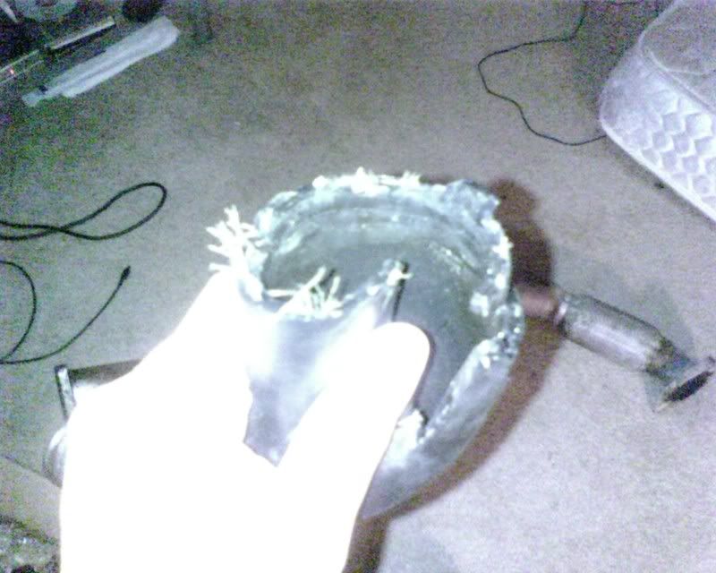

Got the codes out this weekend while my dad was working on the rear end of my Bronco.
22
34
51- Irrelevant, i know why that one is lit.\
So, they pretty much confirm the problem areas I was going to look at to begin with...

Made up the boost leak tester, boost leak tested, and found boost leak :) Popped a big old hole in the turbo-intercooler hose.
At least it wasn't anything too crazy.
Thanks for the help and suggestions.

Update:
As of 8PM last night I'm back in the game. Spent Sunday putting new shocks in waiting for the replacement hoses to get here. They arrived yesterday, put them in, and it's running beautifully now, better than before it broke.
Thanks for the help. It did end up being the turbo-intercooler upper hose- blew a hole in it on the turbo side.
