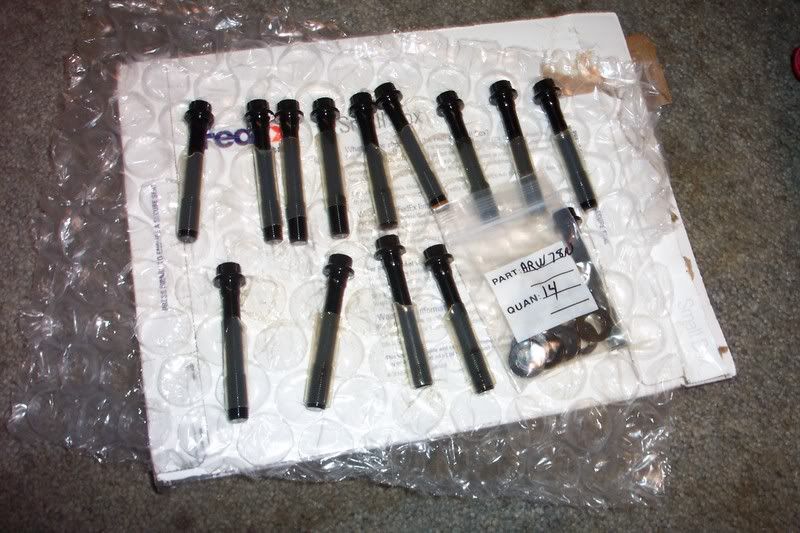

shit i did 77, and it didn't say 85 when i got em....well, time for a retorque...
This is how i got em from HPF...i was disapointed because the other supra i was rebuilding/converting to manual, we ordered the same thing and the came in a box, and had instructions and stuff....
