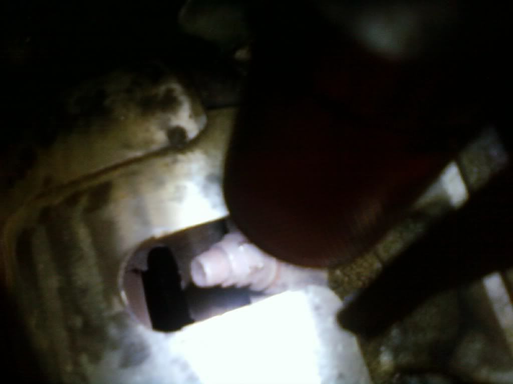

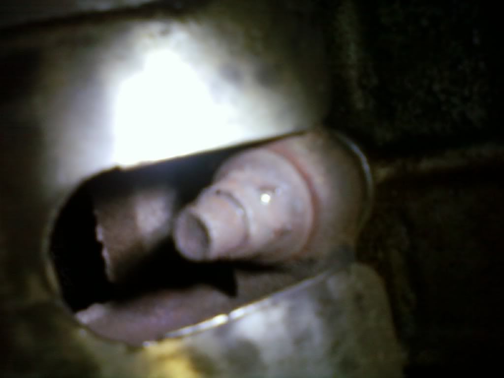

Would the car be running bad if it was the turbo? I noticed these holes in the manifold the other day when i was looking over the car. Could this be the problem?

Checked all the bolts on the manifold and turbo? My supra made that noise, had some loose bolts, so I tightened them but it was too late, blew the gasket out between the turbo and manifold.
I bet that's what it is.

I am starting to think its the gaskets. The nuts on the manifold where it connects to the head have come loose multiple times
