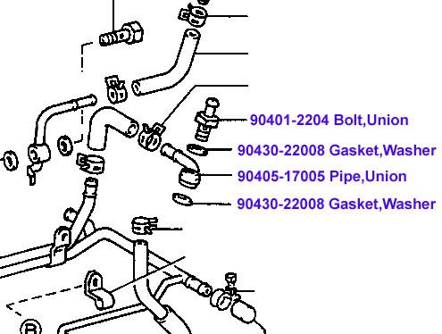

Toyota part #`s below. As you can see you need to order 4 items, the top and bottom gasket/washers have the same part # `s.

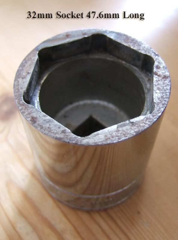

I give mine a liberal coat of Silver antisieze before fitting for this exact reason as they're a bitch to get out when broken!
Tool below was the best way I found to remove the broken piece.

Frank Rizzo;1180268 said:
It's 32mm.
The problem with a standard socket; its too long, I needed to grind down the overall length so the wrench cleared the bulkhead. 32 mm is correct !

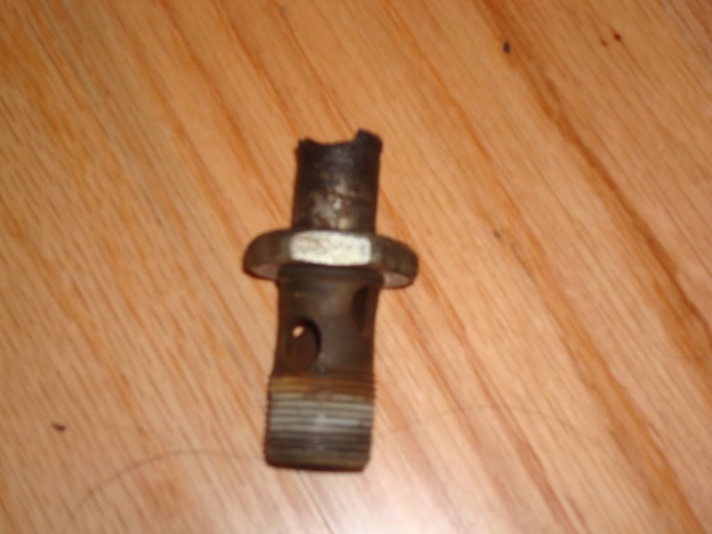

black89t
boost'en down 101
Oct 27, 2007
951
humboldt, ca
here is a pic of one off my spare heads. you can see there are holes in it. if your that worried about snaping it off spray PB from the inside so it get to the threads. the more i look at it that is about the only reason i can see why they put those holes in it.

Those holes are for the banjo fitting that goes there :rofl:
It's the Union in the EPC, and unless yours is badly corroded, you don't need to replace it.
