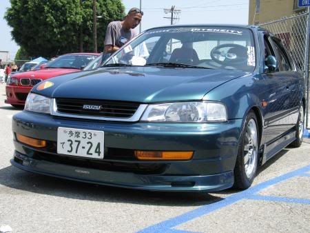

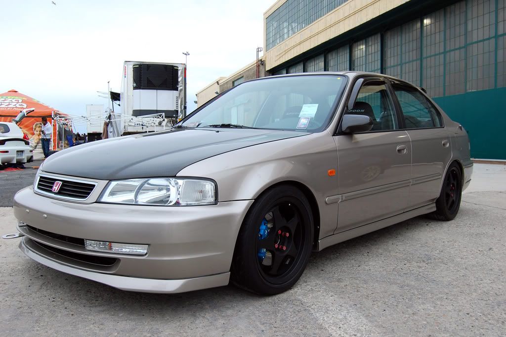

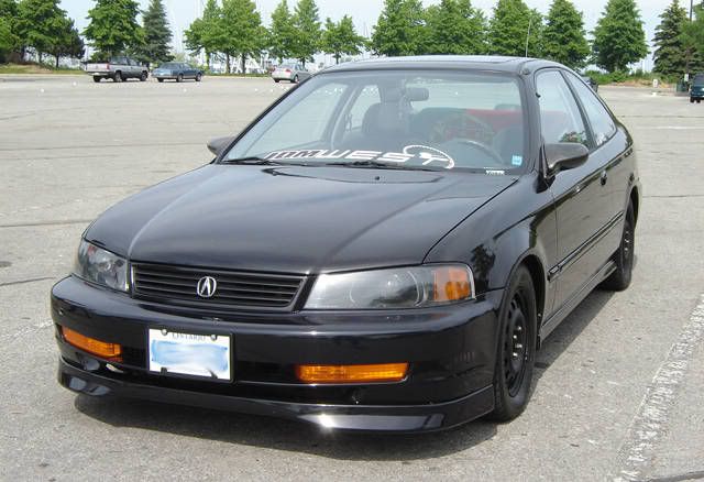

or you can use the Canadian Acura 1.6 EL/Civic Domani/Isuzu Gemini front end...
it's the same as the EK civic front you're using..
