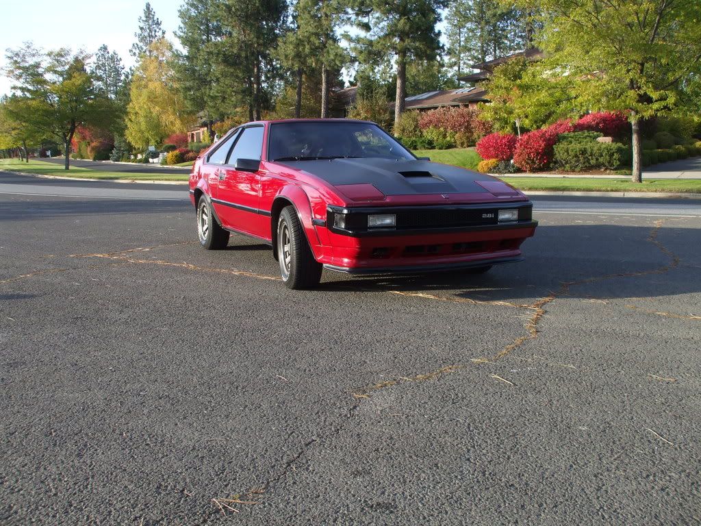

here is what my hood looks like now
and Im considering adding vents similar to the ones in this thread.
Is that like what your talking about.

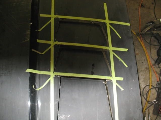

Not as much measuring as it looks,here's a pic with just the basic opening measured out and cuts made.
Measurements: 16 1/2" from back edge of headlight opening.First two vents are 5" front to back(only cut 4 1/2"),third ones are 10" long.
4 1/2" in from the sides,then the "Vents" themselves are 9" wide.
The cuts for the flaps go from 1" at the leading edge to 0 at the rear edge.
I used a piece of angle iron clamped underneath when bending to keep all of the edges even.
It can be done a couple different ways ,this is just how I did it.If you got a spare hood ,give it a shot.
