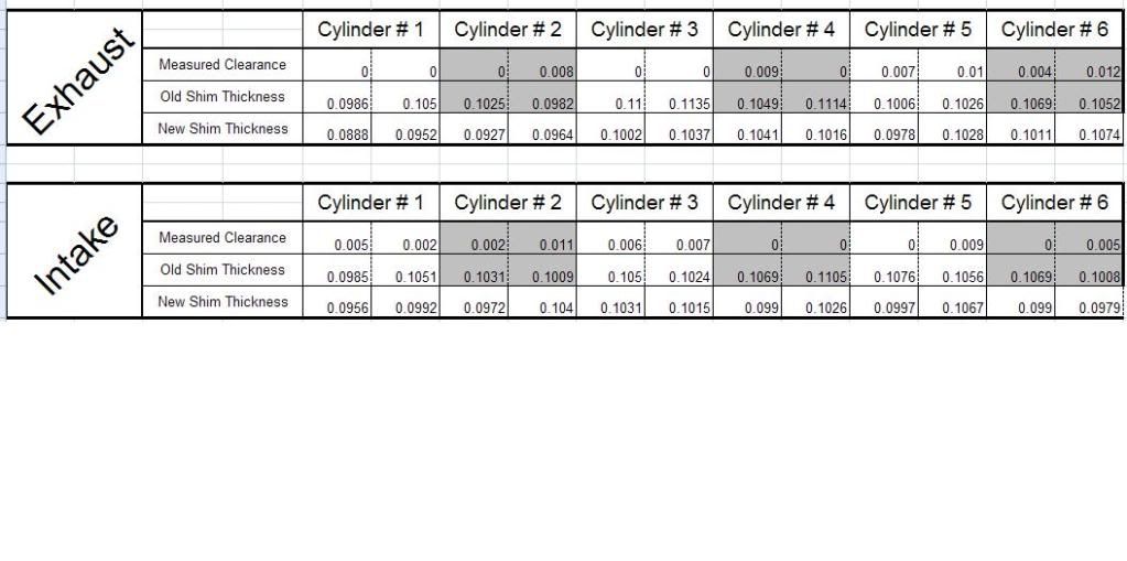

I clamped it down to the block and installed the cams to measure my clearances. I found that several of the valves have no clearance, and most others are too tight, which I imagine is normal after having the valves re ground.
The problem is that A couple of my clearances are at zero (or possibly slightly holding the valve open) and those shims are already the smallest offered replacement shim.
My exhaust 1 and 4 valves are all this way, and my intake number one has this problem.
Here's what my measurements look like:
Has anyone else run into this?

The machine shop screwed up - that is not normal. Take the head back and have them adjust the valve stem length.

yea I will do a baseline check on all my valves before I put the head on this time, should have done that before.
Whats amazing to me is that all my valve lash measurements were out of spec loose before I had it done, and he took off so much that some are now unable to be adjusted out... I checked the valves per the TSRM to see if they had too much cut from them and they check out ok, so he just must have taken a lot of meat out of the seats.
Thanks for your help. :)

when i had my head done i use the second smallest lash caps all around and had the guy grind the tips. its so much easier to get them even this way . because they ony have so many size lash caps. i found the other way you kind of have to settle and cant get them all dead nutz perfect
