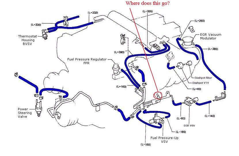

The previous owner had this port blocked off. What should it connect to, and should it be blocked off. EGR has been removed, although I thought that wouldn't affect the fuel pressure vacuum port.

Right, so it runs where the red line is here:
Since I have a aftermarket blow off valve and am venting it to the the atmosphere I can now plug off the port previously described correct? Also since my blow off valve is now located on the intercooler piping that attaches directly to the 3000 pipe I can plug off the port on the accordian hose, and the port on the front of the 3000 pipe.
