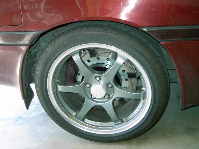

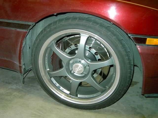

Upgraded front brakes 300 zx calipers.

Like alot of people mentioned before and its been well stated in many BBK threads. The Arz Kit is a superb Kit just like the kit mentioned above.
If you want to a get a decent upgrade this Nightpager Kit isnt a bad deal for the money. Also it lets you buy each item seperate rather than buying it all out in a kit for a grand or so. Which some people can't just fork up right up front.
the Kit cost me:
brackets 280.53 (silverlineracing.com)
350z (Napa United P#880250) Rotors: 85 bucks( when i worked for Napa)
Z32 30mm Calipers (brand new reman): 185 can get cheaper and better deal with friend/ebay
all i need is the shims: lets say 50 bucks
so for 600.53 Total
And the Main reason why i went this way enstead of the Arz kit because down the road, i know i'll be needing a rotor or something and i can just go to napa/autozone/dealer etc be a day out enstead of 5 days.
Plus knowing my luck, that wilwood caliper(not saying it will) be discountiued or some other issue with it and its alot easier to go this route for me. Am i provin a point or making you do this- NO its all your choice but for something better than stock and reduces brake fade like other well reputated(sp) members already proved on the forums- its a pretty good bbk.
