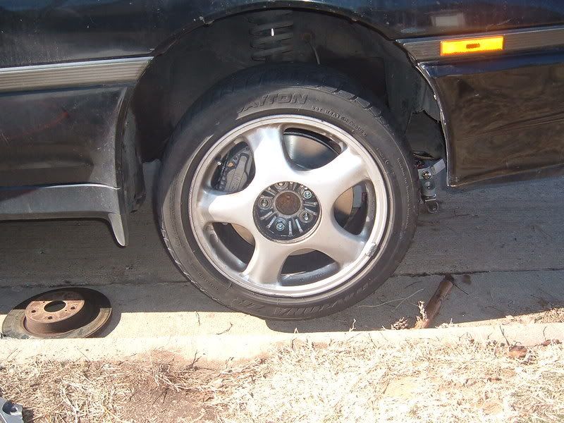

A little Info:
Am just about wrapping up my brake conversion and pretty much got all the parts collected. During the progress, am also taking out my abs system and switching over to Na brake lines and etc.
The only thing i need is somebody willing to make a shim that allows the 350z rotor to fit perfectly. The custom fabrication guy around here is a duchebag and id rather take my business elsewhere. So if anybody is willing to make some shims or get them made that be sweet and wrap up this whole ordeal of the 300zx brake upgrade.
what i got:
an extra hub/rotor assembly from salvage yard
silverlineracing adapter
350z rotor( Napa Part #880250)
300zx 30mm calipers
all i need is a shim.
An idea of what it looks like without shim:
http://i14.photobucket.com/albums/a337/blackgamer16/Night_Pager_kit_Mockup2.jpg
blackgamer16
Supra Driver
Apr 27, 2005
243
Sooner Country
if anybody is willing to make me some shims, i'll be gladly to send over my things and that others can benefit from this swap as well.
obviously that person would have to be a trusted person but gladly will help my fellow members
PS. if anybody can obtain a Supra Vin without ABS that would be Sweet, save me some time in tracking one down.

Got boosted, i got silverline brackets infact i got everything besides the centering rings. I even went thru the trouble to go a local salvage yard and pay for a complete hub/knuckle assembly. If you wanna take up the task, i'll ship it all to you and just hope i get everything back.. .lol jp but i'd be willing to take the risk to get these made and therefore it could benefit other members as well.
I do feel a little bad however that we coping of silverline's brackets( eventho i know he copied em of the original night pager kit) I hope he dont mind.

yep, everything besides the hubcentric rings:
this as far as i got
