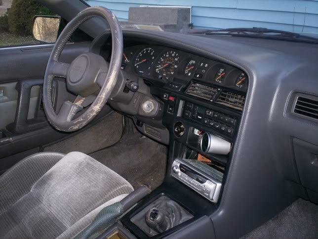

shaeff said:
what's goes on here with that shifter?
shaeff
Kurt is FTMFW x2!!!!
10,592
11
Around
heh, i thought this thread was lost forever. (i'm lazy when it comes to updating)
that shifter is a very, very short SOGI mod. (and it's in reverse) thus far, nobody likes it but me. (and i'll have a different shifter by the time the car is road ready again. (changing the angle of it to be more upright in 2nd, 4th, and reverse. ;))
