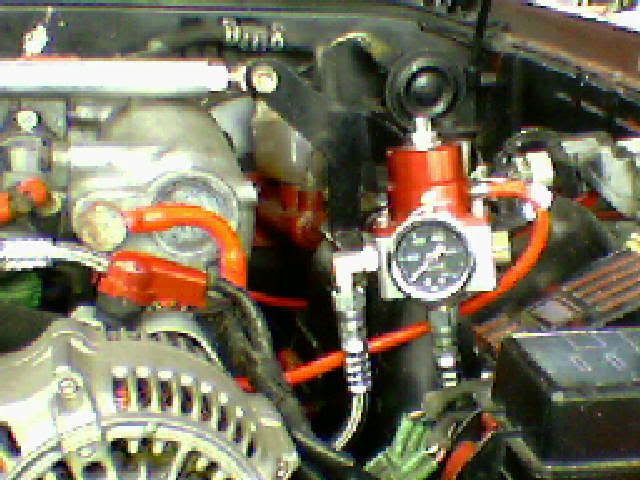

Got the Aeromotive FPR on. Only after connecting it and having the car idle for a minute or two I noticed that the Oil Filter Housing and possibly the braided high pressure turbo oil feed line seem to be leaking pretty bad. Im hoping that I just left em loose and need to tighten em as opposed to there being something messed up. More Pics and Info as i get em....

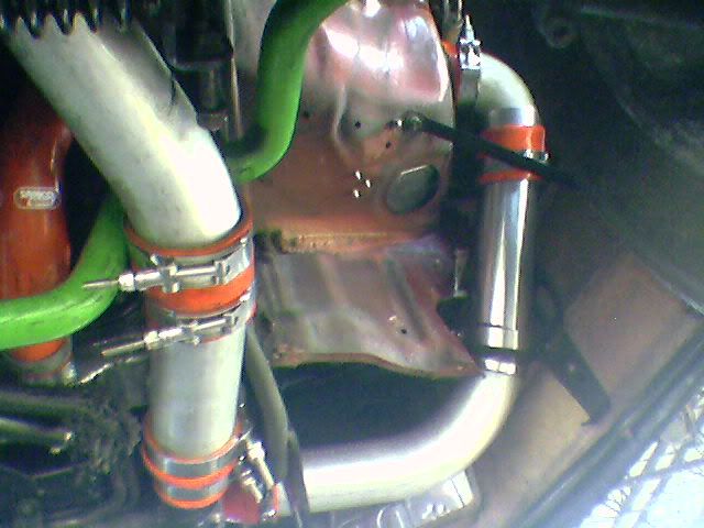

Ok, Intercooler piping is done. The spark plugs need to be cleaned a bit. The motor has an intermittent idle. At times it idles fine, and at other times it seems to miss a bit. Pulled out the spark plug in cylinder 1 and its a black altho it seems the tip is starting to clean itself. Going to wait to have the car drivable to see if the idle improves. I also have a Code 51. Got to hunt down and see whats the cause. Im leaning towards A/C but haven't done any tests to verify this yet. I'll keep you guys posted.
