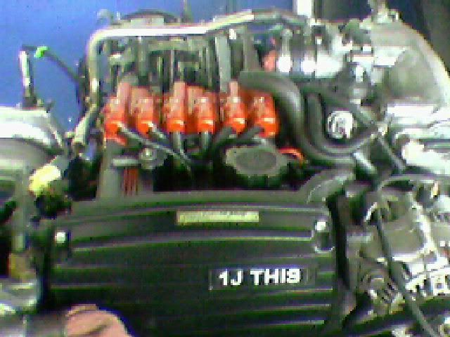

bmoss85;1181127 said:
i love that timing cover. what is the emblem made out of?
as half assed as it has been done, I got on my computer, printed out a paper with a black background and silver 1J THIS lettering, cut out a bit smaller than the actual space that the lerrering would go in, and i put some tough, clear tape ontop of it to fill in the box so it would stay on and look clean. Dont think it'll last the test of time tho. Pretty sure the engine heat will cook the tape right off later on tho. But we'll see.

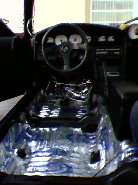

ordered the polyurethane engine torque damper from BIC Performance since i was missing one. Have to change out the freeze plugs on the 7M seeing as i noticed that the one on the back of the block is all blue-ish green so i might as well change all 11 plugs. Still waiting on Samco Engine Hoses. Ordered some Thermotech Heat/Sound Insulation to replace the heavy factory insulation i removed in the passenger compartment.
MA70witBoost
Registered Drifter
Got the Thermotech insulation. Gonna try to lay that down this sunday. See if I can't take some pictures and upload em. Haven't done anything about the freeze plugs because there are 2 that seem odd. I got part numbers for all of them but the two smaller plugs on the top right of the intake side of the cylinder block look strange in the diagram:

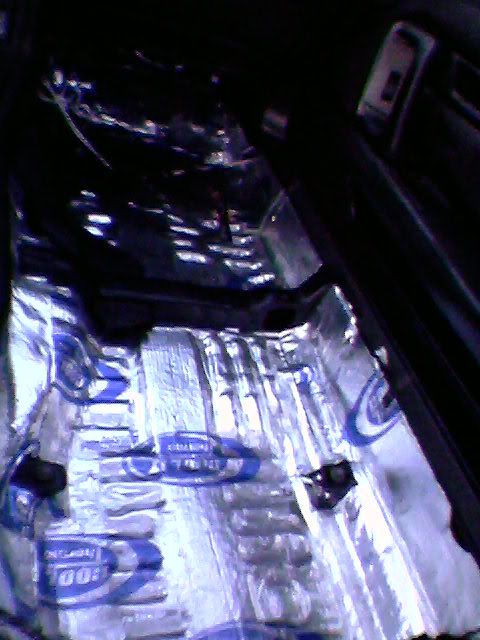

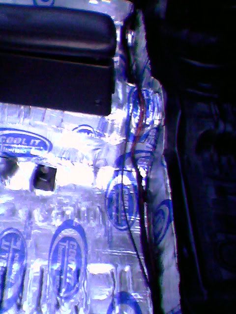

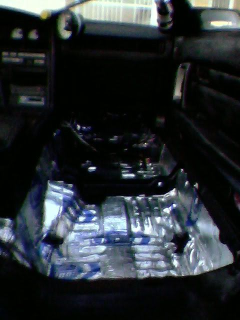

Is that 'Dynamat' type stuff? My buddy puts Dynamat in all his vehicles. Everything from his 300ZX TT to his Minivan! :)
Looks good!
MA70witBoost
Registered Drifter
Looks good!
if dynamat protects from heat aswell as sound then yeah. I had gutted all the factory insulation out. Had also heard that without it, my shoes would probably melt to the floor panel so i figured this would help and quiet down the interior.
