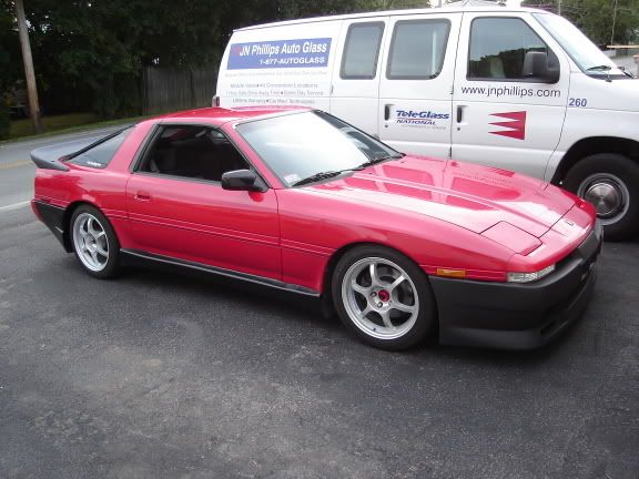

the problem with your car is the result of a poor windsheild replacement.after you take off the moulding's,you will find the rust has extended under the window.the best thing you could do is bring it to a body shop.have an auto glass tech r & r the windsheild.the body shop can repair and lay down some new etch primer.the repaint the pinchwell and a-pillar's.i see this every day and grind rust on old car's.a little pic of my car parked near my work van.

Good looking supra

It doesn't even look "that bad"....I've seen much worse.
Besides, judging by the rear bumper ,I don't think it's suppose to be like that...perhaps, still needs to be painted.
:NINJA EDIT: tsuper, I read over your post 3 times and still don't see what the relation is to your Supra picture. I think you are just trying to show off. ;) It looks good, though.

Meh, it's just a picture of his car, with his work van in the background. Just proving that he replaces glass for a living.
You're right. He is a showoff. lol
