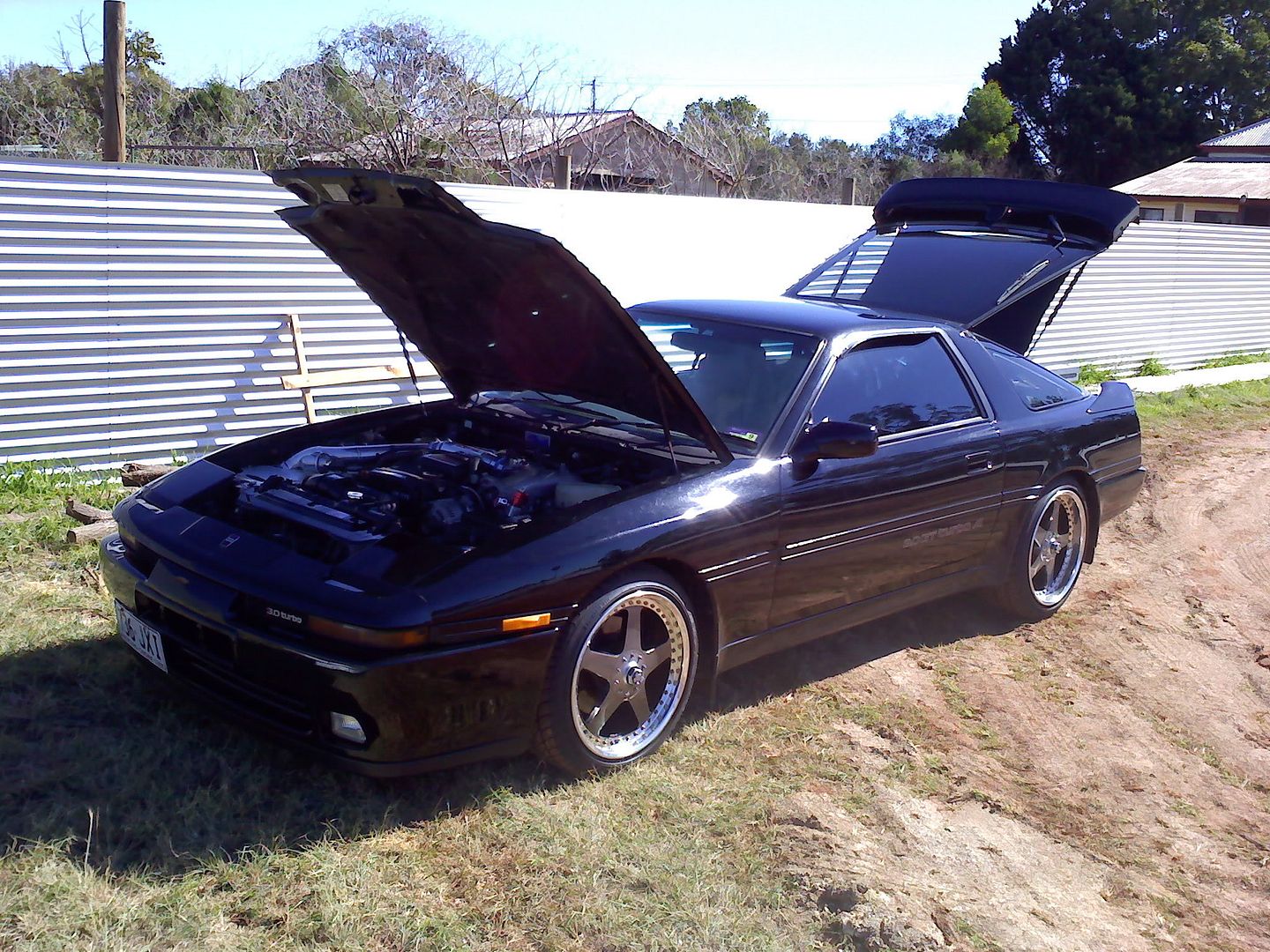

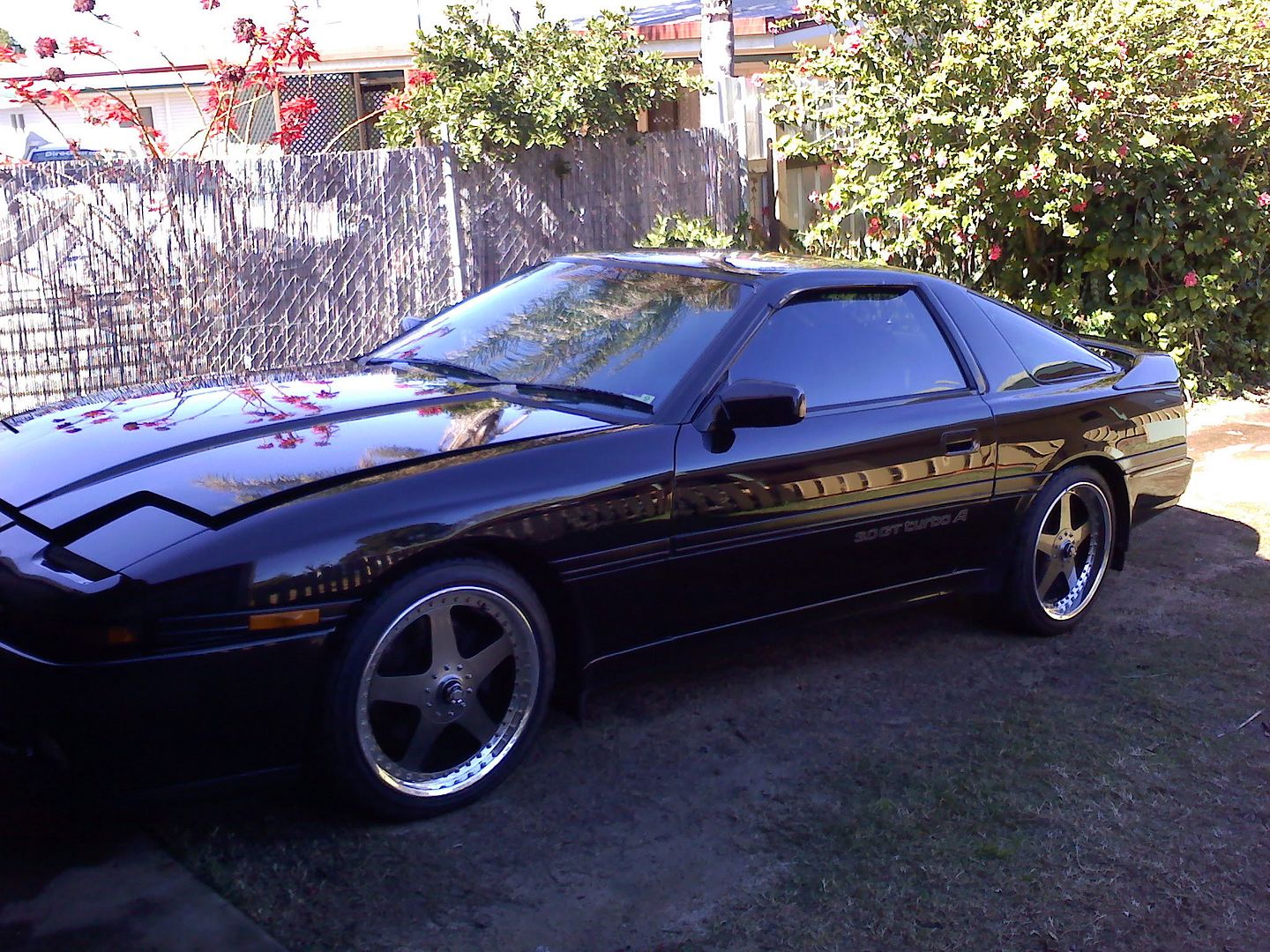

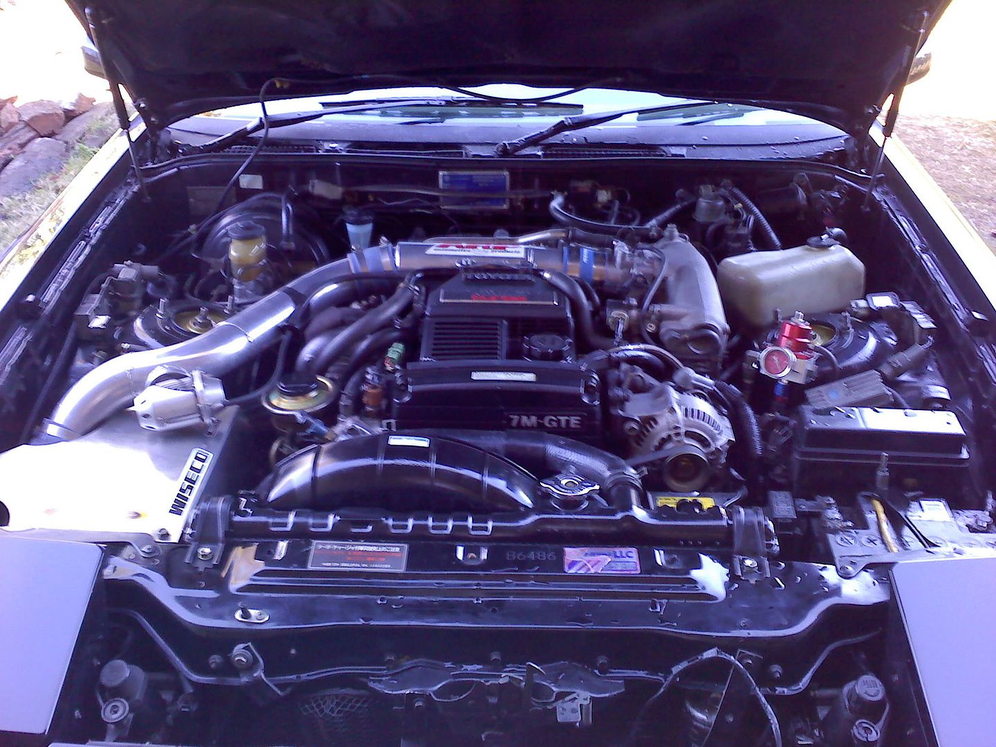

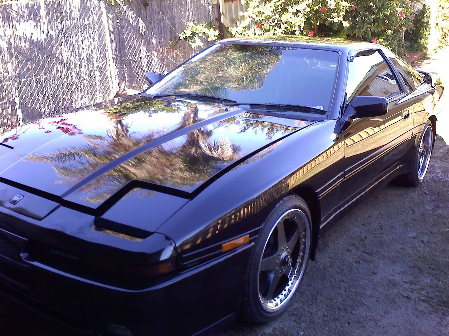

Ok some good news, the clutch is fine now. I had to make a custom clutch slave rod which is 15mm longer to fully disengage the clutch, for some reason the clutch kit i had built for me has a long way to travel unlike the stocker but thats all sorted now.
The car has had the stinger 6860 removed in favour of the factory map based ecu, due to the installer doing such a crap job i got sick of finding dodgy wiring and just pulled the whole lot.
Down the track when i have some time ill build a new loom for it and reinstall and upgrade the turbo at the same time, although that may be some time yet.
The car runs great now but i have 550 injectors in it so it's very rich, i'll buy some 440cc injectors this week if i can and refit the factory size.
enough talk heres pics.

Maybe, instead of going back to 440s, wire in an S-AFC for now and keep the 550s

I have thought about a safc but at idle or cruise my A/F's are 10.0-10.3 and doesn't the safc only tune WOT? If it will tune at cruise as well i know someone that can help me out with one, i really don't know much about them.:1zhelp:

You can use the S-AFC to bring the entire fuel curve up and down
It also has 2 different fuel maps which you can set at what throttle position each fuel map is effective at and it interpolates between the 2. This lets you have the mixture right for WOT and then use the other map for tuning cruise too. Think of it as an electronic version of the Lex AFM mod for regular 7Ms.

Yeah? that worked quite well the HKS reg, just didn't have a fuel pressure gauge from memory, just needs an inline one added and bingo. I like the fact it looks almost stock and fits in the stock location.
