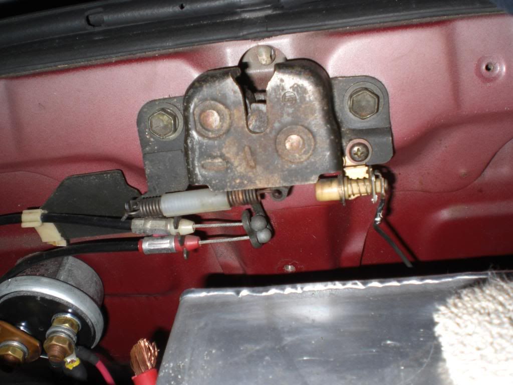

My question is how are the lines supposed to be attached?
From this picture : http://www.cygnusx1.net/Supra/Library/EPC/291220/catalog.aspx?F=6709&P=1
It looks like they both come in on the one side but I don't see how there would be enough slack to do that.
If anyone has their hatch taken apart and could take a pic of how its supposed to go that would be ideal, but I'd even settle for a mspaint portrait :p.
Thanks in advance.

Looks like cable just attaches under the other one. I replaced mine on the MK3 but I can't remember how it is assembled, which wouldn't be a problem since you have a pic, but it looks different, lol.
Anyays, hook it up and try it out.
fool'ssupra
Building It
Sep 14, 2008
75
Maryland
I just put my rear hatch area back together, but I can tell you that both cables come into the right side of the latch assembly, one under the other. The bracket in the lower left of your picture that the one cable goes into is also where you clip the second (loose) cable. Your one cable may not be routed correctly if it's that tight.

it does come from the other side, but I can't remember how it runs. They also should clip into that white clip to keep the wire from moving while it should be stretching. One of your clips is broken, and could cause a problem. I'll search my pictures to see if I have one later. Gotta get ready to go visit the folks now.

The cable runs along the bottom of the cargo area on the left hand side, pretty much following the bottom of the trim. It's bundled with the wire harness. As ForcedTorque said, there's a small plastic clip that the cable snaps into.

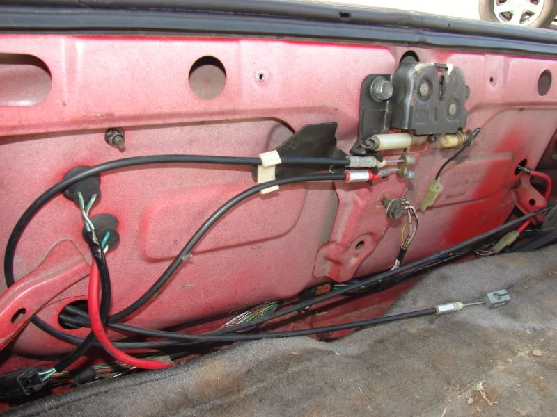

Let me know if that helps. I can get some more if needed.

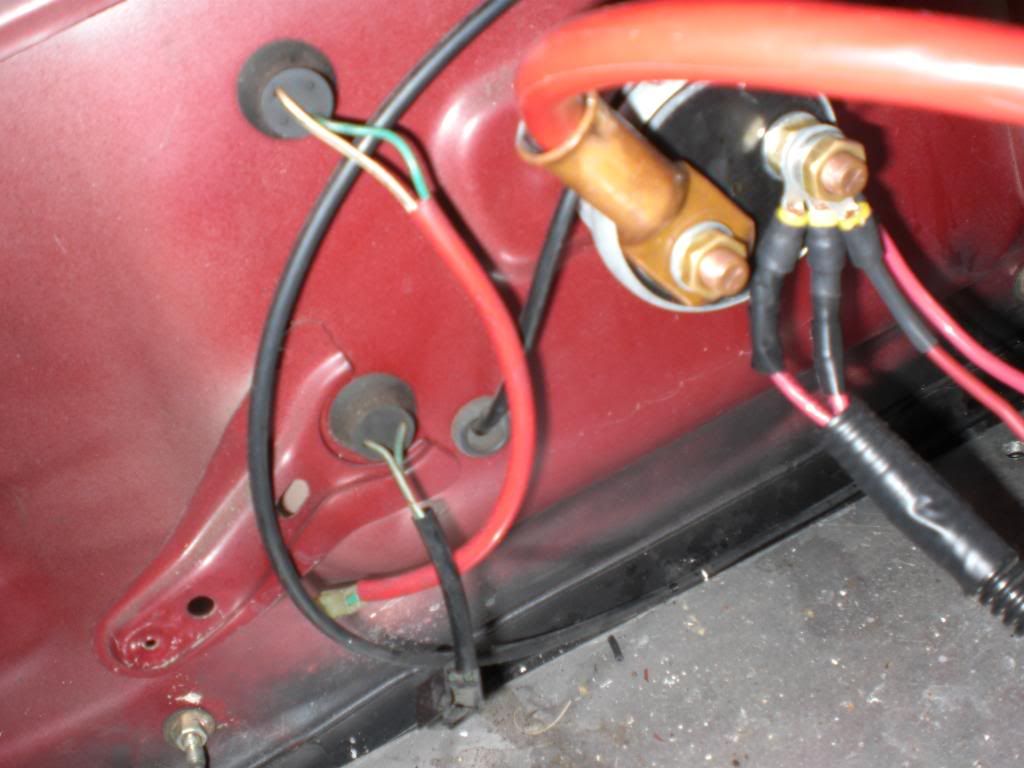

although I gotta say mine looks different and I have this other cable that I dont know what its use is,
I attached a pic,
also, my trunk release cable was snaked through a hole on the left said that looks like it was made to be there so I cant see how it would be possible to run it alone the right side and still have enough to slack

remove the metal piece at the end and hook it up. or maybe your cable is backwards cuz the first pic didnt have that metal piece.
Gargoyle
Mar 13, 2006
159
Portland, Oregon
If I remember correctly, the cable that goes to the center light section is for your key release. The metal piece actually holds one of the cables. I can't get a picture for you but the difference may have to do with model years in the photo's, as the 1988 and older have the key lock in a different location and I don't know what year the pictured red car is.
The first picture you posted with the cable coming from the right side of the picture, goes in the metal end of the last picture you posted but for the life of me, from looking at the pics, I can't remember how both of them work the hatch release pulling form seperate sides.

The red car was made in November of 87 but is tagged 1988. Are those the cables that came with the car? Did the LHD jdm cars have a different cable? maybe thats why its seems too short. mine have plenty of slack

My car is an 89. As you can see in this picture, there are two cables coming through from that tail panel. One is normal, and it goes to the lower position. The second is your weird cable. On my car it is left unused, and I guess could be used to do something else from the hatch key if desired. The upper position is the one coming from the interior hatch release, and as has been said, runs along the bottom edge just under the side panel. You should fish around in there to see if you can find that cable.
