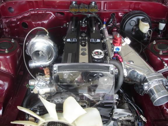

There is a wiring harness that runs from the driver's foot well through the fender and out near the fuse block in the engine bay. You will need to remove the plastic inner fender and the kick panel from the drivers side, but it is the cleanest way to route wires. My 1 gauge from the battery relocation follows this path.

^^^^ awesome engine, and yea I have a 90 auto it has a small rubber hole in the driver side near the brake booster, I used it to run my venom 400, and my gauges still some room for additional hose or wires to be ran. already drilled just gotta punch out the rubber plug. :)
