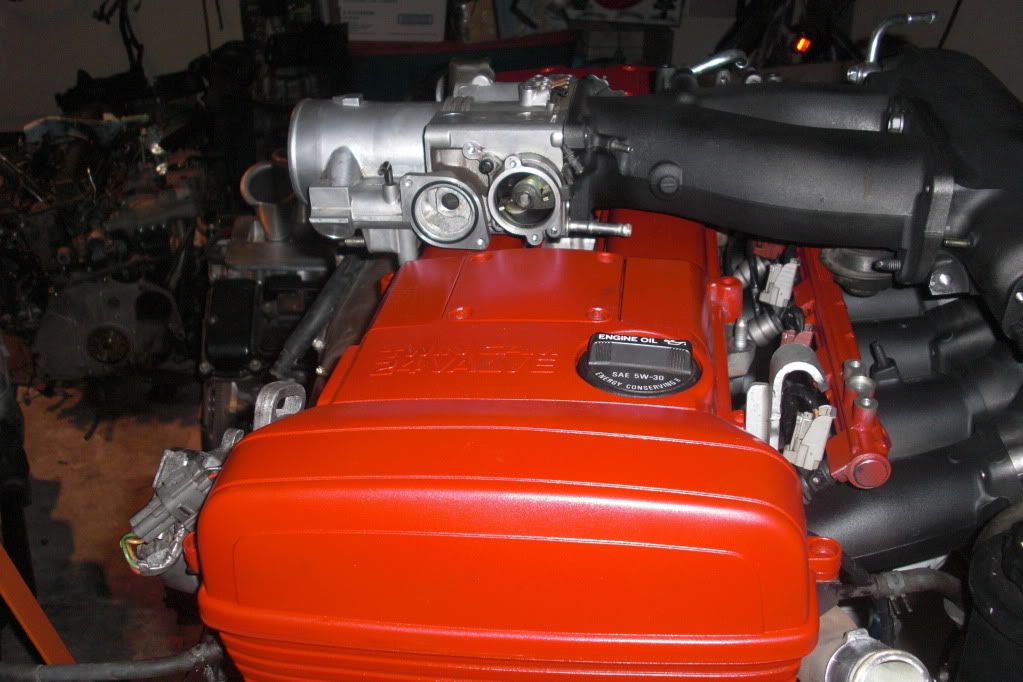

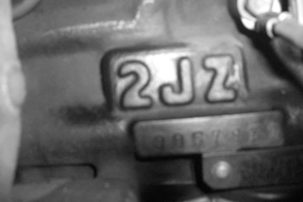

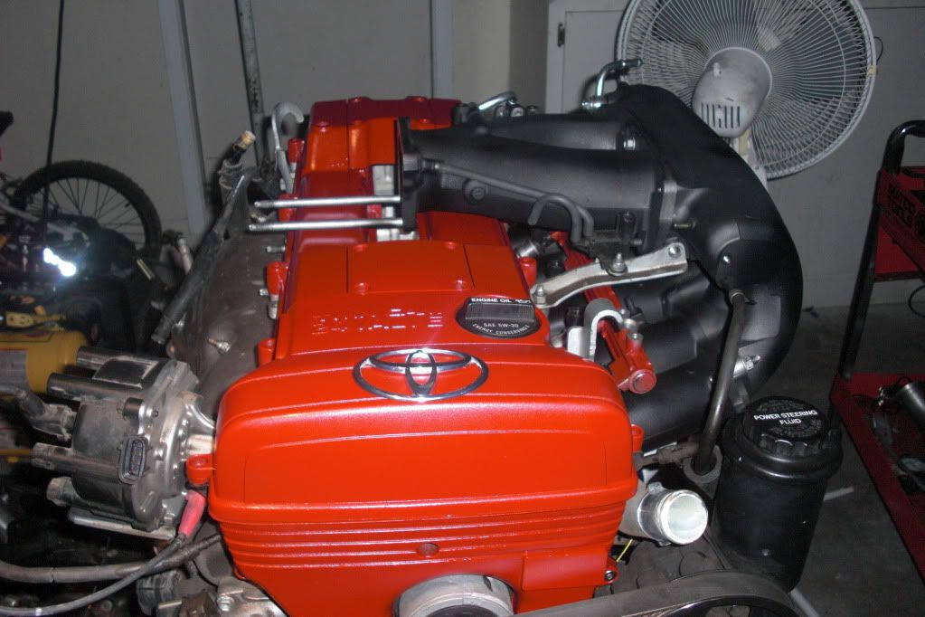

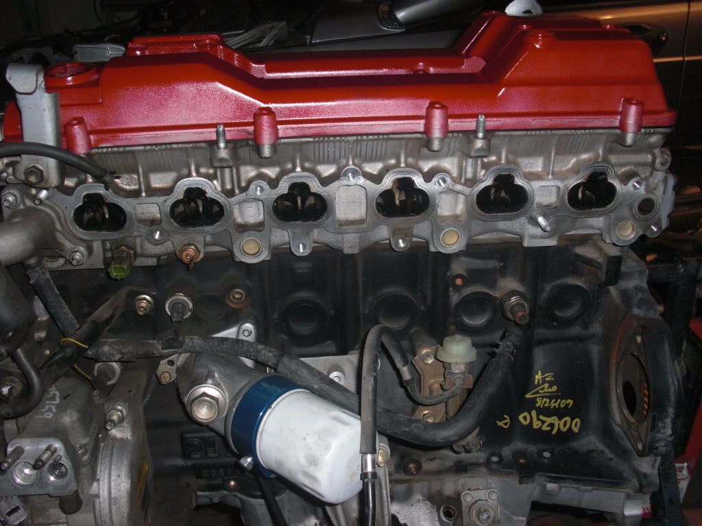

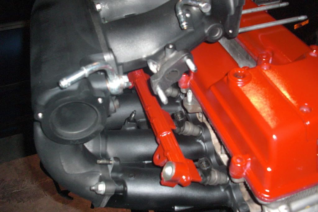

Well i would post pics of the 2j when i got it, but i couldn't find my camera. we all know what a post stock 2j looks like anyway right? here are a couple of pics of it now mocked up after a little paint. the toyota symbol is not attached just sitting there. wanted to see how it would look over the lexus one:

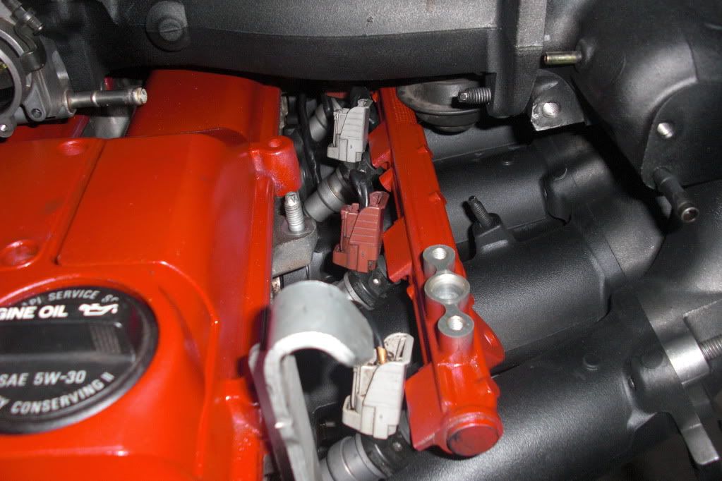

peek da fuel rail yo: haha

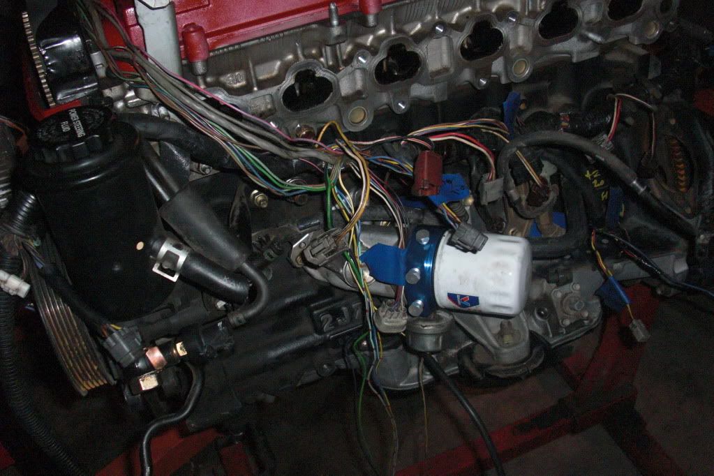

started to mildy tear down the motor so that i could route my harness to see what i had to shorten and extend.

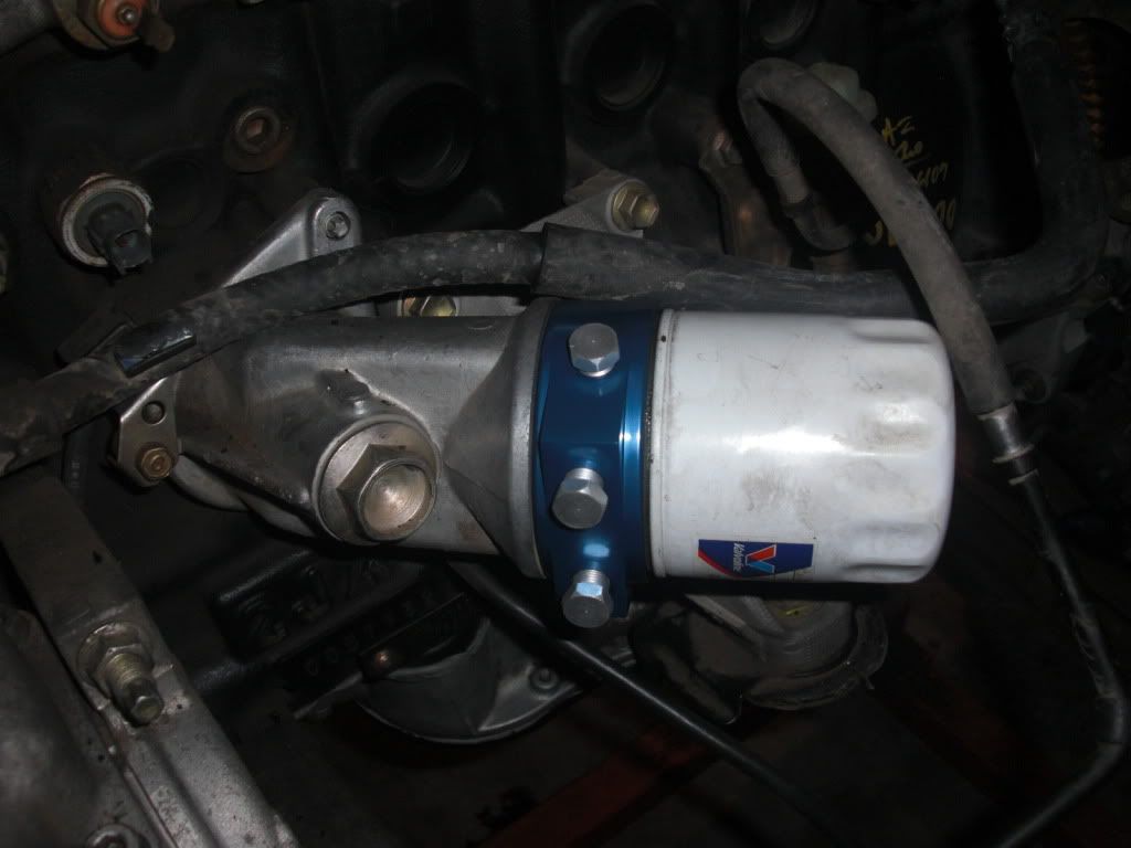

My new oil sandwich plate. need this baby to cool/feed my turbo!

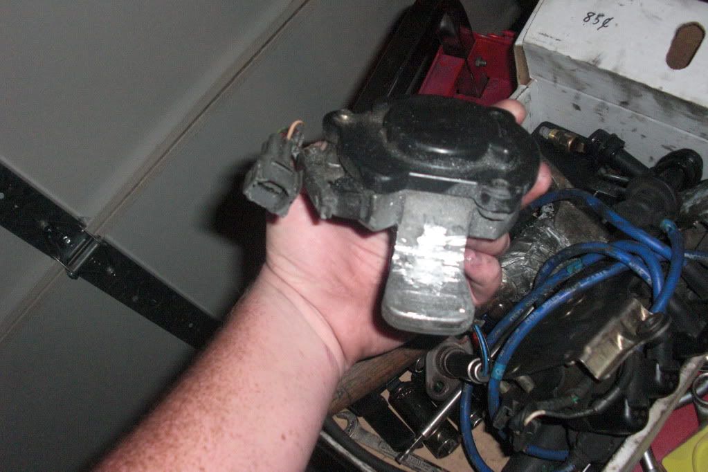

started to modify my cps. (don't worry, will be cleaned up!)
My first sensor transfer! woo hoo! only a few more to go!

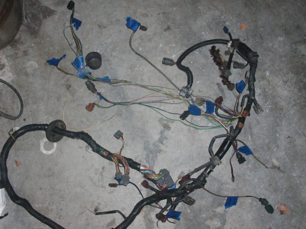

My current harness. i labeled everything so i woudn't forget once i started to cut wires and go nuts
And how im going to keep my harness clean! lots of heat shrink!!

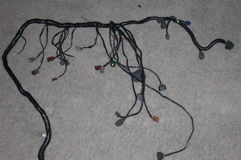

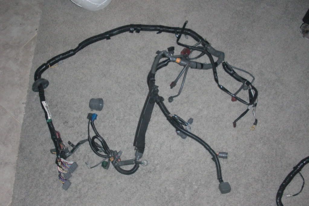

So yes, more progress today! Just got my wiring harness done. wow what a pain in the ass!! tore it all the way down, past the loop, fixed any bad connectors, lenthened and shortened all necessary connectors. needless to say, alot of cuttin and soldering! This is a pic of it from a couple hours ago...
here is a pic of the stock harness:
and after a few hours it turned into a 2j harness!

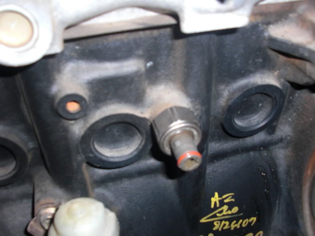

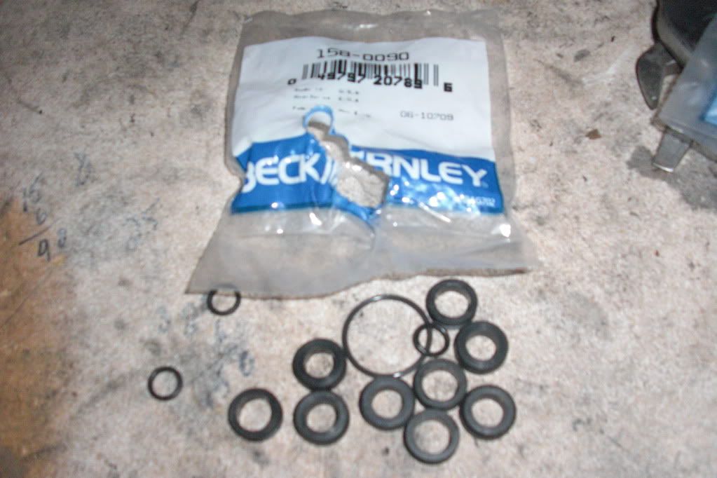

Also just got in my all new o-rings for all the injectors in.
The old crusty ones:
Injectors installed:

Ok so i installed the harness to see how it would mock up. i do have to say that it doesn't look to shabby!! you can hardly tell there is a harness there. I do still have to hook up the iac and tps but those will be later once i get a new throttle body.

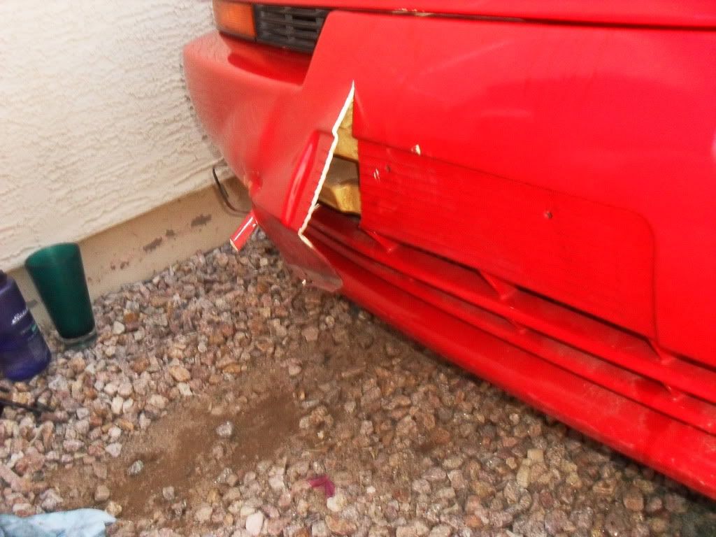

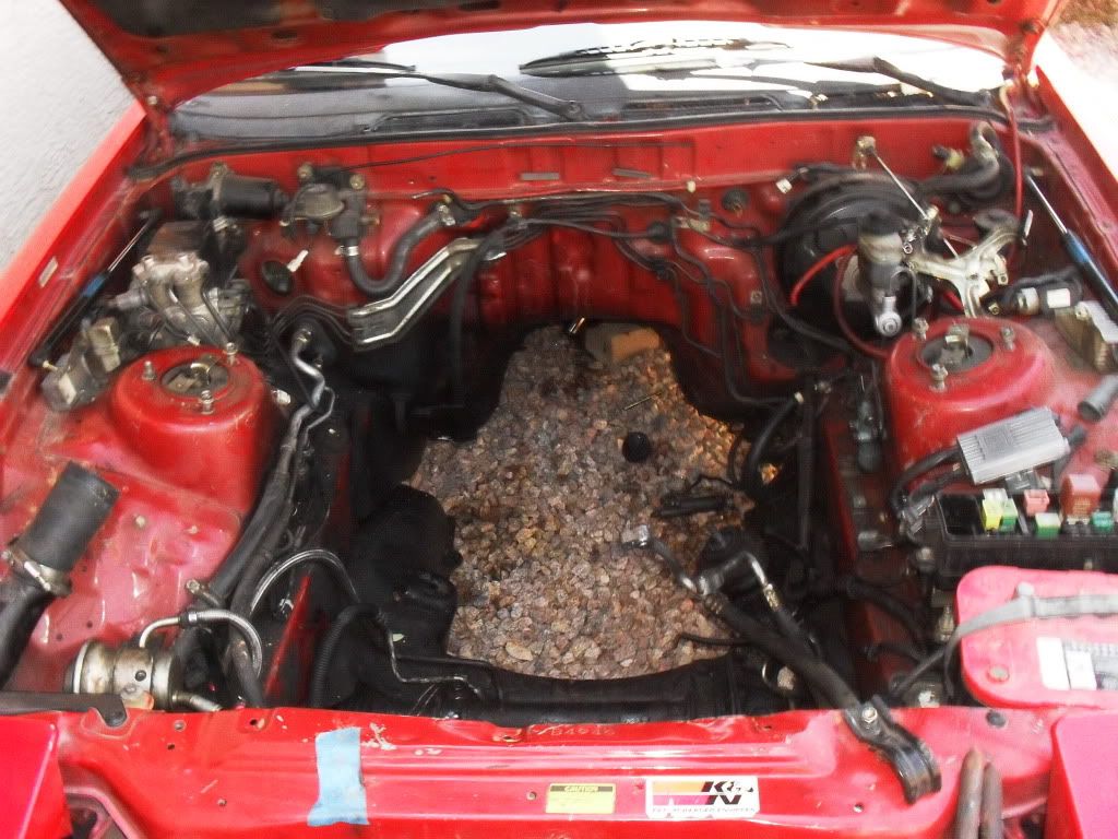

Well If anyone in their right mind wants to call it progress, me and a few members got the motor pulled today. here is a pic of the engine bay that i have to work with, oh god i have some work to do:

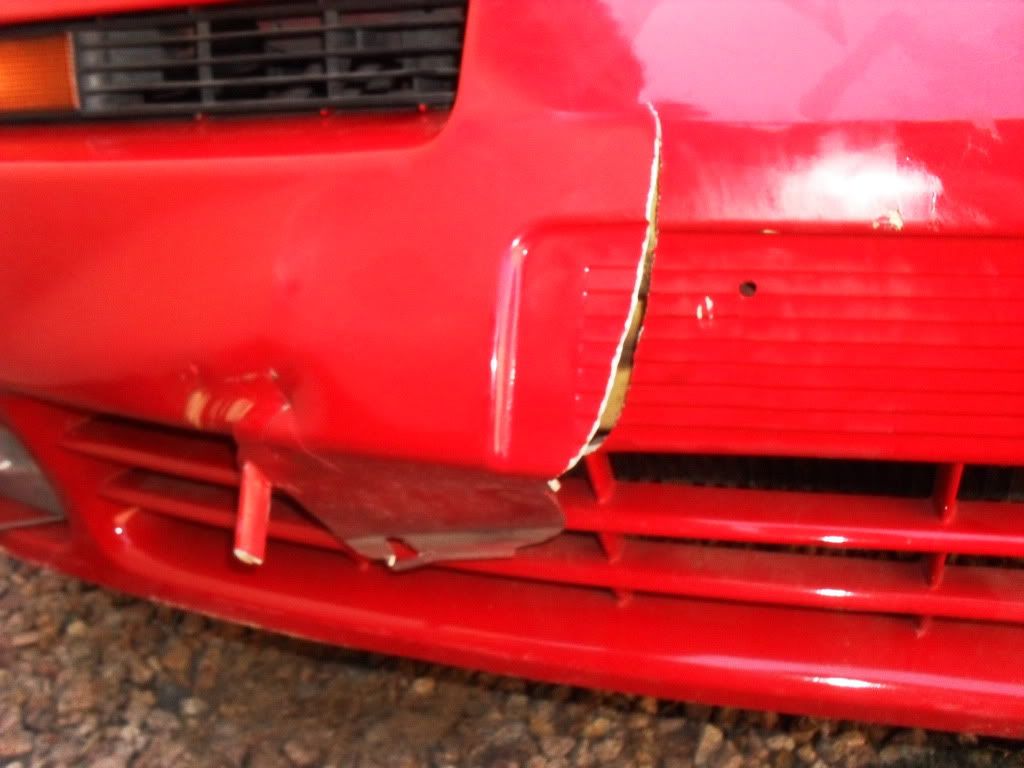

During the process, a mistake was made and my once beautiful supra paid for it:
I haven't been quite so mad before, but it was agreed that there would be a new bumper put on in place of the old one with new paint so its all good.

Damm the cherry picker is known to mess up bumpers... Thats why I want to sell that one and get a better one.. And you need to clean up that engine bay.. Are you planin on leaving it red or painting it flat black like the rest of us?
