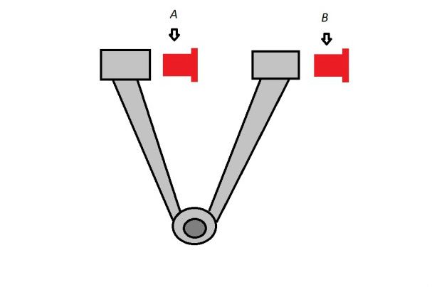

To those with Energy suspension front kits- Check this pic:

Looking down at the front upper A arm, should the bushings be installed with the flange to the inside (A),
or towards the outside? (B).
I'm leaning towards B, but the instruction from ES don't mention it. Thanks.
roadboy
Supra Owner
Jan 22, 2008
456
Toronto, Ontario
i remember they came in twos bushings which had the flange inside and outside. if not the flange goes to the outside, i just installed mine about 2 months ago
supraguy@aol
Well-Known Member
Dec 30, 2005
4,281
71
Atlanta
The rears are two piece.
The front stock units are rubber with a slight lip to the outside, now that you mention it.
Thanks, guys.
