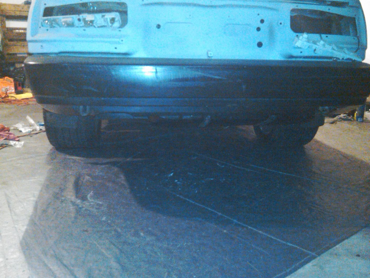

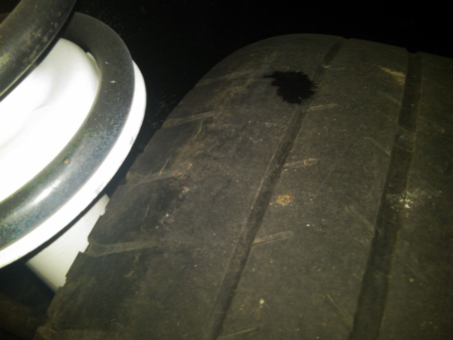

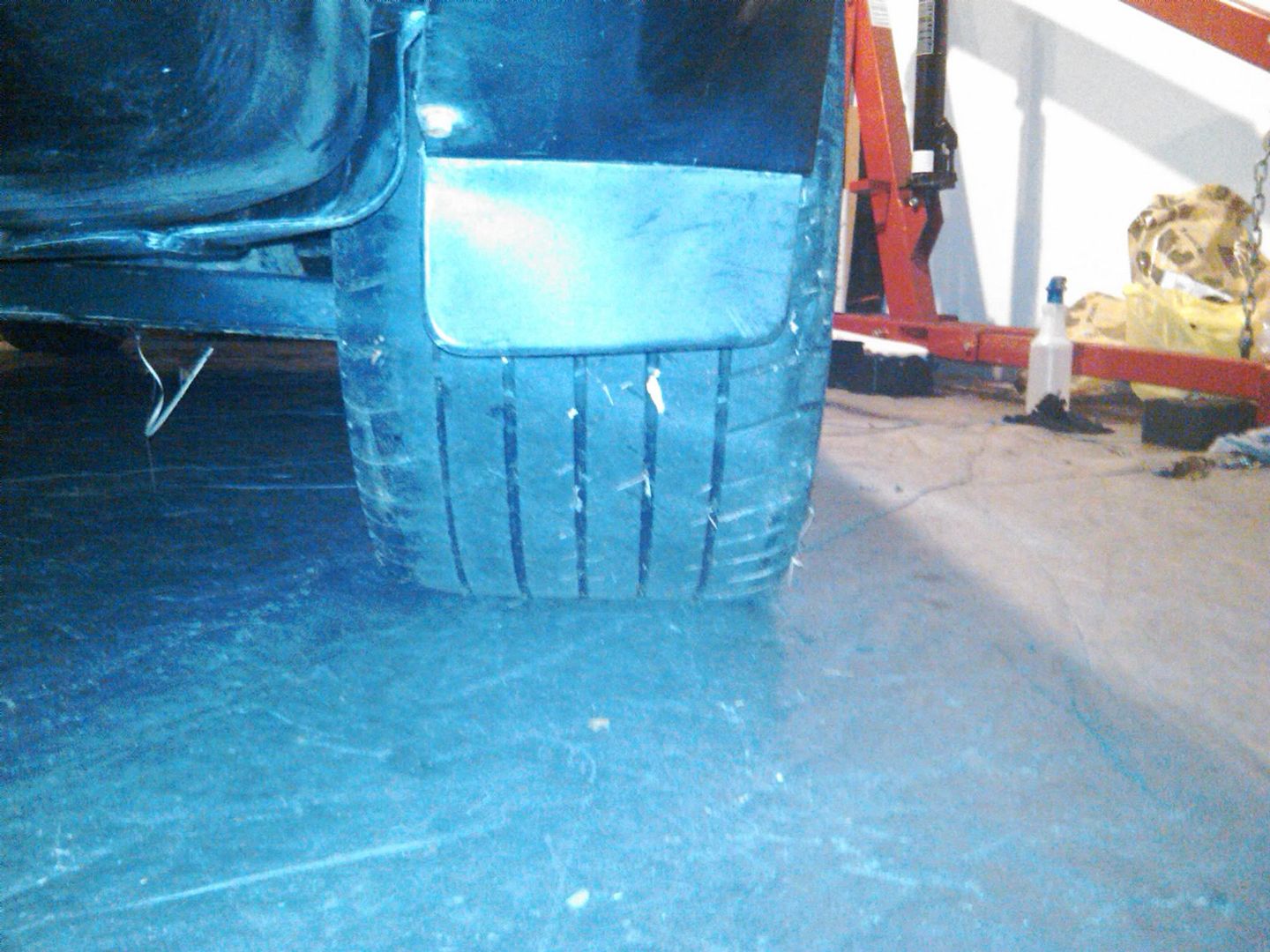

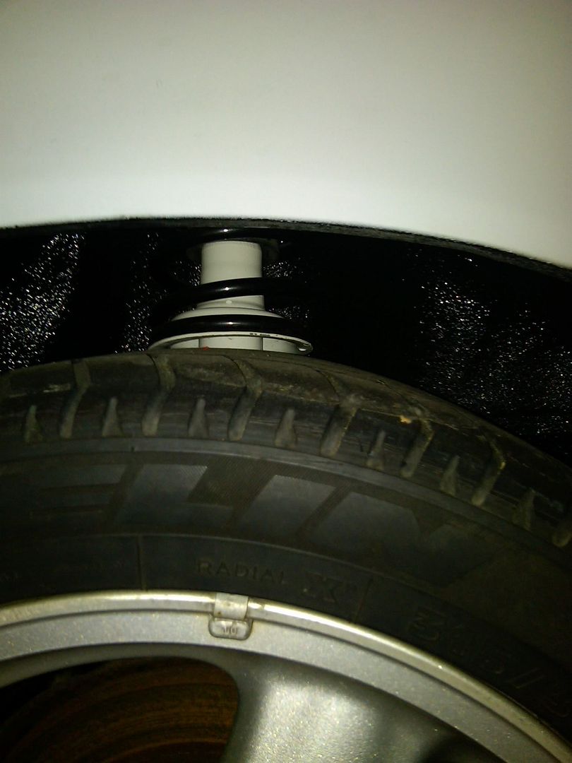

Snapped some pics last night of my 315/40/17 Michelin Pilots on 9.5" TT rims that I pulled from a wrecked MKIII at the junkyard and mounted for shits and giggles. Sorry for the quality, but it was dark and all I had was my Blackberry.
Surprisingly, they're still a good 1/2" from sticking out past the fender; but they are right up against the shocks and will hit them if you take a dip hard or have a fatty in the back.

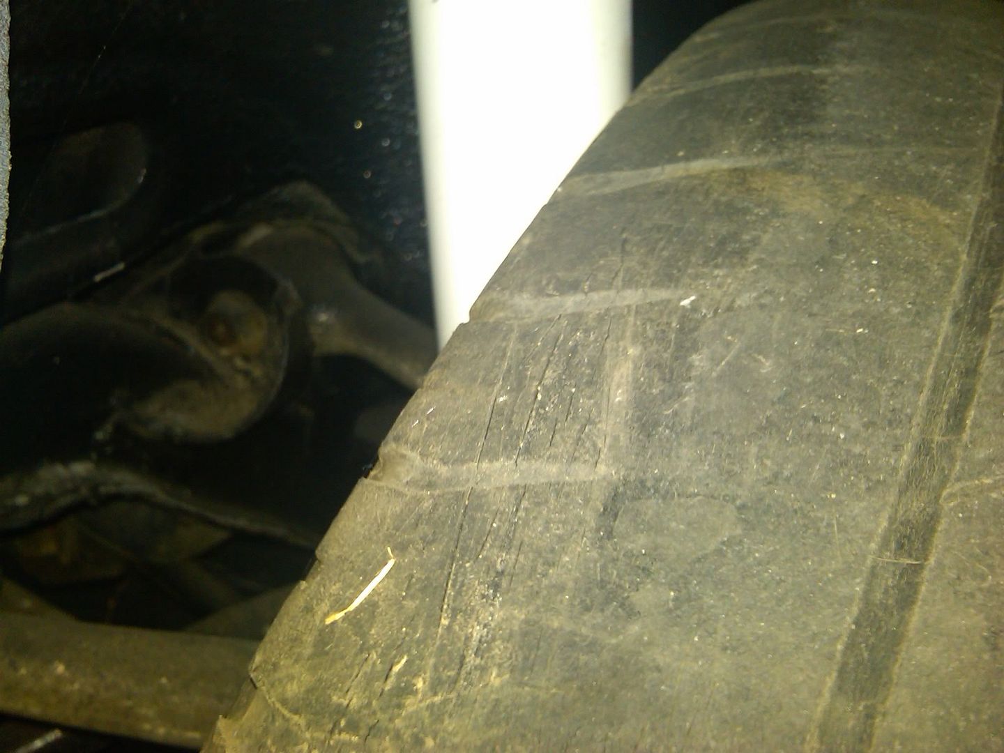

You can make out the goughes in this pic from where the rubber made contact on the previous vehicle.

Upon seeing those pictures, I think my new summer tires are gonna be a set of 315/35/17's... and a 10mm spacer. Question though, how much "mush" is there on those? I like a good stiff tire for handling reasons, would a wider wheel be a necessity, or do they fit on the 9.5" pretty good? I've got a set of Mk4TT rims in storage at the moment...

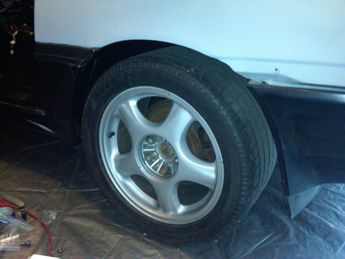

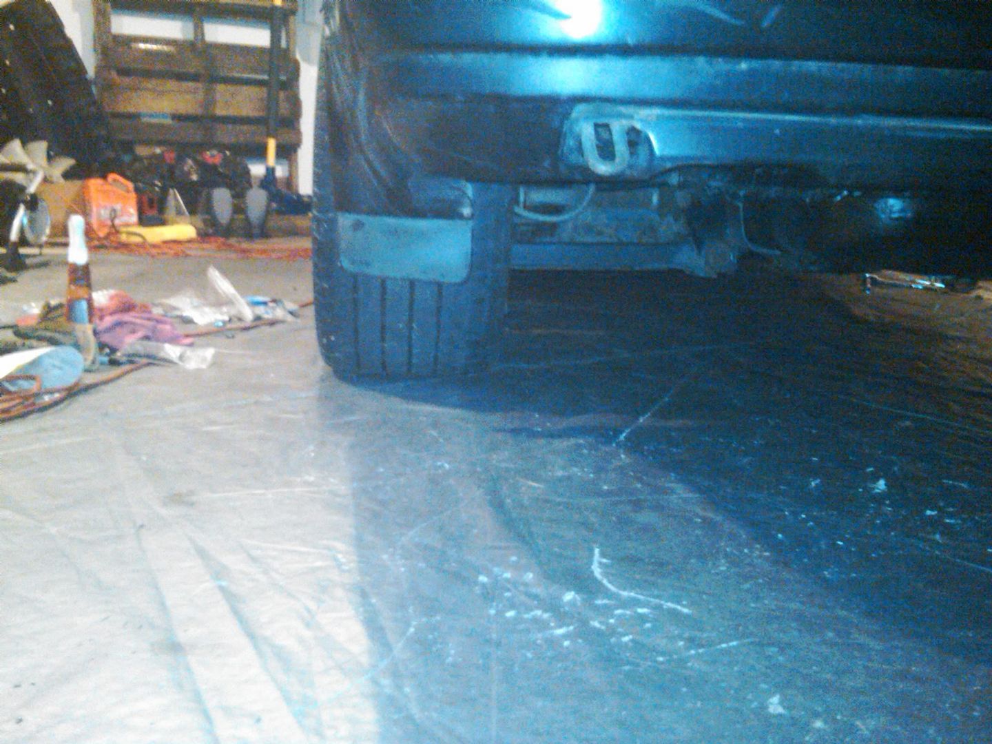

Shouldn't be much mush at all. It's surprising how little "bulge" there is running 315's on an 9.5" rim. However, the tires will most likely be making contact with the fender if you run those 10mm spacers. 8mm may be the way to go, though they may not be wide enough for tires to clear the shocks. It's a tough call.
Also, I'm not familiar with your current suspension setup, but there will be significant fender gap if you run 315/35's; look at the gap my Supe has with 315/40's. However, it will help with clearing the shocks.
I would love my new tires to be 315's, but I'll have to see just how bad I'm bottoming out on these before I put in that kind of investment.
Here's some better pics I snapped yesterday:
