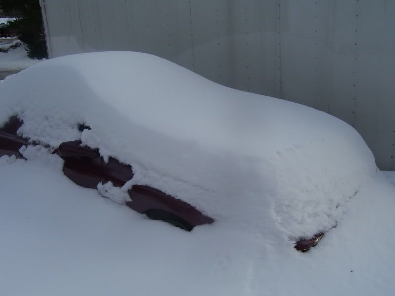

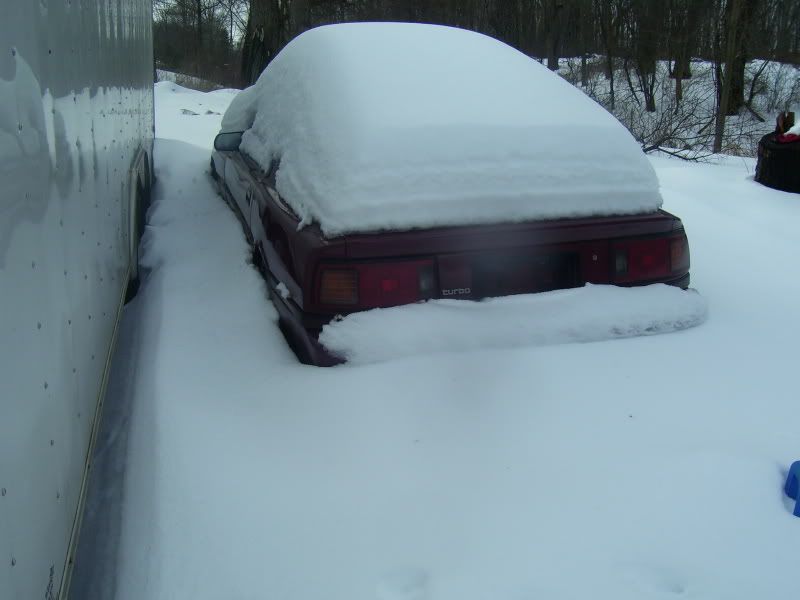

This is taking so much longer than I thought it would, but I am going to make a new effort now that spring is here. This damn economy has just set this car on the back burner for most of half of last year. Time to dust off the parts, oil up the tools, and get back to work.
Here is a pic of the car as of last month. Anyone from Ohio can relate to this.

Hard to tell by the pics covered in snow,but has it been painted yet?
If not,I'd be down to donate paint/bodywork(as long as you have a garage and compressor to spray it)I'll supply all the materials as long as it's not a crazy expensive color(s),if the color is expensive I'd ask for a lil' chippin' in on the basecoat,but I'd cover the rest.

Has not been painted yet Andy. Paint party? It would be great for you to do this. I have everything needed to paint and prep the car as I used to paint cars. Painting maybe a little further on. I think red is going to be the color inside and out. When the time come, I will be sure to hit you up.

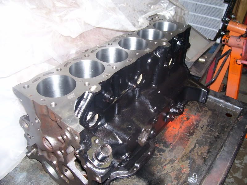

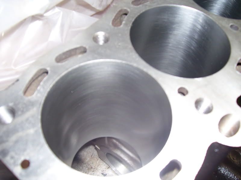

Got a little work done to the block, line bored the mains, bore and honed the cylinders, milled the deck, and put a little black paint on the block to top the rust after I washed it out.
Here is a close up.

Damn Bryan!! I would like them, but I already scaled a set of eagle rods and spun the crank for the weight. I would still do your crank at my cost however.
This short block will just be a temp. short block untill I have the time and money to build a proper one. So it is Eagle rods and probe pistons that I just had laying on the shelf for now. Later down the road when the car has grown tired of 6-700 hp, I will do a partial filled pauter/custom cp short block. The head I am going to do now will not be out grown. I am going to valve it, port, solid bucket, and 11 mm cam it from the begining. Still deciding if I want to do a crank trigger from the start, or spend the money on hobbing the gear on the billet core.

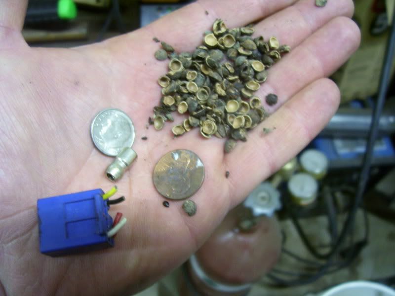

Just wanted to post what I found under the passenger seat when I removed it today. Look at all this junk, I can drop 100lbs just by removing all the spare change and critter nut stashes!

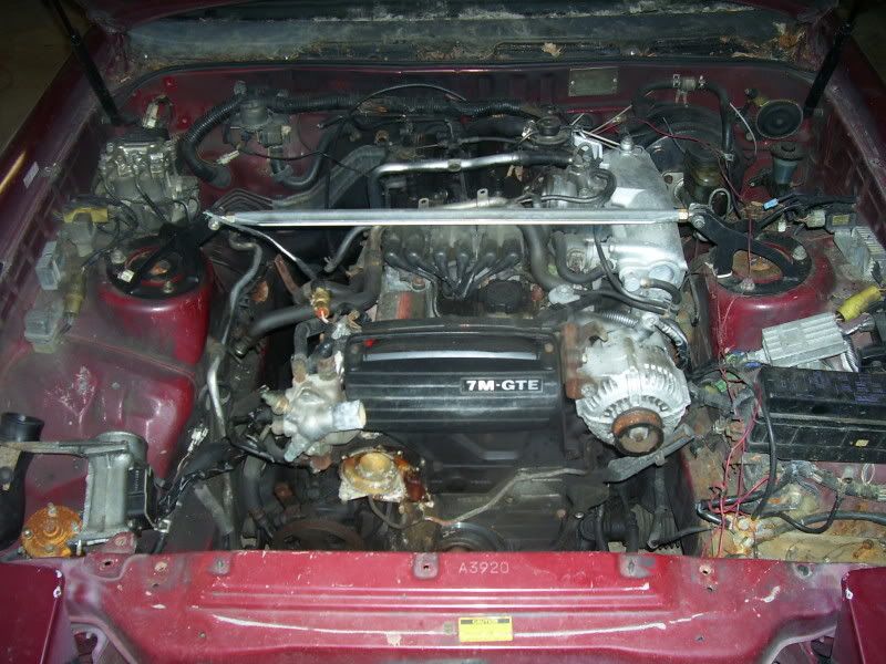

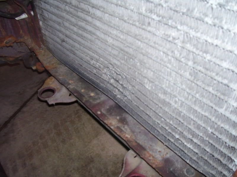

Pulled the radiator, fan, water pump, and pullies and noticed that someone in the past has messed with pulling the motor or the damper. Look at this dent in the air conditioner coil assembly behind the radiator.
Got the turbo and many other items off. Will pull the motor and tranny soon.

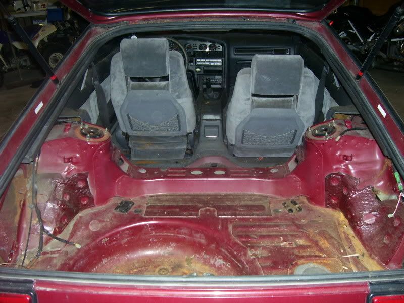

Started to pull the interior out to get ready for the cage. Finding spare time to work on the car is the biggest obstical right now.
I am going to try and have the short block finished in the next week or so. I have in stalled some arp main studs and line bored the mains. Next I just need to bore and hone, spin balance the crank, and start assembly on the hardware.
