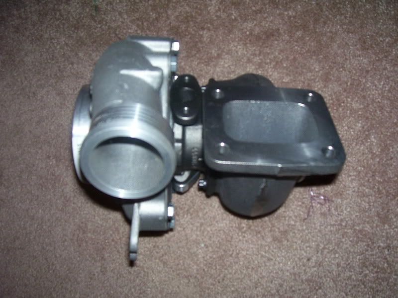

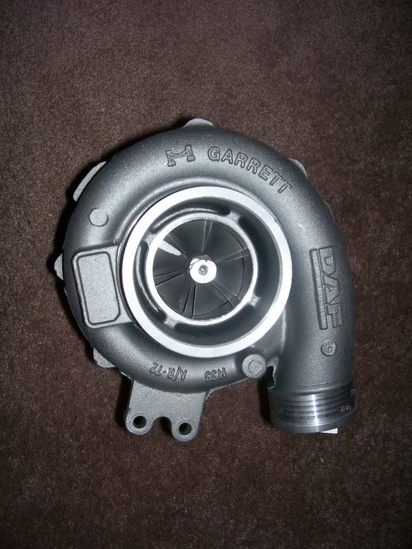

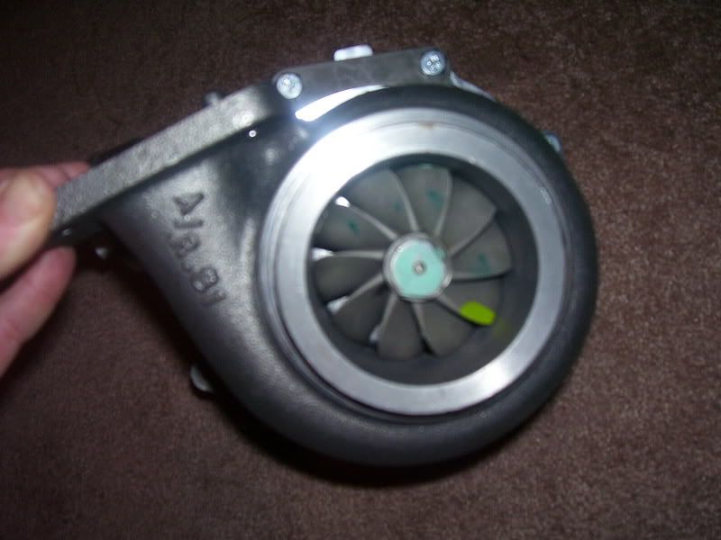

Here is a pic of the turbo donated by Sean. Thanks again to Sean from Titan for stepping up in a big way anf helping us out with a really nice turbo.
Garrett gt4088

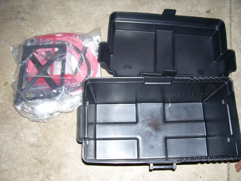

Here is a pic of the battery box purchased with donated money. This kit came with all the hardware and a bunch of wire. Really good deal at 49.00 bucks

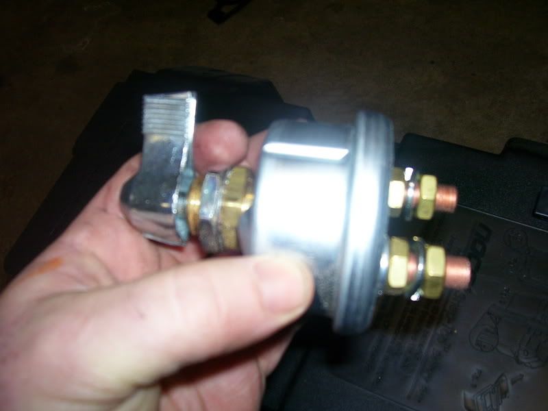

Pic of the cut off switch purchased with donated money.

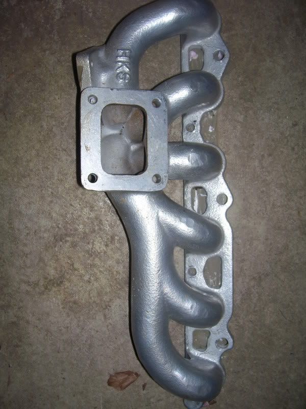

Pic of the HKS short runner manifold donated by myself.
55
Looking good and you can't beat a donated turbo...........especially a Garrett gt40.............:love:
