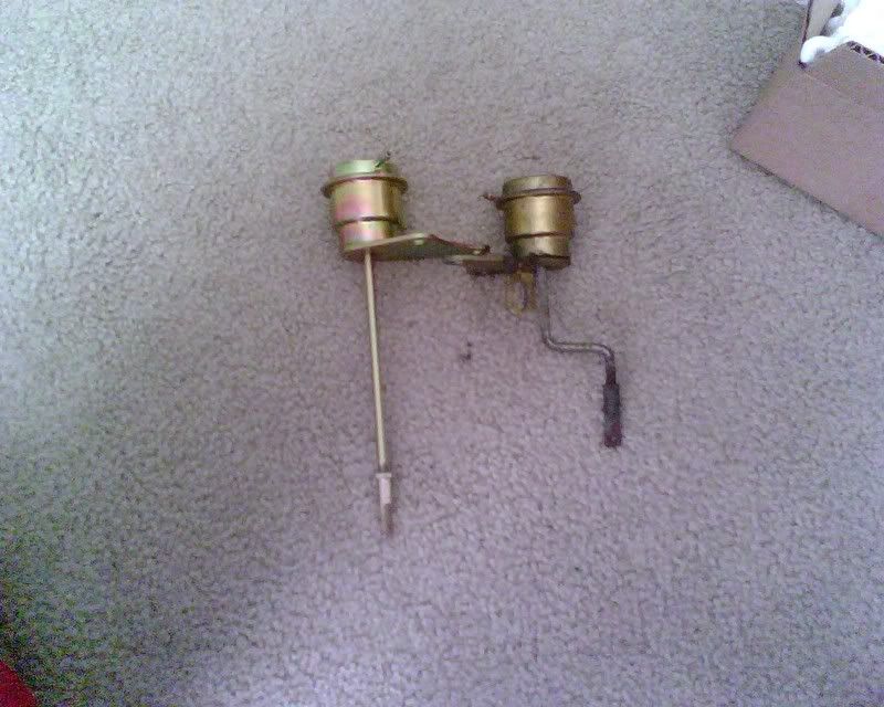

Do you have any pictures of your tdo6 actuator? Reason asking: I think you're on the right track wanting to use a tdo4 actuator.
Also, check out atp turbo online. They may / may not have a Garrett style actuator that could work for you with a bracket or two.

TD06 actuator on the right
on the left is a Replacement TD06 14psi wastegate (universal)
I checked out the website this looks promising, wondering how i can bend it like my other one though. Hmmm..

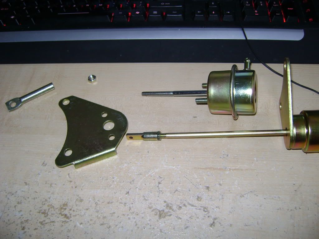

i actually have a Mitsubishi style bracket that i got with a eBay wastegate. I decided not to use the wastegate mainly on the fact its eBay, but the ebay wastegate is the one on top.

I may use the eBay one then to see if it'll work. I have a friend who can weld. I can get some steel rod im sure from sears or something. When I take it to my friend should I tell him to cover the canister end to block some of the heat the welding will obviously generate? Anything I should let him know?

I took my eBay bracket and traced the TD06 actuator mounting bracket on it so i can trim it. I need to drill one more hole. What type of steel is recommended for this application? I was at ace and found some 1/4" weldable steel rod.

Just keep tack welding it, each time cooling the rod off with a damp towel.

Alright cool thats simple enough. I found some weldable steel rod at ACE will this be ok to use? Or do i need a specific grade of rod? If so where can i obtain that?

garrett turbos are Mitsubishi Heavy Industry turbos. The bracket will work and probably the actuator also. Check the ATP turbo site to see if they sell a lower pressure actuator for MHI or IHI (Isuzu Heavy Industries) turbos.
