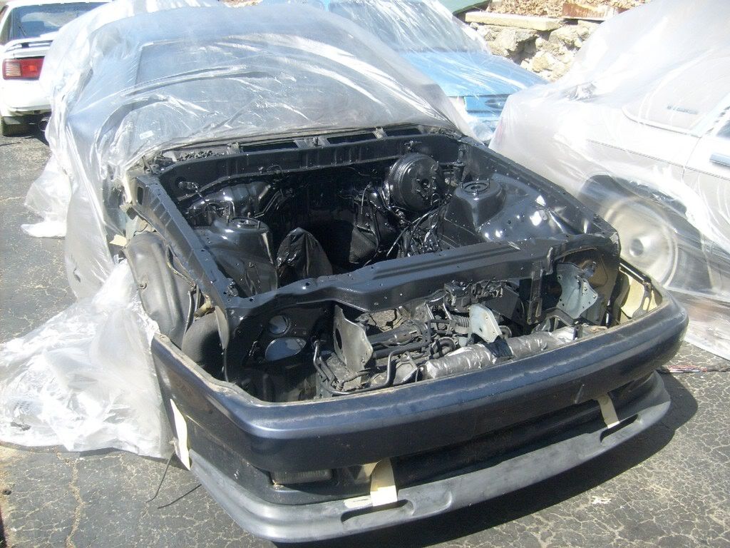

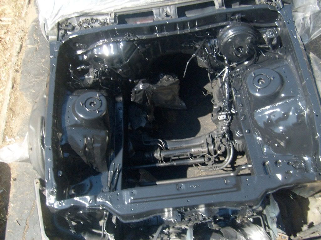

i have just finished repainting the the engine bay. i used an epoxy primer coolor and clear. i think it came out alright. youll notice i choose black. i did that so no matter what the extiorer color goes to the engine bay will match. my plans for this car after it is rebuilt are to enjoy it for the summer and then i want it to go back under the knife.

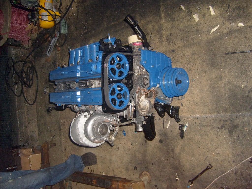

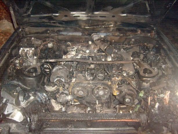

anyway here is where it started

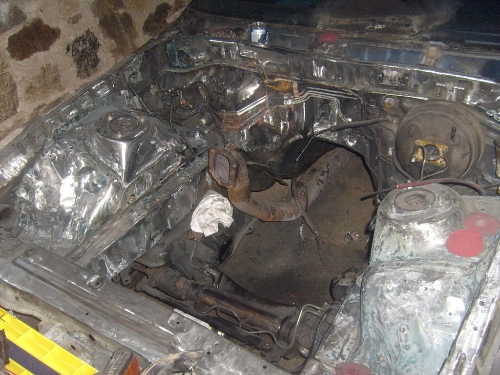

removed everything and sanded to bare metal

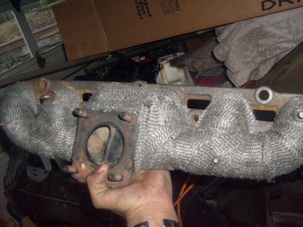

this took like an hour and a half. with the bigger hot side of the turbo the heat sheild woudnt fit anymore so i figured this would gring under hood temps down (i wrapped the down pipe too)

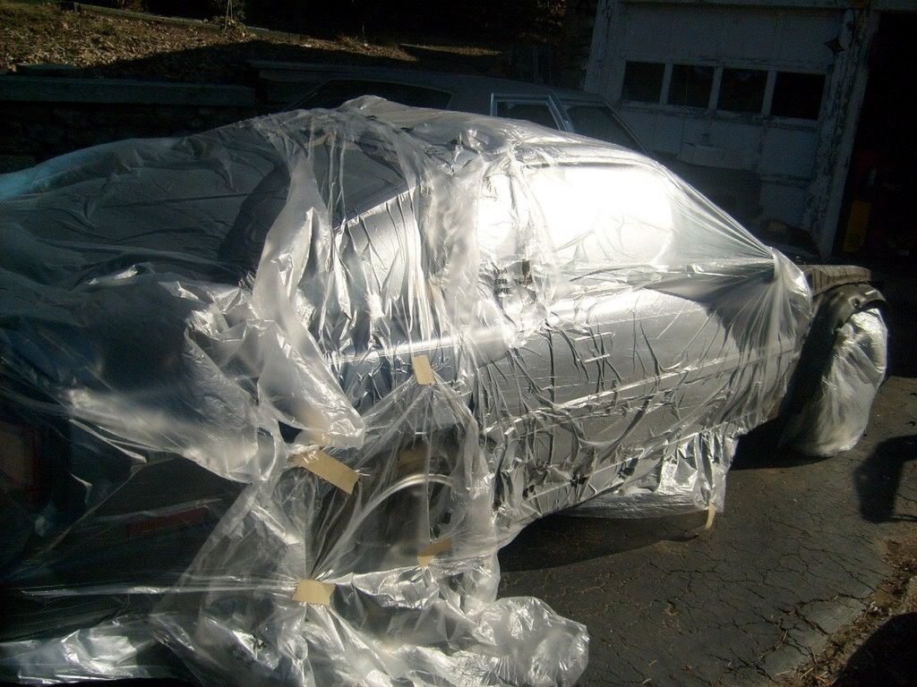

bagged

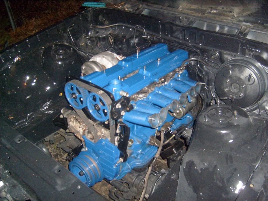

primer down
color and clear
motor 90 percent done i still have to clean up the valley

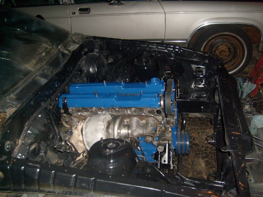

back in everything wrapped up. waiting on parts

nice catch. i just havent put it back on yet because i have to figure out how to make it work with the turbo blanket. ill post how i figure it out since it seems as if the blanket might restrict the opening and the colsing of the wastegate by putting presure on the arm coming from the waste gate acuater.
if anyone has ideas shoot them my way. i was thinking i am going to have to cut part of the blanket off.

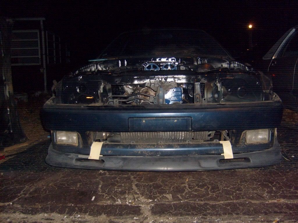

i lies i do have som pics ready.....please keep in mind none of this is lined up...i was just curious so i mocked up most of the front end.
Front end mocked up (mainy to see color matching)
