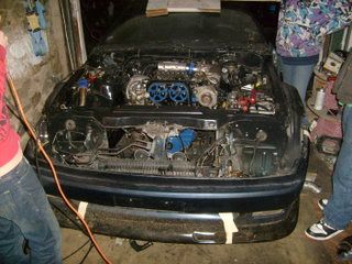

Well since I can't post pics quite yet I will post what has been accomplished the last 4 days and pics will follow.
Harness under pass. Fender cut and reconnected. (Old one all the connectors burnt)
Intake side of motor all hooked up minus TPS
EGR block offs instead of the valve
Electronic Boost controller hooked up
Modified N\A themostat housing group installed
Wiring harness repaired and installed

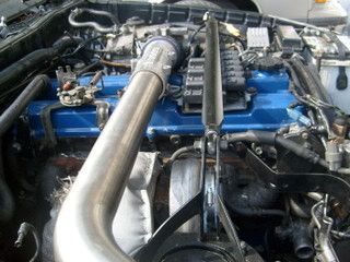

Custom post intercooler piping made
Stock pre intercooler piping installed

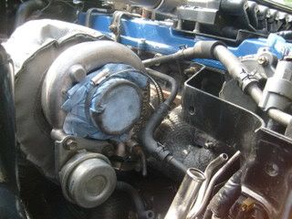

The wrapped exhast manifold with 60trim CT26 installed
Turbo blanket modified to accept internal wastegate
Wrapped down pipe hooked up
New sensors installed
Almost all vaccum lines done
New powersteering lines and resiovoir installed
I can't think of anything else.....but its 1:00 in the morning so I think its time to go to bed

well here it is the pics posts!
first a couple more from a couple monthes ago

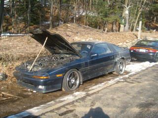

day after the fire
another engine after the fire
Ok. enough depressing pics onto the good ones...

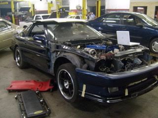

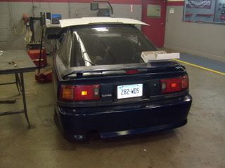

At school
lifts everywhere and somehow i get stuck working off jack stands

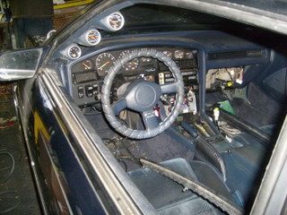

Interior (messy right now)

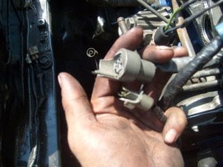

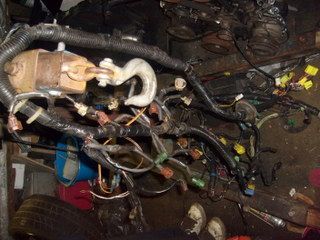

the new harnes complete with........
broken connectors that had to be........
Fixed

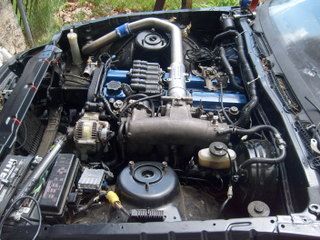

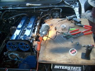

Sunday
Tuesday
this is why you cover up holes

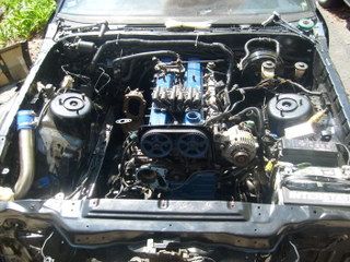

pass side
body harness under pass fender (all the connectors burnt:icon_mad:

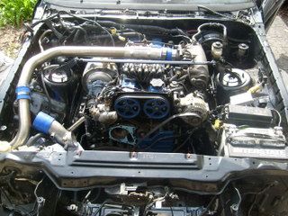

drivers side
i love this line on these cars
tight working quarters
front

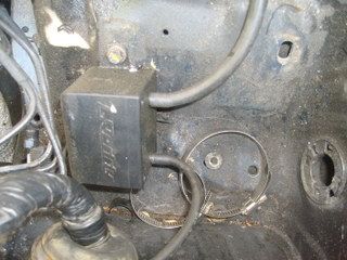

new spot for the boost controller soliniod
thats all the pics i have for now i hope you guys like them. thanks again for all the help SM
