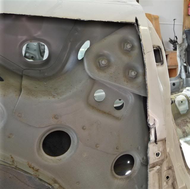

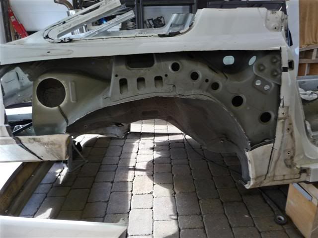

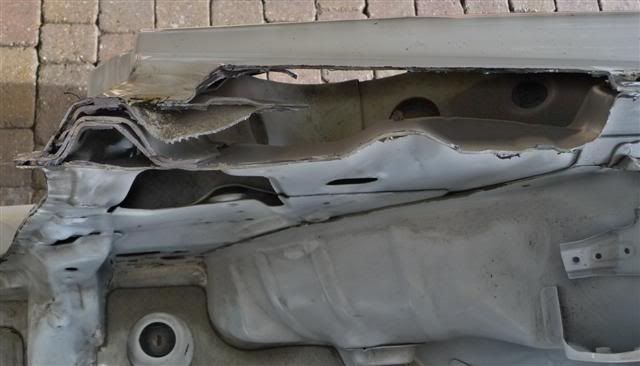

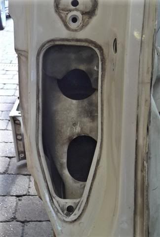

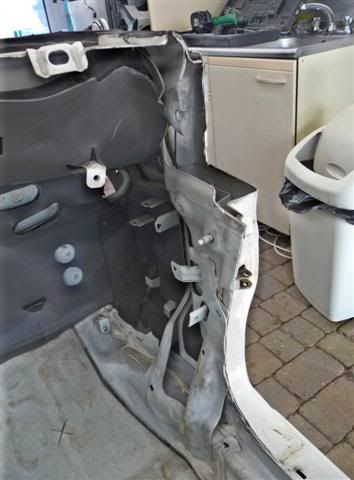

This may be of interest, I have just finished stripping down my write off Aero and cut a few repair panels off it for others.
You can see really clearly the additional bracing in the Aero shells & personally I think these cars, with the roof on are stiffer than the standard hard tops because of all this additional bracing.
The gauge of metal on these MKIIIs is quite something.:icon_cool
Additional rear arch bracing.
Door shut bracing.
Additional A pillar bracing where it meets the floor.
This is one strong car! B pillar.
