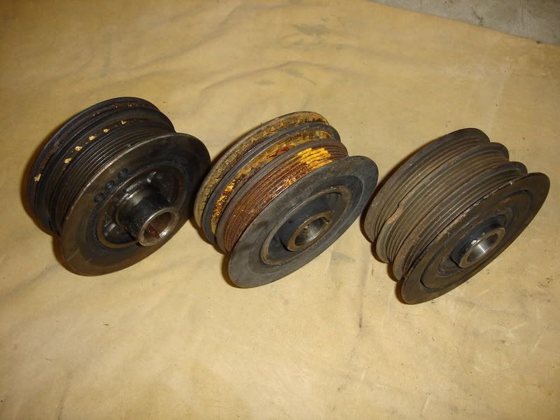

For those who do not understand why I am searching so hard for a 6M harmonic balancer:
left to right, 5M, 6M, 7M
6M looks to be the same as 5M except for the area that fits over the crank snout. I certainly would NOT like to try to make the 5M pulley fit, as it hardly has any material there to begin with!

you can use a 7m lower balncer but you have to change some of you other pulllies this is not hard at all you need is junk yard you cna find most of toyota truck and cars as for one you cna use toy truck power streeing pullie ect
