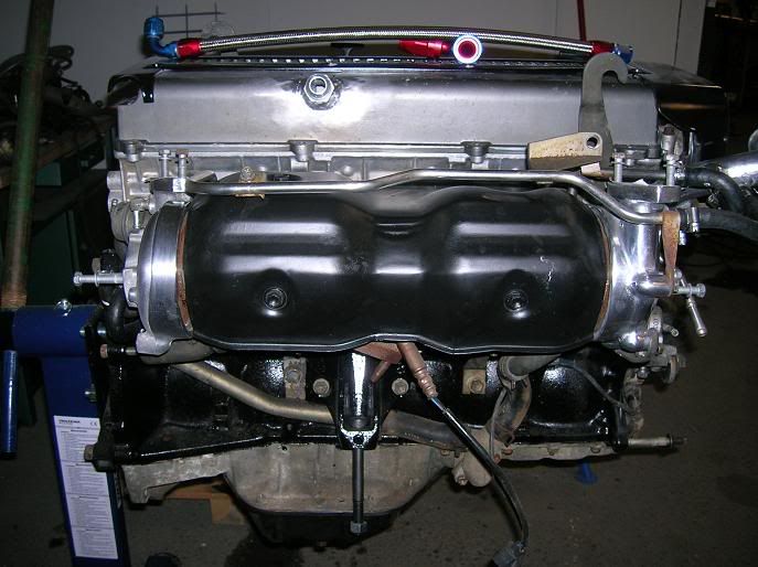

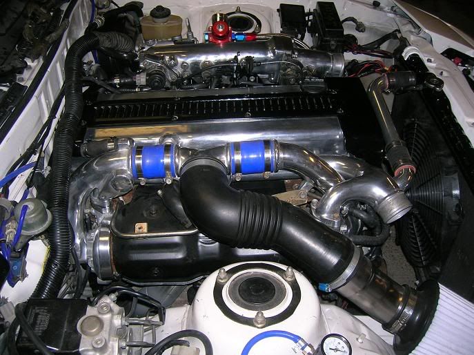

Thanks man! Will be another 20-25 hours in the garage this coming weekend, have to polish the valvecovers, intake manifold, turbo pipes and so on :)
RWHP
Going for 1JZ
Jan 14, 2008
126
Ostersund

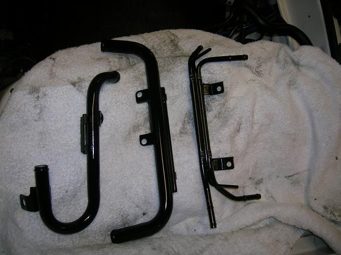

Painted some vacumpipes that didnt look good
Shiny compressorhousings and the heat shield got sme hot paint on it
Another one done, got some more to do :)

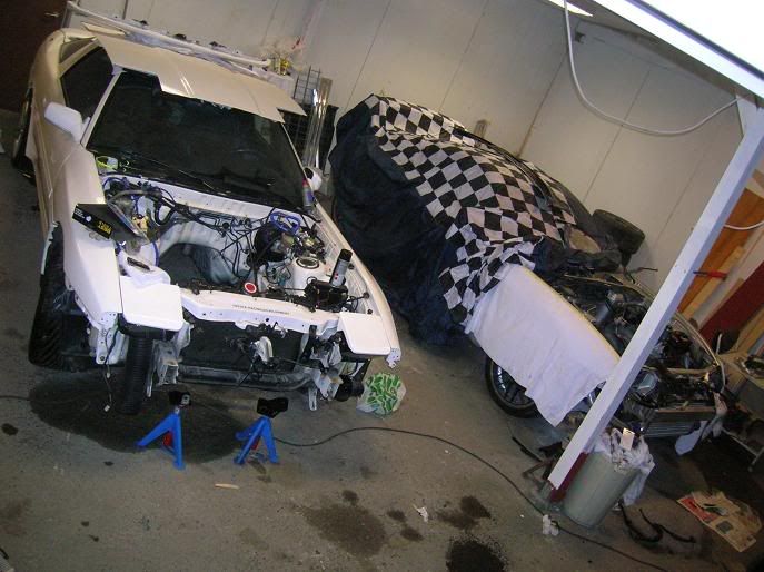

My Supra and my friend's Supra that i'm building

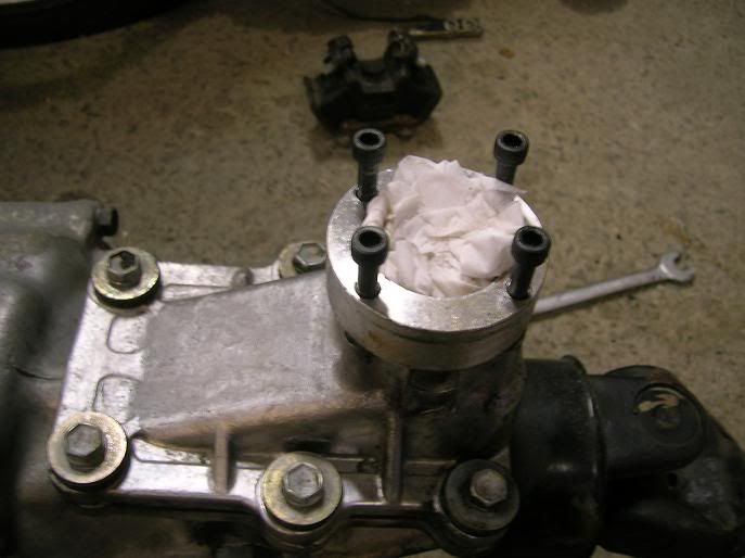

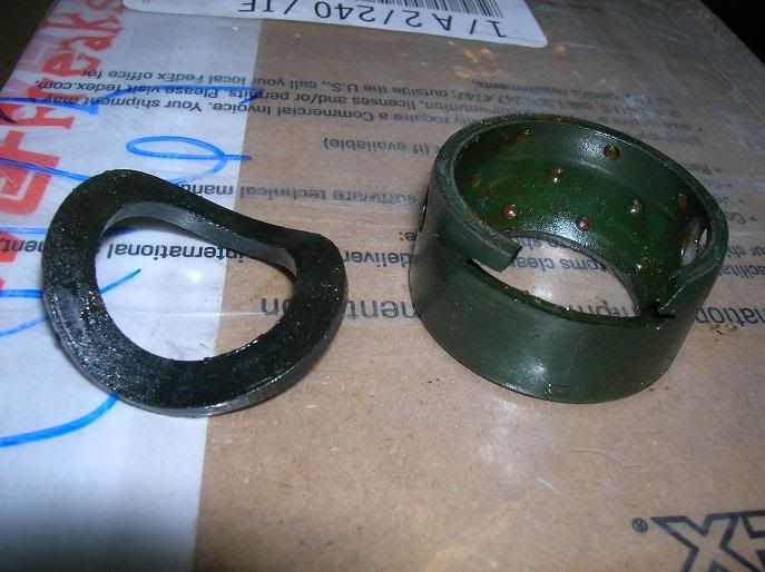

The shifterbushings is a bit tired, new ones ordered :)
Thought this looks different compared to other R154 gearboxes?
suprastanger507mgte
2x88+2x89+1x91+2x92=ME
3,148
Hayward , Ca
Looks like you had a short shifter on there? My C's had that aluminum base.
Nice clean up work man.
RWHP
Going for 1JZ
Jan 14, 2008
126
Ostersund
Got no clue, how do i find that out? :) Would be awesome with a shortshifter :icon_bigg Take some pictures on the shifter and put it up so you guys can see.
Yeah im talking about the top round pice. ususally they are square. Thisis for a Supra right:)
Yeah the C's shifter is ussually Stainless steel as opposed to the stock ones which are painted black. Don't you have your shifter? Post pictures.
Looked at a picture on a C's shifter and it looks pretty much the same but i will take pictures on it so you can help me find out :)
tlo86
Ninja Editor 'Since 05'
Jul 24, 2005
3,914
Colorado
yeah does look like a short shifter, are you just running that one electric fan? the bushing didnt look that bad mine looked a bit worse ;);) hehe. 1 trip to marlin crawler fixed that though: D

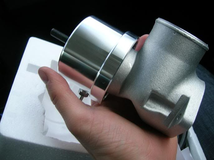

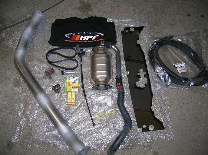

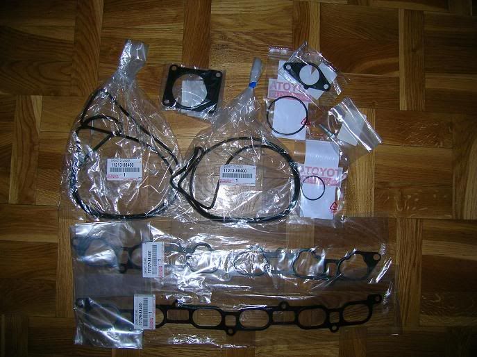

Got the last parts that where missing from Titan Motorsports, turbo timer harness and a Greddy Type-R bov. Order the last parts from HorsePowerFreaks to put the engine and tranny in the car, still have some parts to order and im waiting on the toyota dealer for my gaskets.

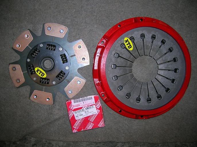

Yesterday UPS droped a XTD stage 3 clutch kit on the garage door. It will do for now, maybe change the pressure plate when the horsepower is going up :)
RWHP
Going for 1JZ
Jan 14, 2008
126
Ostersund
Yes I have read about the XTD clutch kit, but instead of reading what others have to say I know what its good for :) I used it on my old 400rwhp 7M MkIII and it worked fine for over 11000 miles :) There is also a guy in England uses a XTD chopper ceramic disc and he runs 10s at the 1/4 :) But we will see how its going!
Thanks anyway :)

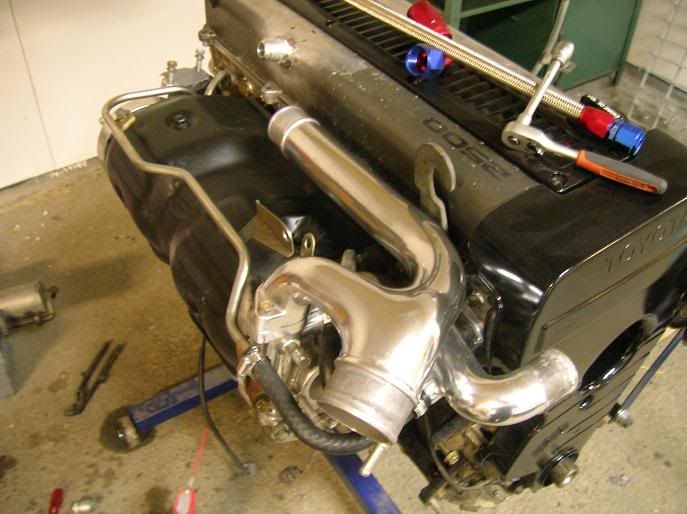

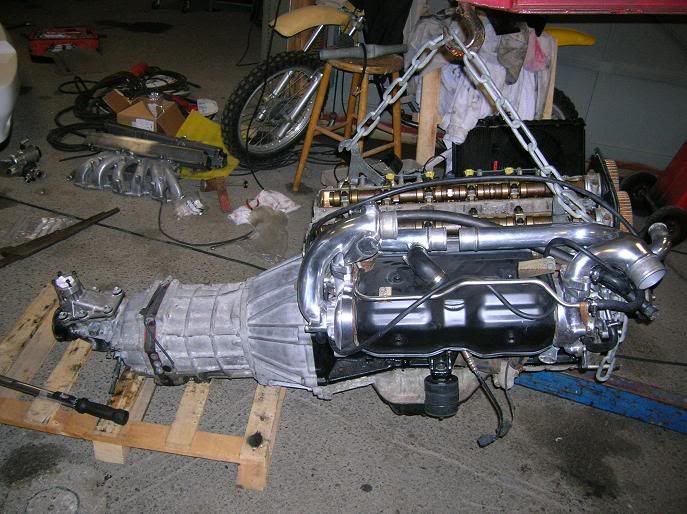

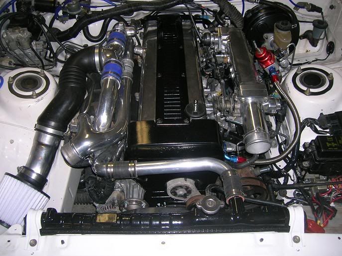

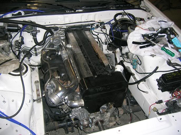

Finally got some things done :) Waiting for the last parts from HPF that will be sent tomorrow.

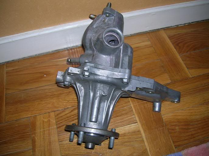

Got sponsored by ZL Workshop on a 2JZ waterpump that has gone 50 miles

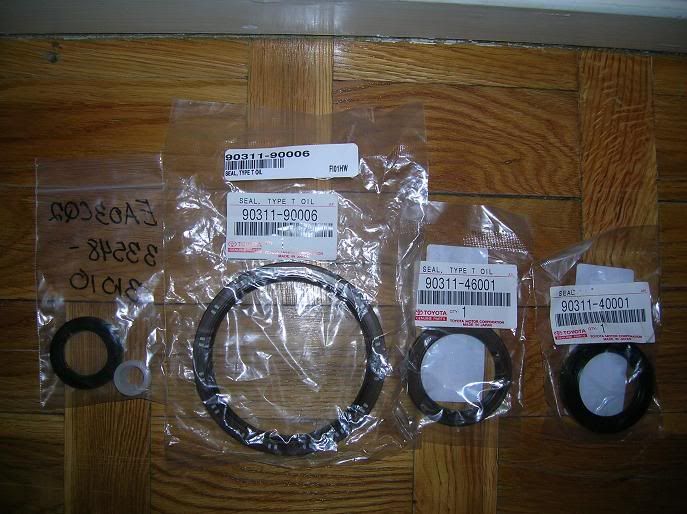

Since the local Toyota dealer cant get OEM 1JZ parts unless I give them a part number many it will take some time to get those, but finally they arrived

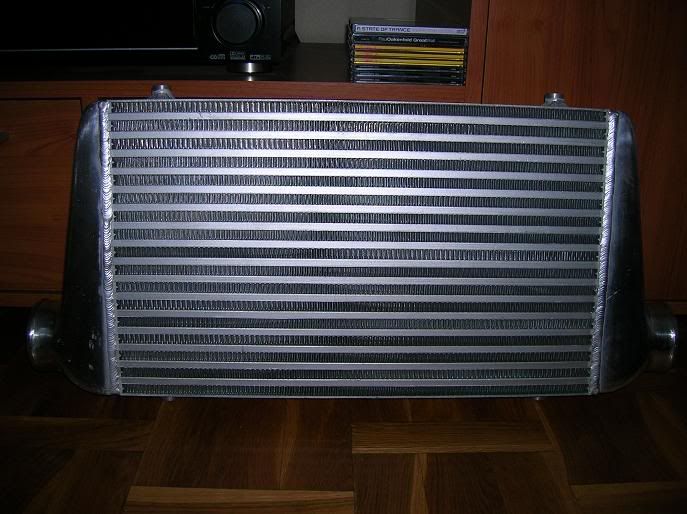

New front mount intercooler that measures 500x300x76mm

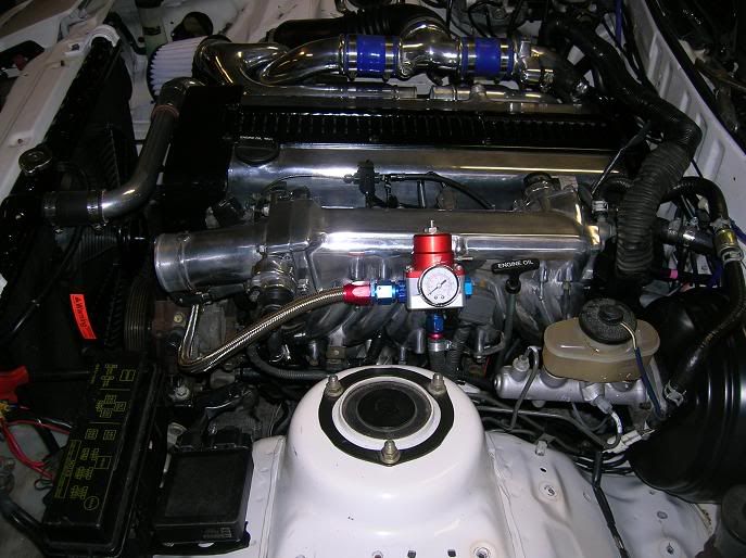

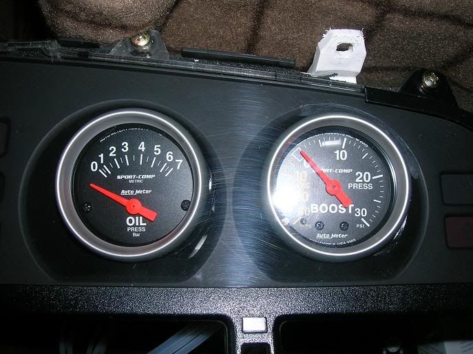

Made place for Autometer oil pressure and boost where the stock gauges are mounted
All the polishing isnt the cleanest work as you can see haha

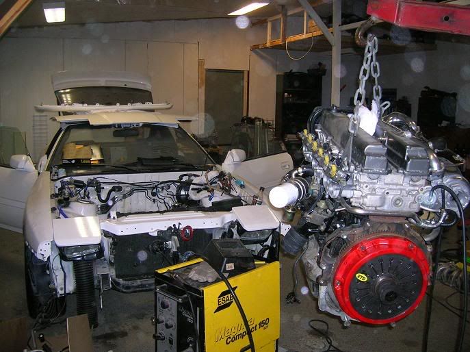

A friend mounted flywheel and clutch, ARP bolts for the flywheel
Ready to be lifted in place
After some minor work everything got in to place :)
XofXtimeX
Clean 2JZ
Feb 25, 2006
255
Arlington, TX
Do I spy hockey pucks for motor mounts? :)
Used those on a friends LS1 240SX. Turned out pretty well if I remember correctly.
Great work so far man just keep it up! Insane attention to detail. Good job!!!
-Nick-
Haha yes :D Hockey pucks are underestimated! And new motor mounts costs around $1000 :aigo:
Thanks man :)
