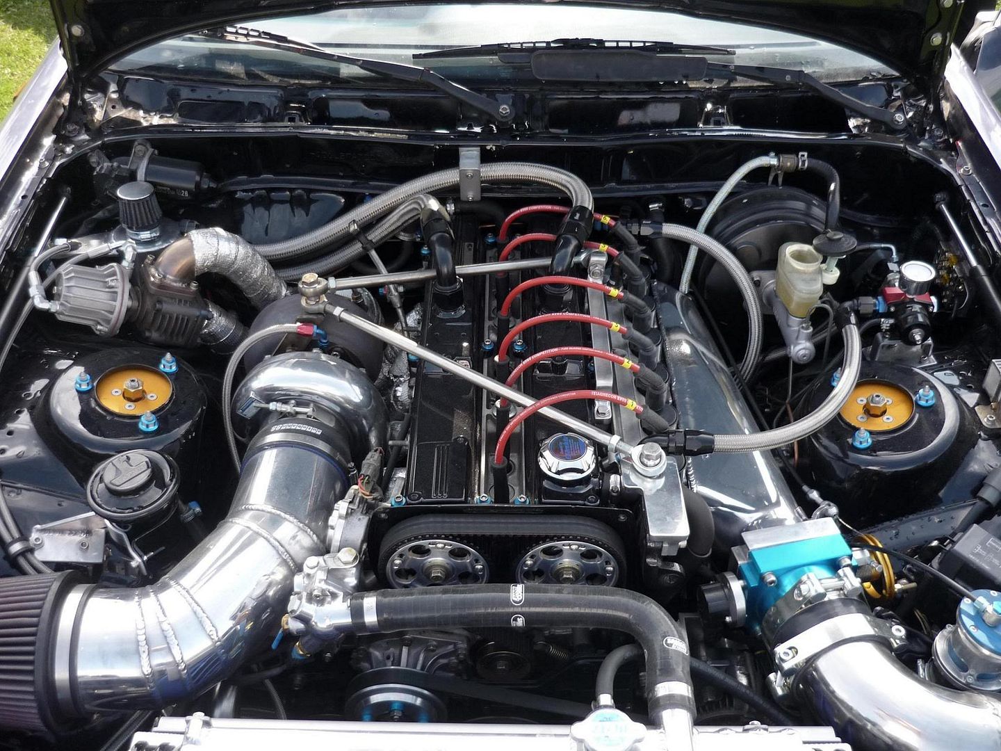

dslocal;1511687 said:
Pretty much done.
<3
MarkIII4Me
Project OVERKILL!!!
Apr 10, 2005
1,250
Charleston, SC
Damn son! Reminds me of this graffiti wall that was across from my apartment on the upper east side. ;)
That's a hell of a bov. ARC? SARD?

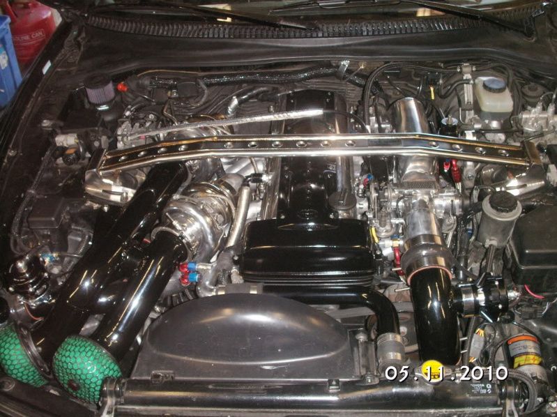

Sawbladz
Mar 14, 2006
1,727
Oshawa, ON, CA
I finished the car. Still needs tuning but that's no reason it can't go in here. I have countless hours and too much money into the car and I can finally say that I think the car belongs in here.

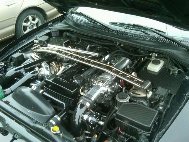

Neodeuccio;1556557 said:
Wow, I love that intake piping! Is it custom, or did you buy it somewhere?
I was thinking the same. It should stay a tad cooler routed that way. Looks custom. Either way it's nice.

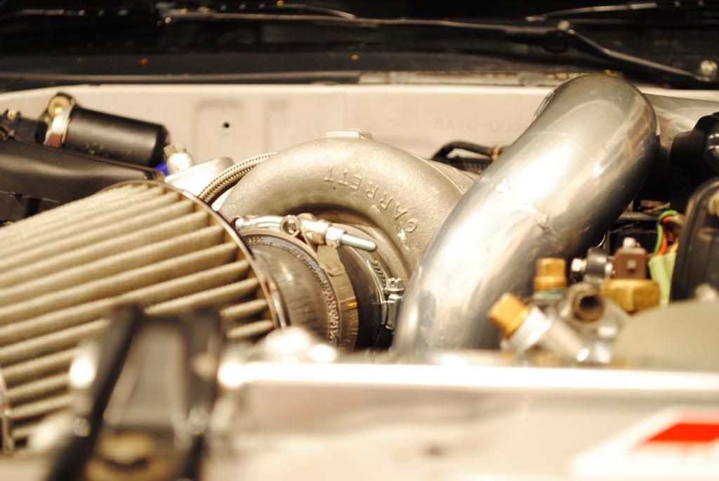

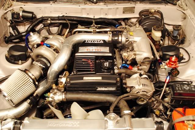

It is custom, It was made by a friend in phoenix. It is also ceramic coated to keep cool as well as the turbine housing to keep things hot.
Nick 95 6sp
Ported & Polished
Sep 5, 2007
155
S.E. PA

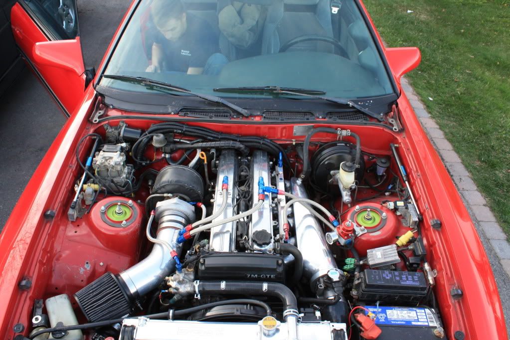

Just finished it last week and I'm very happy how it all turned out.
I started with a nice used HKS twin turbo kit but I didn't want to use the GT2835's, too laggy for my taste. So this setup uses two Garrett GT2860's with Tial exhaust housings which are V-band of course, so my fab guy, Rick, cut off all the flanges and welded V-bands on everything to fit two Tial wastegates and two Tial BOV's. It's so responsive it blows my mind; even better than I expected.
