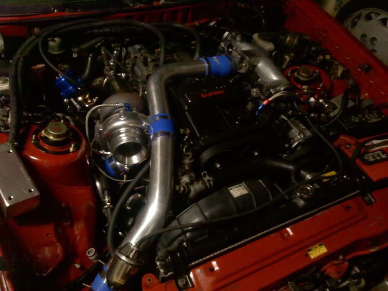

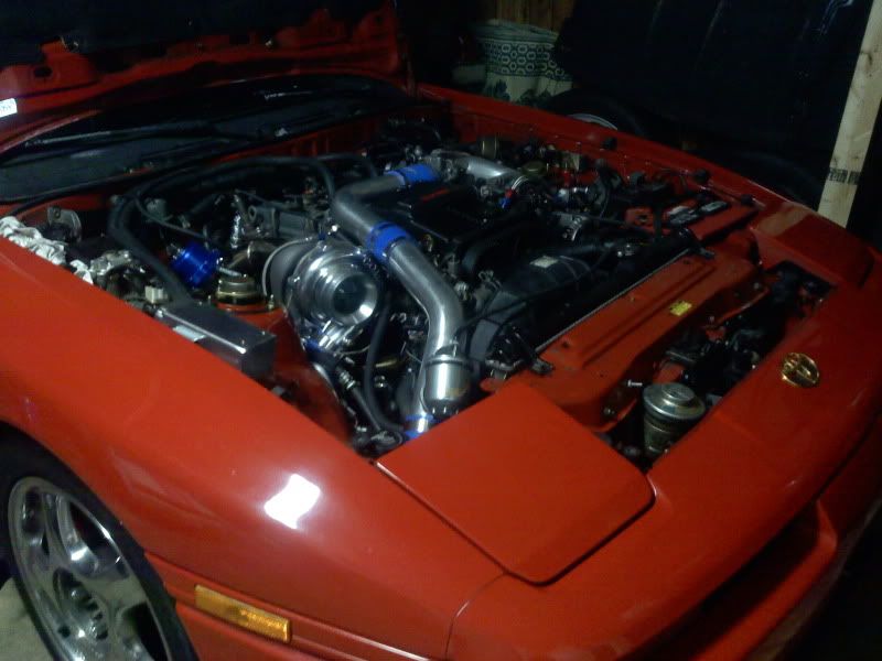

Not to get real far off topic but whats that in the back ground? A Bradley?

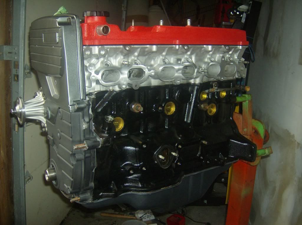

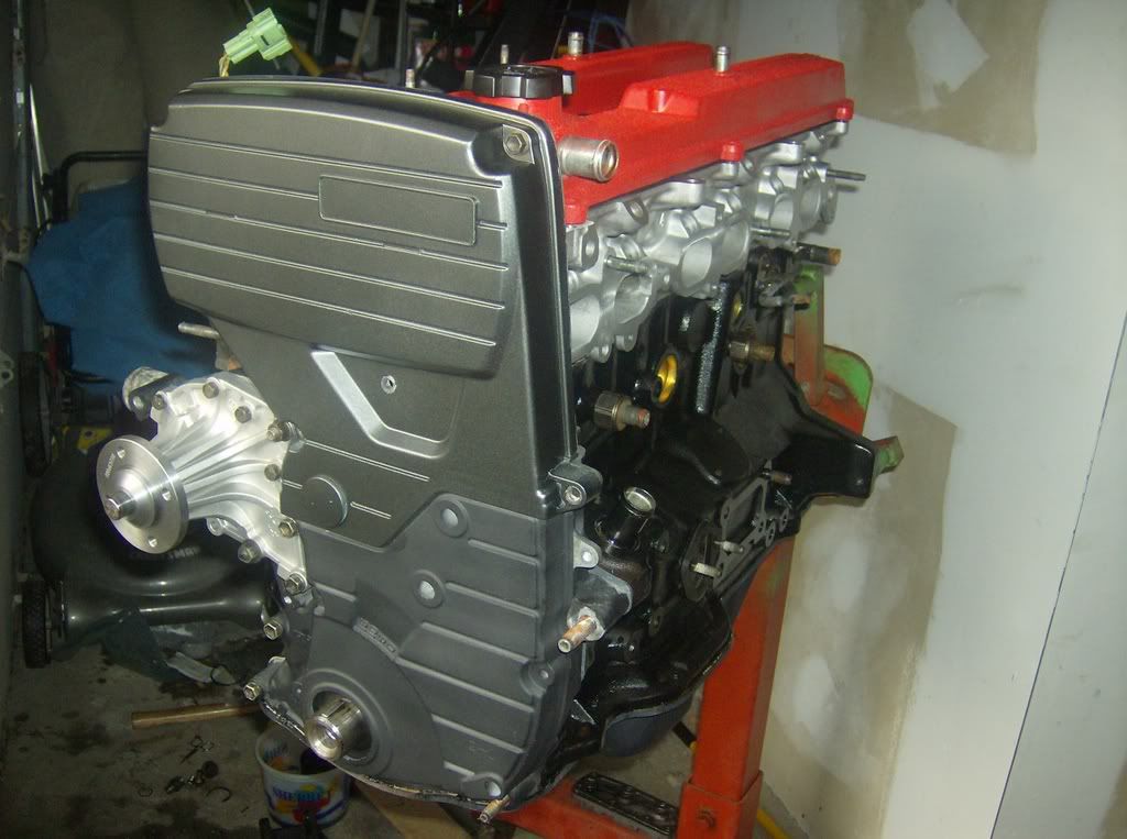

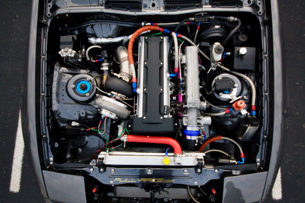

Hmm, well I rebuilt my engine a couple of months ago and this is how it looked before going in to the sup....... :D

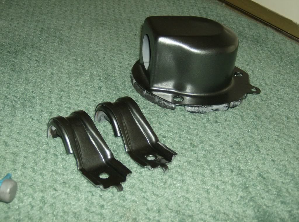

My friend Derek (JDMMA70) texted me at 1 am in the morning saying he had an idea for the valve covers... He said ferrari red, I was like WHT? its 1 am you know sleeping..... Next day he told me to pick up some wrinkle red.... After seeing the outcome of the nice texture red I wanted to do something a little different..... So I headed down to Auto Zone aka Vato Zone and picked up some dark grey (storm grey) I think... Rustoleum sand paper and tried to do the best I could on budget... It was more like a mock for later on when I could afford powdercoating.... I painted a few more parts in the engine bay that were away from extreme heat...

I was wondering what primer you used to make sure the paint stuck to the plastic piece
Cheers

I used this awesome primer name brand rustoleum, you can find it at walmart for 3 bucks a can..... Just make sure its the car one, it has a little red car on the front... Alot of things were rusting away soo they looked awful, might as well paint them and help them out somewhat/stop the rusting with rustoleum.... So were is a pic of your engine man... Curios to see it now hehe...

Id suggest to get two kinds of sanding paper... One rough and one 1000 grit wet/dry sandpaper or as close to 1000 as you can get..... Sand it down untill it is smooth then apply primer in thin coats.... Get a water sprayer and once primer is dry spray it and sand it with the 1000 grit wet/dry sand paper.... Once smooth do same with paint, thin coats and dont forget to apply clear afterwards.... The finish in most cases is incredible.... Some people dont believe it was done with a few cans of paint and primer... Sorry for the OT guys.....
