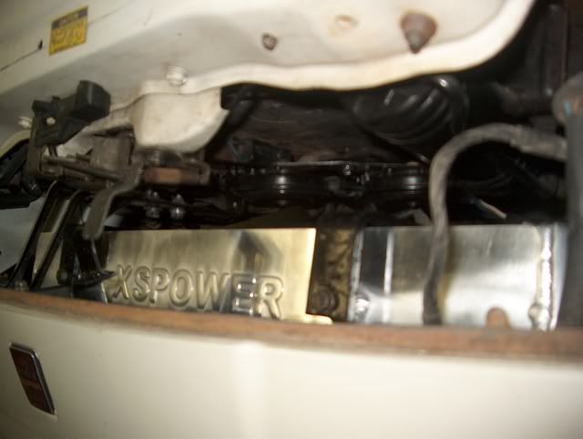

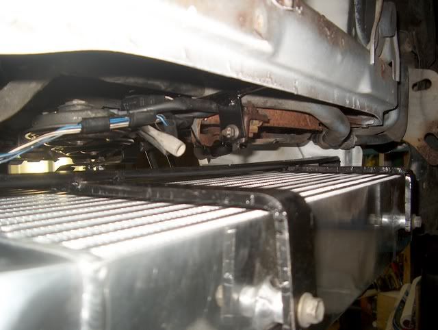

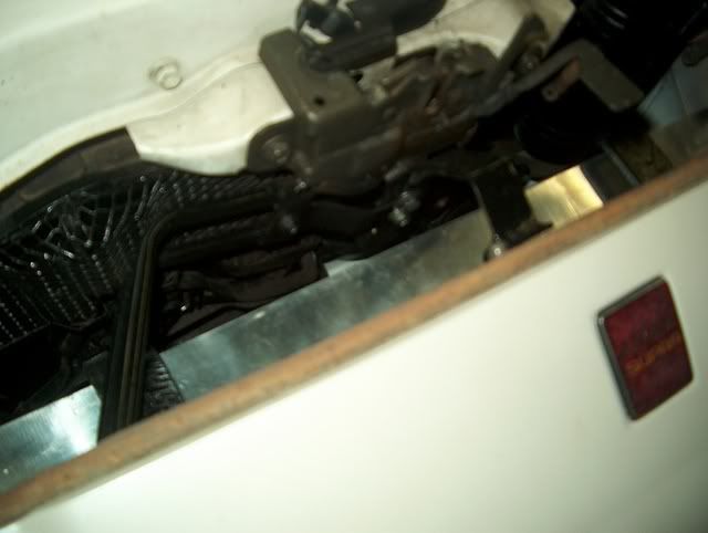

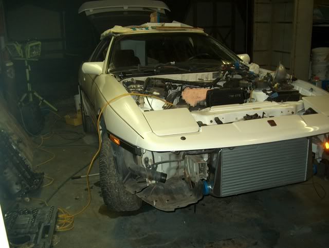

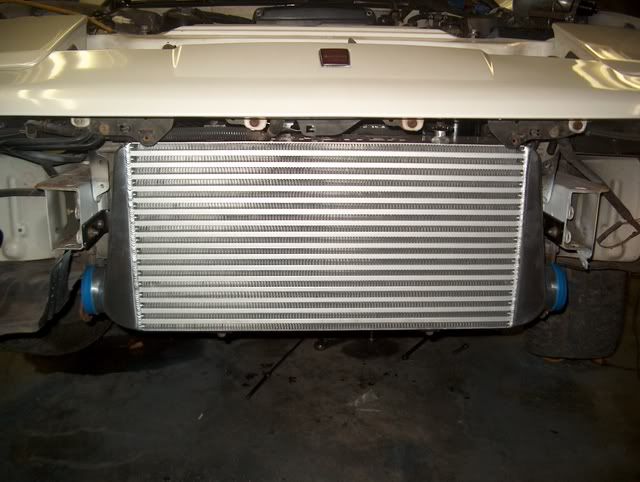

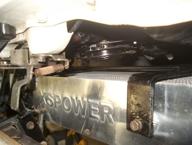

Pics of my intercooler 4in x 12 x 24 mounted and custom brackets i remove the stock nose piece bracket and custom made one to support nose,power steering cooler line,horns,ac fan shroud,hood latch
suprahooked
Built 7M
Jun 20, 2006
1,160
pa
Reign_Maker said:
Lookin good man... I like those mounts, look really solid!
Yea the intercooler dont move at all ,I bought 1in 1/2 x1/4 flat steel at lowes and made them up,the nose support is 1in x 1/8 flat steel ,I know its a little added weight but i figure that i dont want the IC to move around. Thanks Reign :evil2:

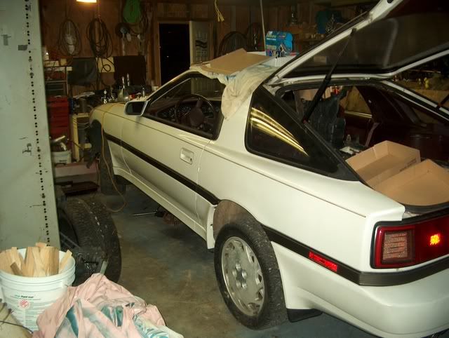

gtsfirefighter said:
I'd like to see some pictures of the whole car if you have any.[/QUO

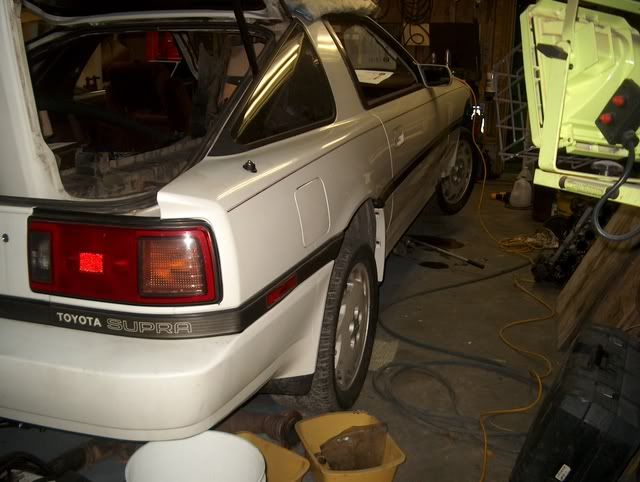

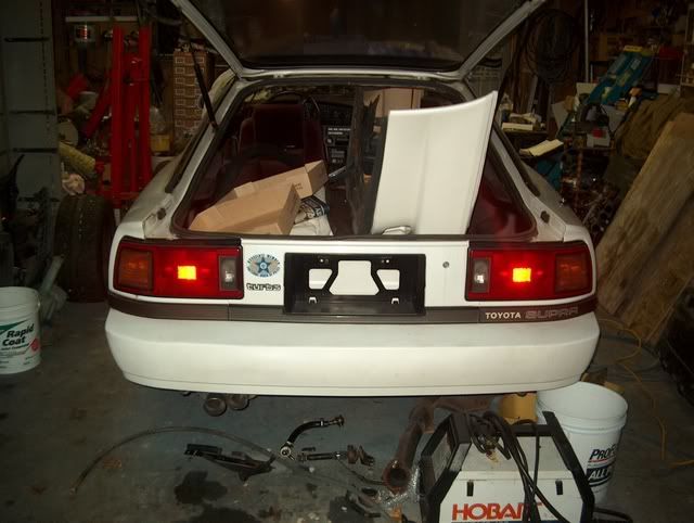

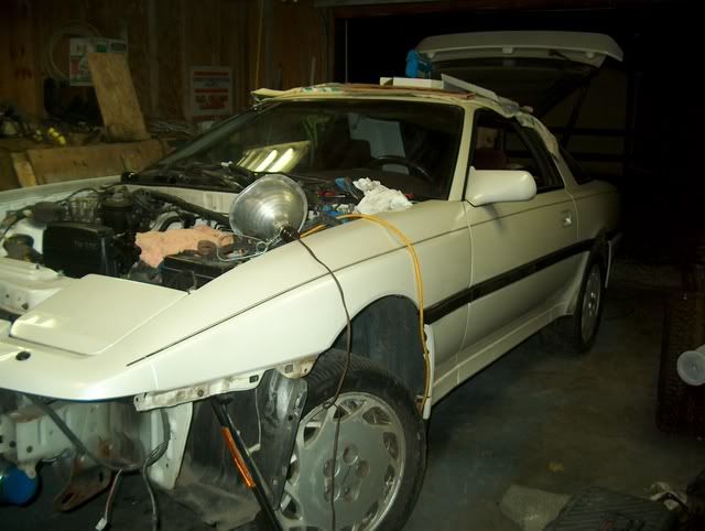

Well its in the garage so i cant get a pic of the whole car but i did get some side shots:biglaugh:
