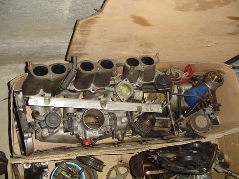

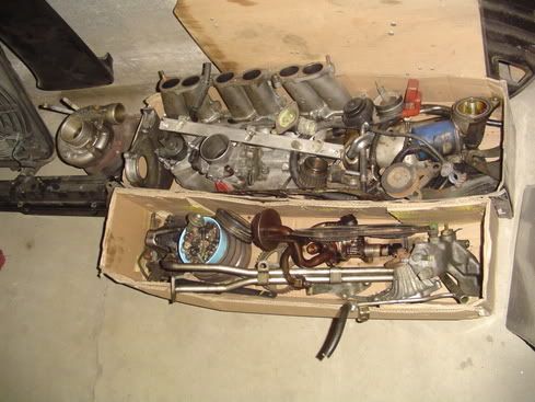

piles of junk, most of which to never return to the car.
new/good parts to be used

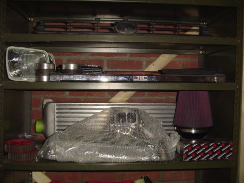

JIC Lower arm bar, Hella H4's, Semi-Solid motor mounts, SSAC manifold, PTE "medium" IC (600hp), Intense Performance air filter. it's massive! 4" inlet.. yep.
TODA cam gears.

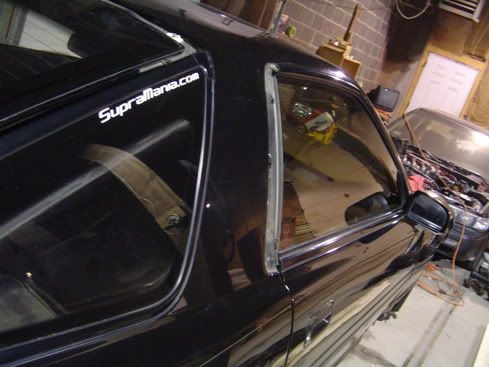

gotta represent :D
and a little bit of carnage. stupid trailer ate my defcon dp... :(

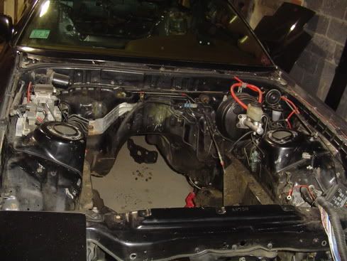

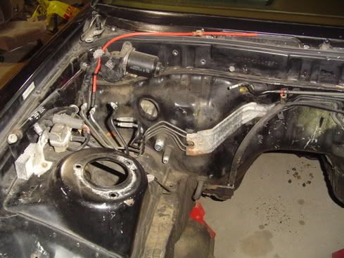

Also, I forgot to put a caption when I posted this picture, but I'm very excited to be rid of that g'damn ABS!! Now all I need are the non-ABS brake lines and distribution block, which I believe Toyota has discontinued :( More bad news... But the good news was that I ordered all the windshield mouldings (except for the cowl) and a new hatch seal.
Bye bye Nuclear power plant!!!

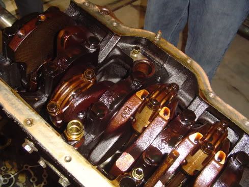

Today's update.
Today I tore down the head, and am contemplating using it. There is some scouring on the cam journals, I want to see what the other head I have looks like... I hope the cam journals are good. This head appears to be cracked at that triangle-shaped hole where the thermostat housing bolts to, directly in front of the CPS... the lower stud hole is cracked straight through at the bottom. I'll try and get some pics up tomorrow. The damage doesn't look detrimental to the heads functionality, but, I think I'm gonna play it safe and not use it.
Last night I ordered some Comp Cams BBC Inner valve springs x24, and an anodized blue billet aluminum j-tube block off plate, since I was ordering from summitt and outofstep posted the link to it... I figured I'd splurge and go all out with my order, lol...
Next, I'm going to browse eBay and try to source some Ferrea retainers and 2JZ standard size valves.

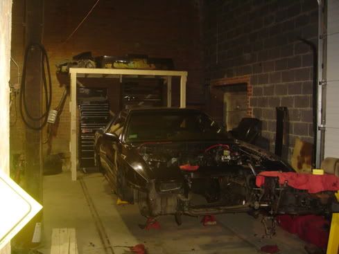

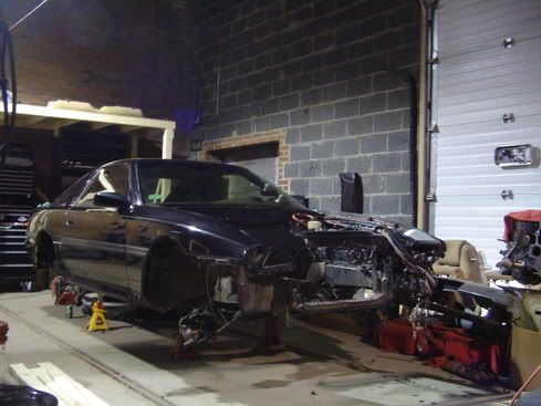

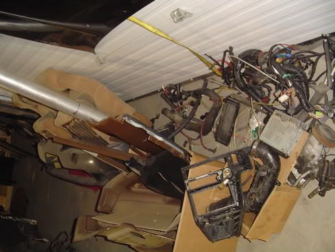

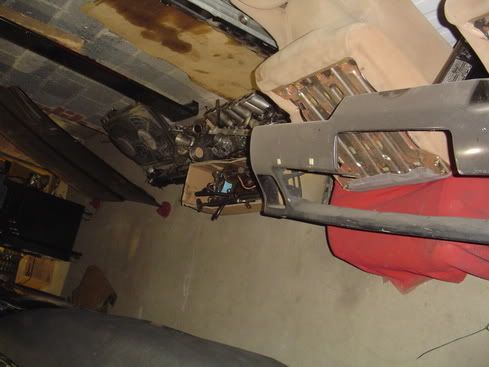

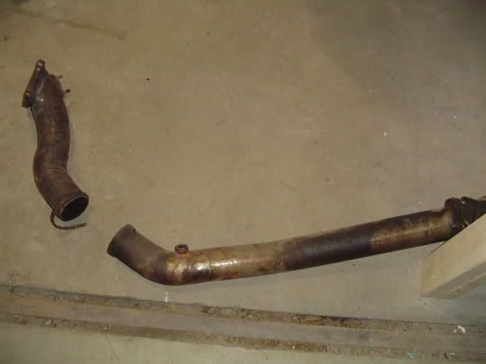

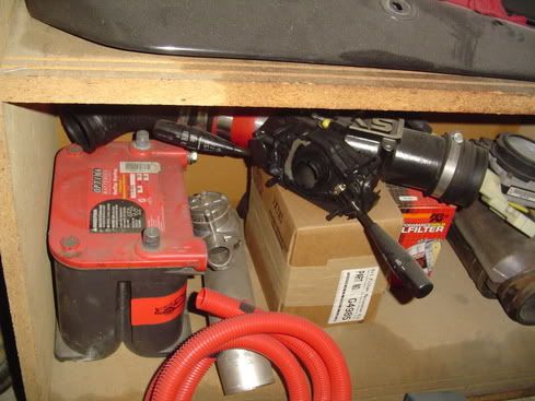

The day at the garage basically entailed a lot of cleaning, organizing, and rearranging. The area surrounding the car is much more free to move around in, all the stuff on the ground in pics #4 and 5 (<<links) are now atop the large staging platform I built behind the car that you can see in pic 2
As of right now, my focus should be gathering up a box of random bracketry and suspension parts to be powdercoated, I still have yet to order any A-1 rear suspension arms, which I would like to get powdercoated also, I need to order one(1) front Bilstein strut, as I damaged one when I jumped a curb. I want to order some remanufactured front calipers and get those powdercoated also.
I want to get the car rolling so I can bring it to the bodyshop and put it on the frame machine. Make sure the chassis is still good, as I hit that curb pretty hard. How hard? Hard enough to bend my brand new Cusco FSTB, yet it fit perfectly in it's bent state... therefore... the chassis is obviously tweaked.
Enough of my tired 3am ranting... I'm sure I'll look at this tomorrow and go "wow... what was I doing?" lol..
