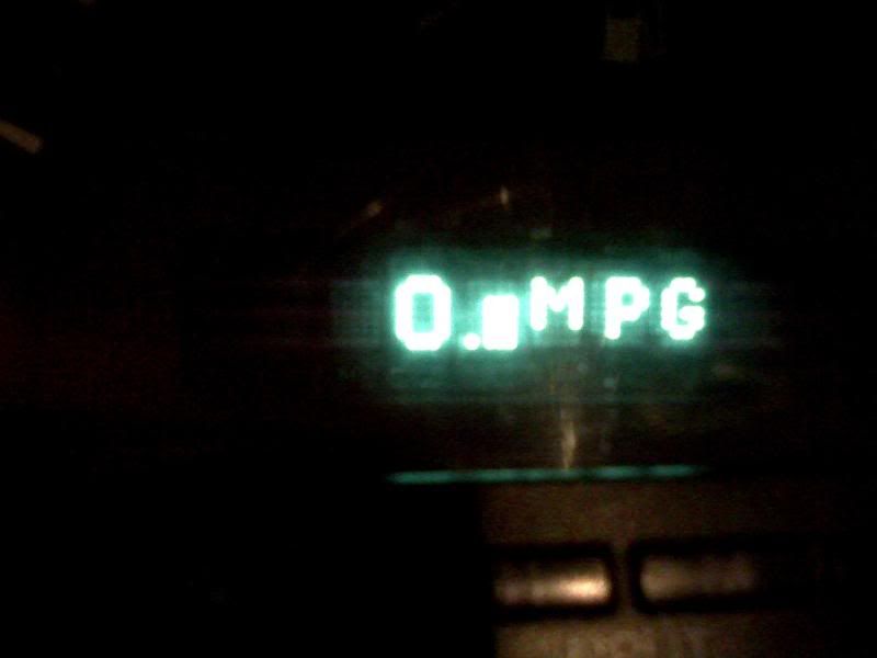

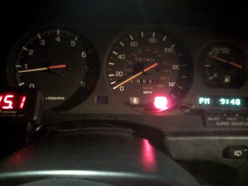

Lol. I just read the sequence for pulling codes off of the supermonitor on the TSRM, it seems like they could have just added a "diagnostics" thing to menu. Nifty little clock though, here are the pics.
