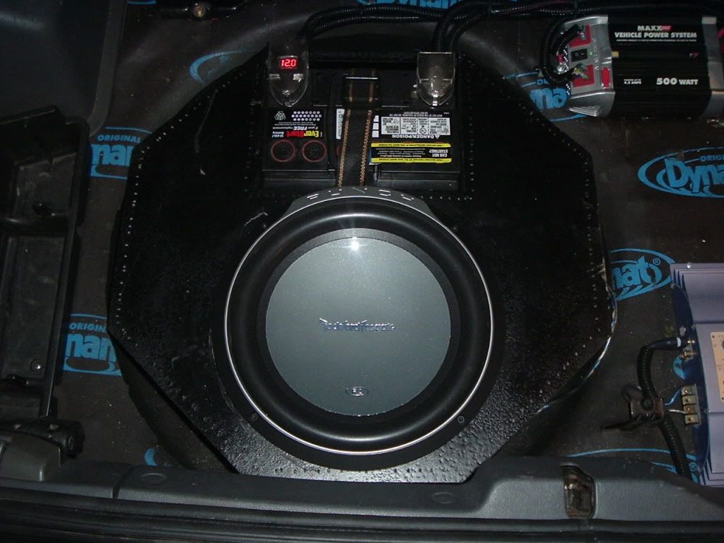

Don't have a Targa but here is my shallow mount, The box could be a bit smaller but it works.

^very cool I've never heard of one of these before, to bad its only 250 watts. The sub is heavy enough that you don't need brackets to hold it down and the carpet on the box keeps it from moving too.
