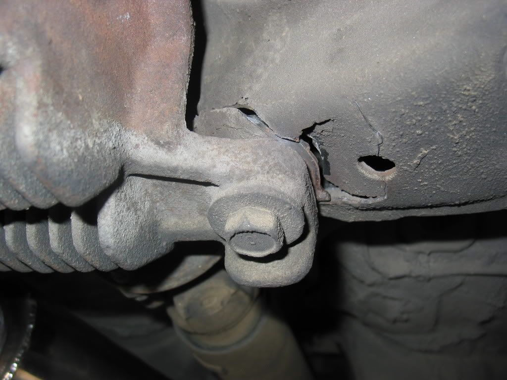

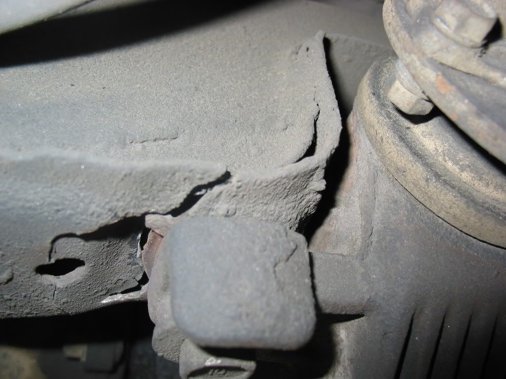

This is what I discovered today, after looking for the cause of the "squeaking" sounds I have been hearing for the last couple of weeks:
Does this look like it was caused by loose mounting bolts? Should I try to tighten the other three bolts to make it last a little bit longer, while I find a replacement?

nope, i'm not saying that @ all. the only diff between the yrs is the addition of the braces on the '89+ ones....and that doesn't even help.
yup, i think the diff being slightly loose is a contributing factor to the beating death of your subframe. yours looks pretty bad, time for a new one...
