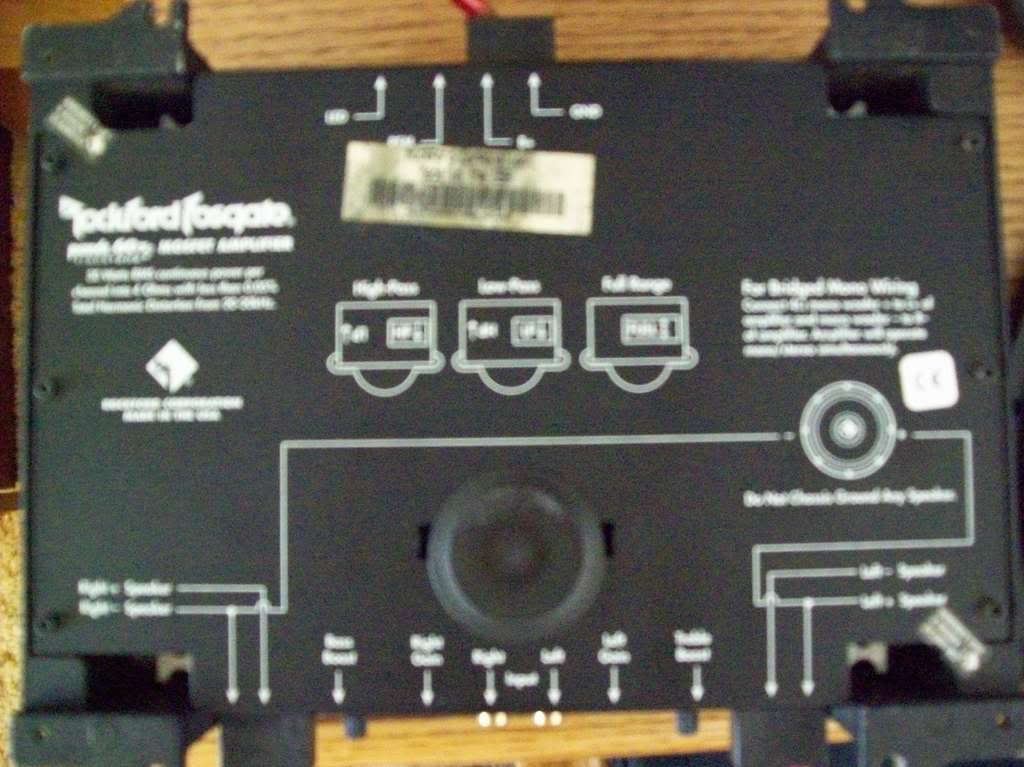

Heres a picture of the amp
on the back it says
Rockford Fosgate punck 60x2 (trans-ana) mosfit amplifier
30 watts RMS continous power per channel into 4 ohms with less than 0.05% total harmonic distortion from 20-20kHz.
For Bridged Mono Wiring
Connect 4ohms mono woofer +to L+ of amplifier and mono woofer -to R- of amplifier. Amplifier will operate mono/stero simultaneously.

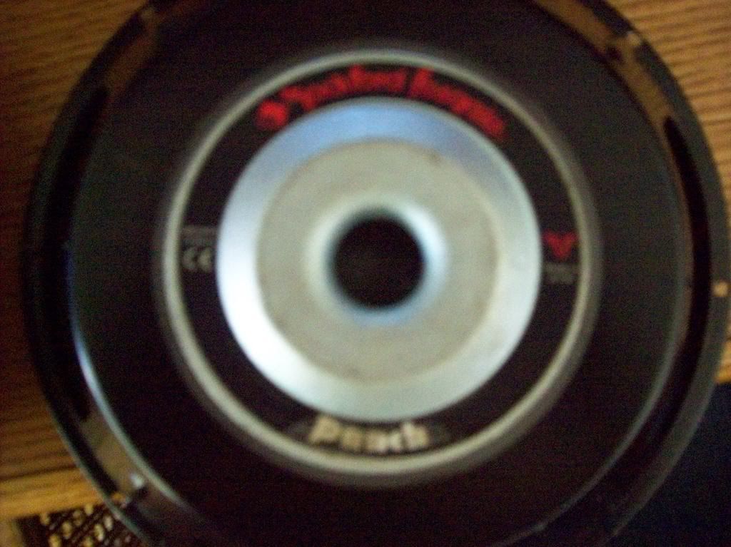

heres a picture of one of the subs
all it really says on the back of the sub is
RFZ1810
8 Ohms
As for model numbers all I have is the numbers on the bar codes if that correct. Amp is 81P286I023882, Sub is 0016283641-02

Ok, do me a favor and take another pic of the amp, but move the camera back about 10 more inches, way too blurry!
