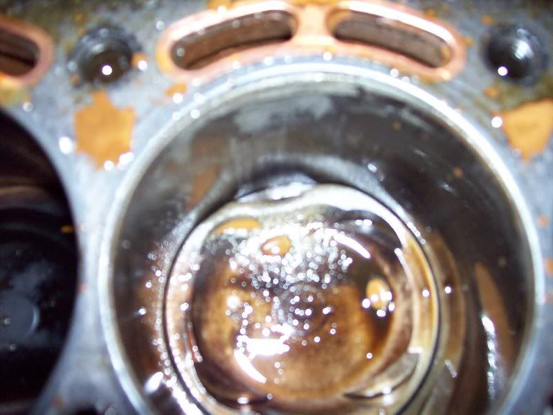

i forgot to take out the lexus afm and put the stocker back in and the next day i took it for a drive and melted 2 pistons.

actually it was running the best it's ran in a long time that day. i adjusted the timing and she idled perfect, sounded healthy accelerating, and built boost quick

That's because of the lean condition it was in, burning every bit of fuel and making the most power possible, the bad part was, too much heat, then the detonation and melted pistons...
