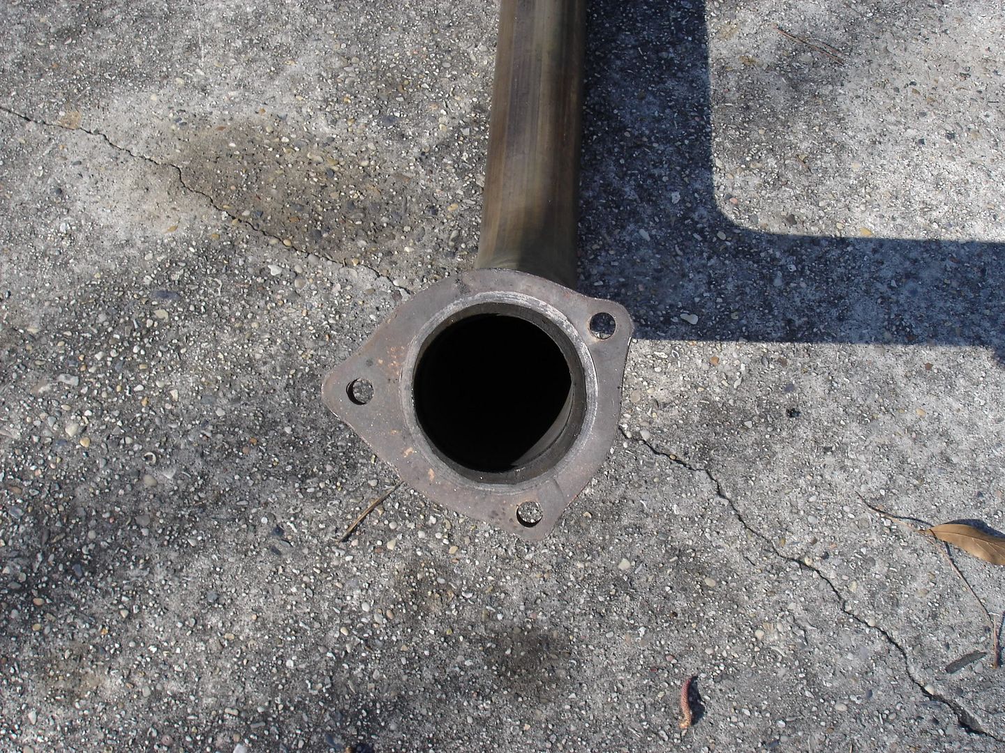

net_recycle_shop-
My downpipe for US twins
The flange/ won't mount up with the aristo twins without doing what tissmo/Justin suggested.
