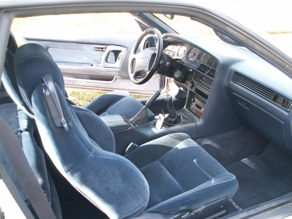

TurboFreak;1021827 said:
I love my stock 1992 headunit...
Hey, that's my car now.:biglaugh:
I was ordering a knob for that radio from Jeff Watson, and he said it's out of a newer MR2. Perfect fit.
