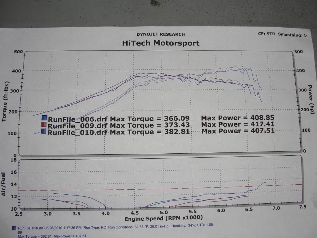

92nsx
Sep 30, 2005
2,957
Clearwater, MN
kamikazemkiii;1627298 said:
Ive heard some holding up to 400ftlbs then some failing at 280. Im curious too
See below ;)
wardog;1627305 said:
A stock cluth will start to fail right around 300 ft/lbs of torque. If it lives past that it wont last too long. .
It will....umm...... Well the proof is in MY oem clutch and MY dyno.
382 ft/tq at the wheels, add in 15% for drive train loss and it puts my stock OEM clutch holding 440 ft/tq at the flywheel. Why.......... I cant tell you but it is holding just fine with no sings of giving up ;)
