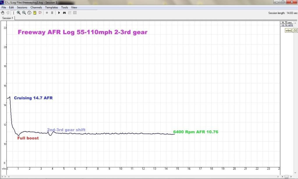

Here is a pull today on the street basically spinning 1st and 2nd after re street tuning it with the new fuel filter in and the SAFC re initialized.. Something went wrong and wasn't giving correction but its fixed now and AFR holds steady in the low to mid 11's at all RPM ranges above 3000 at full boost

I am pretty sure it is the fuel pump resistor causing my lean at high rpm problems.. I checked and the part numbers are different on them comparing a 88 turbo one to a 88 non turbo one.. We will log the AFR tomorrow with the new resistor installed and see how it does. No detonation and AFR's held rock solid at 11.3-11.6
