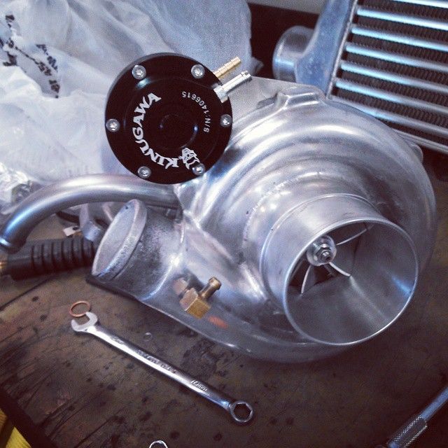

Alec, why not go to an upgraded wastegate actuator that you can adjust the springs in? I did that on my DBB 6776 bolt on ct26 style turbo, and love it. I have 3 or 4 different springs. 7 psi, 11 psi, 18psi, and 22 psi for now. They go all the way up to 28ish psi or something around there, and its a cheap upgrade, and very straight forward. I had it on my turbo and working right fully adjusted within an hour. Here is the actuator kit I picked up.
http://shopping.kinugawaturbo.com/kinugawabilletadjustableturboactuatoruniversalapplication.aspx
And here it is on my turbo.
Obviously there are some advantages to going t4, but a lot of money involved. I like my t4 setup on my other car, but I think the power, response, simpleness, and sleeper factor of the bolt on style turbo is more than enough for me to want to keep one of mine bolt on style. Only reason I would switch is to go to a 6466 on that car, which I had and ended up getting rid of.

Idk if you have talked to SP about upgrading at all either, but talk to Mark and Reid about Marks actuator setup. They ended up doing a turbosmart actuator, which is basically the same thing but a known good brand. Obviously more money, but no where near t4 setup money.
I am happy with my cheap actuator, as it works well without issues, and parts and springs are super cheap. I have a few thousand miles on it now. I wanted to experiment with other options, and i am cheap lol so I figured id give it a shot. worst i am out is $100 and some time.
When i was looking into it I also was thinking about making an actuator off of another car work, but they are sealed, and you cant switch springs, and I wanted low psi for break in and for tuning myself, then throw in the higher springs for power, and so the boost controller can take it up to 30 some psi.
When I had the stock gate on the car it wouldn't run past 18psi, and it wouldn't build much boost off the stall. I throw in a heavier spring on this one and itll keep the gate closed longer for off the line, and you can run basically any amount of boost you want (that a 7m like mine will hold).

The only issue with those gates is that to make more than 26psi, I'd probably need a spring too stiff that I wouldn't be able to also run punp gas.

Hard telling. thats a good thought tho. I only run e85, so I am not concerned about it. Only time my car will see pump is in an emergency, or during the winter for storage, and Ill stay out of it if that happens.
I don't see an issue making 30ish psi off of a 14psi spring, and that would be fine with pump too I would think. might be able to even run the 18psi spring and be fine with it, but that may be pushing it a hair.

I just emailed turbosmart this week asking about their IWGs haha, they have dual ports which will absolutely help all around...you can have a low psi spring in it but also run high boost because of the second/lower port. Only issue is they only have straight clevis arms and the stock CT26 is bent so something would have to be customized.
